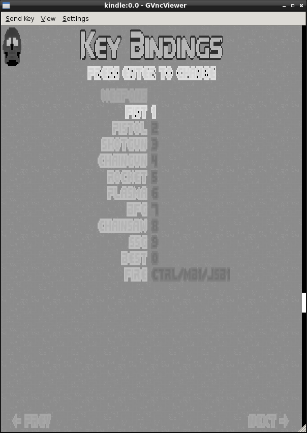

Old 10-17-2012, 12:38 PM   #187
twobob
( ͡° ͜ʖ ͡°){ʇlnɐɟ ƃǝs}Týr
twobob's Avatar
Posts: 6,586
Karma: 6299993
Join Date: Jun 2012

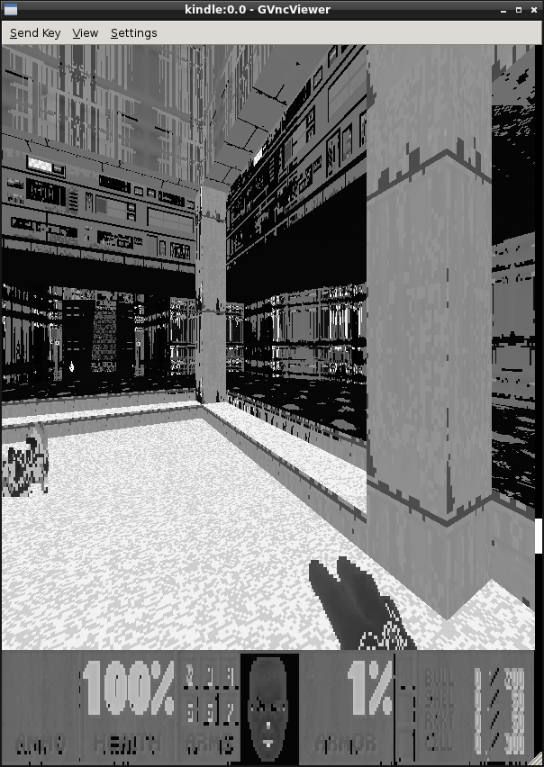

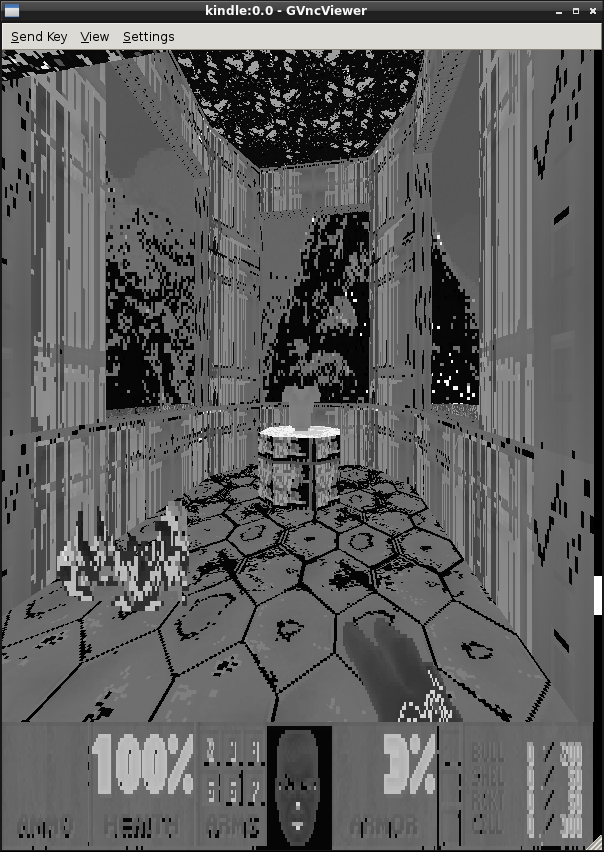

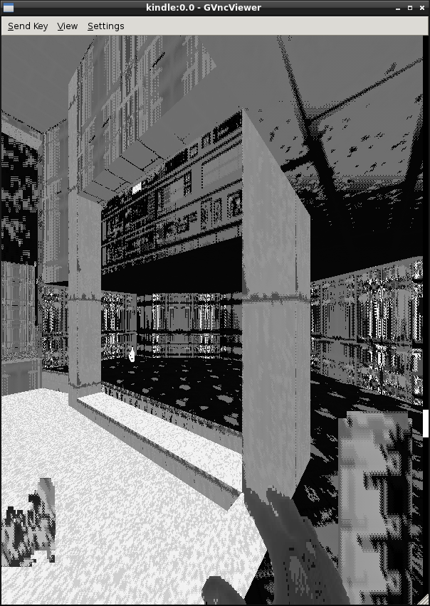

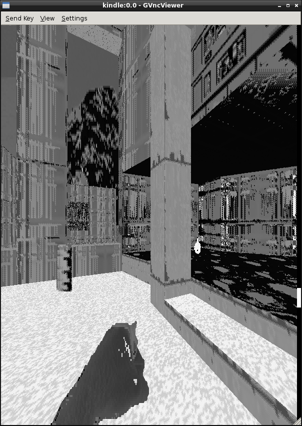

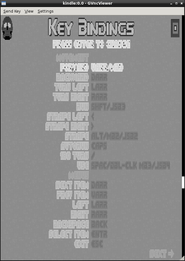

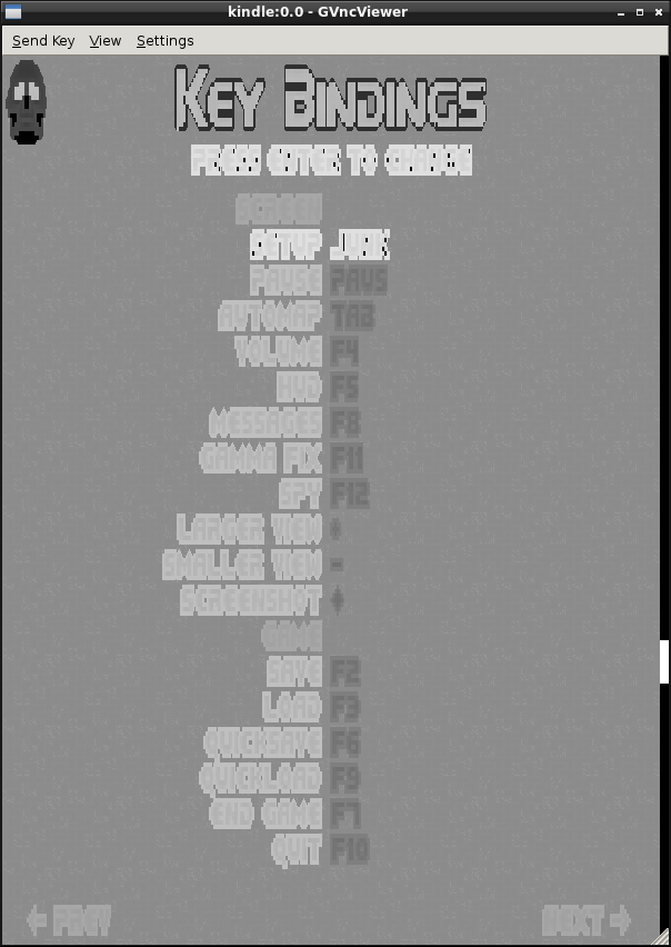

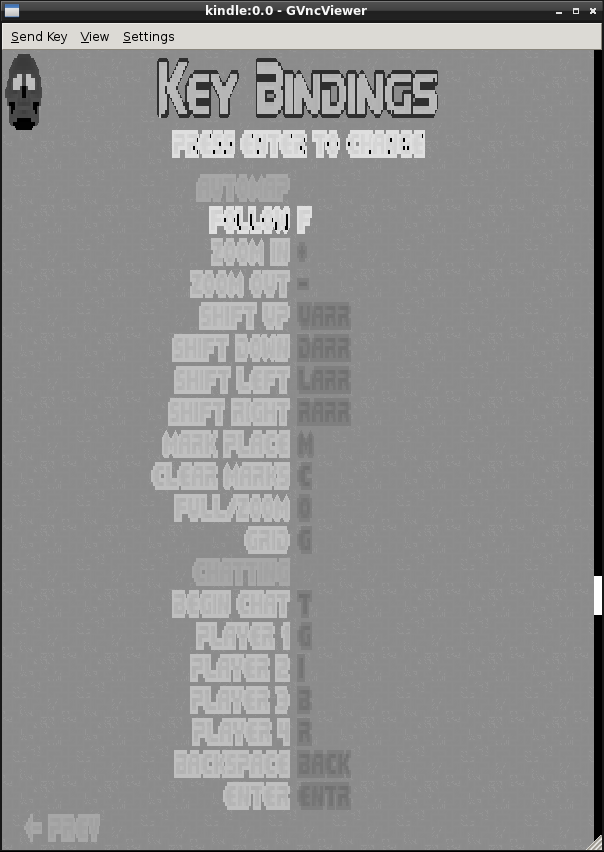

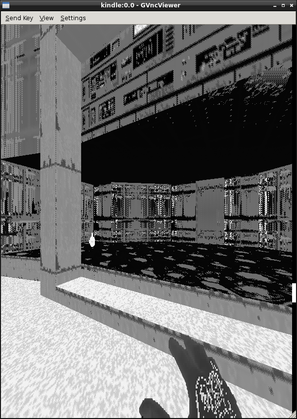

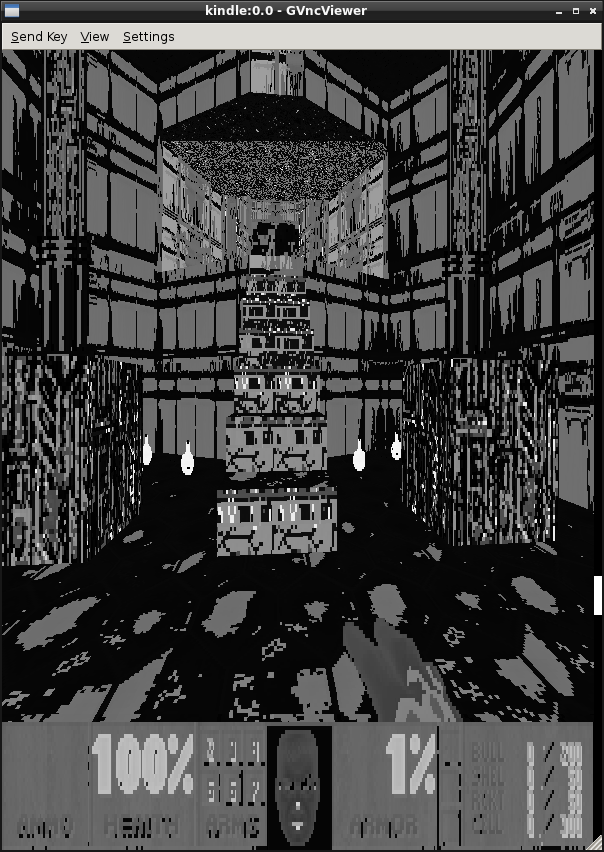

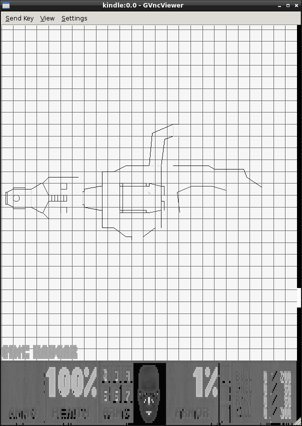

Done deal.
Sound, Touchscreen, Control of Xorg, running Doom.
I just played my first game on the kindle touch
next up... Kindle 3 support
Not finished: Graphics. Initialising keyboard (currently feeding via vnc) via other method.
Nearly ready to release. TSLIB works really nice.
Name:	kindle:0.0 - GVncViewer_173.png
ID:	94287   Click image for larger version

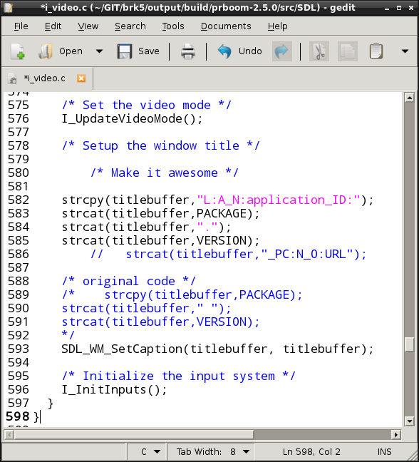

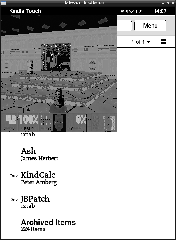

setting a "proper" title
Code that sets the "correct" window name:
~/GIT/brk5/output/build/prboom-2.5.0/src/SDL/i_video.c
/* Make it awesome */
strcpy(titlebuffer,"L:A_N:application_ID:");
strcat(titlebuffer,PACKAGE);
strcat(titlebuffer,".");
strcat(titlebuffer,VERSION);
.... Snipped

hmm. I think I should be able to attempt the -dithered for prboom later.
not got the right bits with me.
get an idea of what it might look like at least.
on the 3 mind for now
[root@kindle share]# LD_PRELOAD=/mnt/us/usr/lib/libz.so.1 Xvfb -noreset -screen 0 600x800x8 -bs -wr +extension RANDR +extension XTEST +extension XINERAMA +extension MIT-SHM -fc cursor -fp /mnt/us/sh/fonts/X11/100dpi -nolisten tcp :0 &
(DEBIAN: ) Xephyr :1 -title "dithyr" -screen 600x800 &
[root@kindle us]# DISPLAY=:0 x11vnc -shared -nopw -forever -noncache -noxdamage &
[root@kindle us]# /mnt/us/kindlevncviewer/kindlevncviewer -config /mnt/us/kindlevncviewer/config.lua -encodings "raw copyrect" -dithered 127.0.0.1:0
(DEBIAN: ) DISPLAY=:0 /usr/games/prboom -width 592 -height 800 -nomonsters -nosound -nomusic -iwad /usr/share/games/doom/freedoom.wad -file /usr/share/games/doom/prboom.wad
Seemingly I can target an Xvfb target with debian SDL. huh, neat trick
