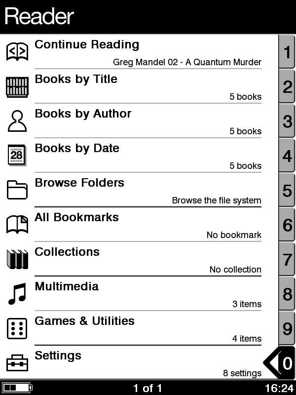

Could anyone post screenshot of the home menu in 1.1.3 please? I need it to "return" multimedia menu.

Here ya go

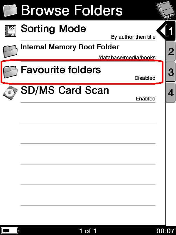

Can anyone explain me which is the funcionality of "favorite folders" in menú of "browse Folders"?
I have the PRS-505 with PRS+ 2.0.10alpha installed.
Name:	Browse Folders.jpg
