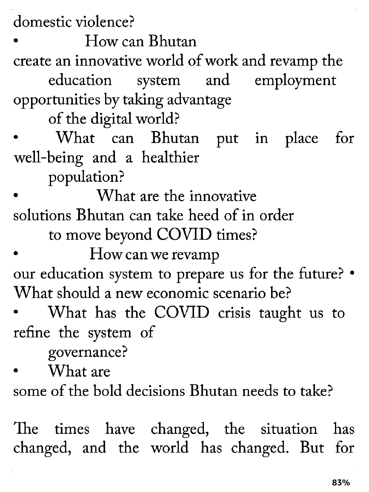

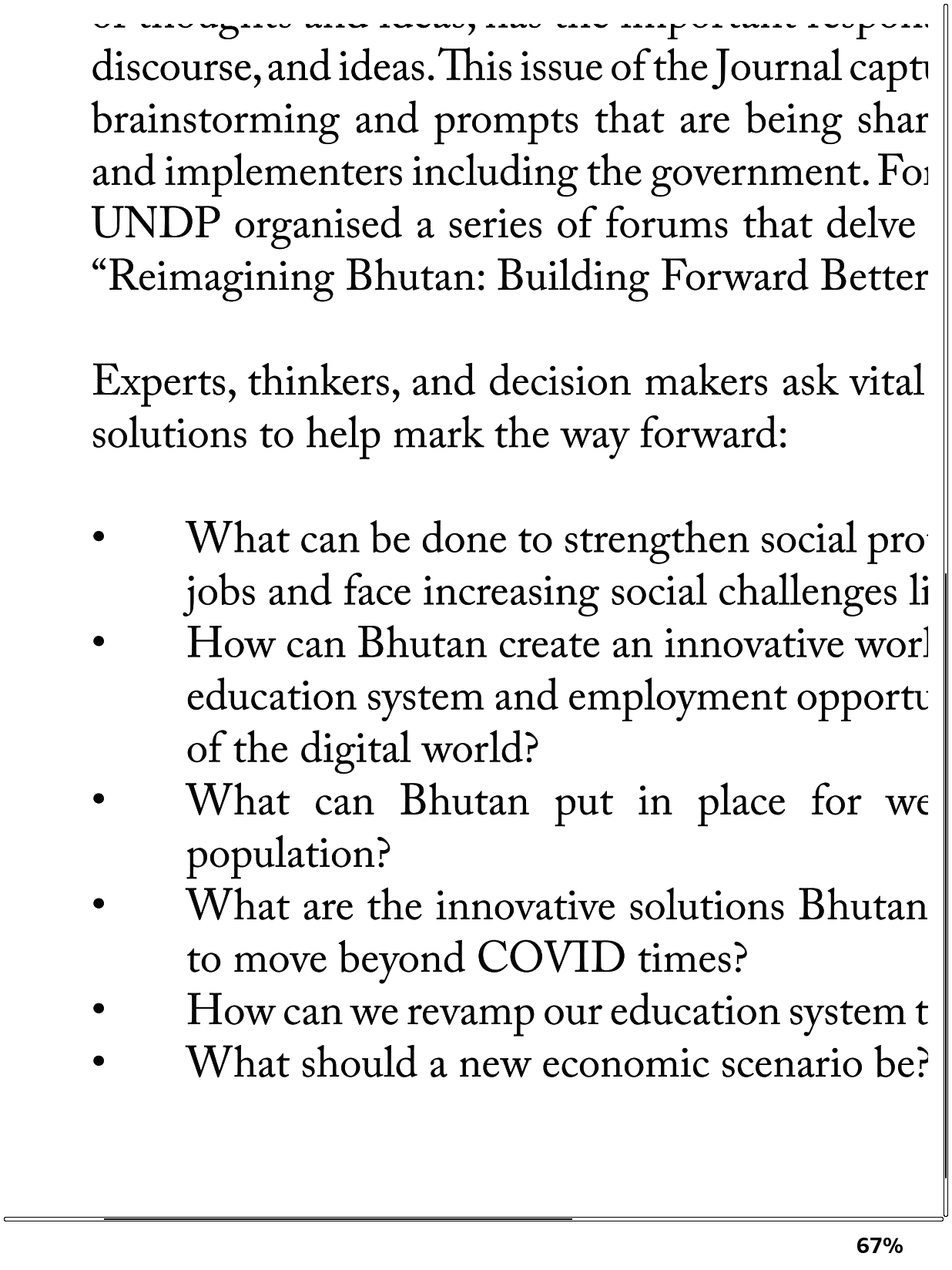

Jagged text
Hi everyone
The device I'm using is a Kindle Paperwhite 5 (2021). The output I'm getting from k2pdfopt is bettter for reading on the PW except that when compared to the original, the text rendered is very "jagged"? For comparison, please see the screenshots attached.
I've tried different permutations of the command line options but could not improve the rendering on the PW.
./k2pdfopt Editorial.pdf -ui- -x -mt 0.8 -mb 0.5 -fc- -mc -odpi 300
Version used:
k2pdfopt v2.53 (w/MuPDF,DjVuLibre,OCR) (c) 2020, GPLv3, http://willus.com
Compiled Jul 18 2020 with Gnu C v8.2.0 for OS/X on x64.
The source pdf is here at http://drukjournal.bt/wp-content/upl.../Editorial.pdf
There is also a minor problem with the bullet items but I can live with it.
Suggestions on how to improve the text will be really appreciated.

Originally Posted by modified View Post
The device I'm using is a Kindle Paperwhite 5 (2021). The output I'm getting from k2pdfopt is bettter for reading on the PW except that when compared to the original, the text rendered is very "jagged"? For comparison, please see the screenshots attached...
Based on your posted screenshot of the Kindle Paperwhite 5, which shows the visible part of the PDF to be 1174 x 1554 pixels, it looks like the Paperwhite 5 is using the same display size/resolution as the Kindle Oasis 2, so you should use -dev ko2 (Kindle Oasis 2) for your screen, and also drop the "-odpi 300":
./k2pdfopt Editorial.pdf -ui- -x -mt 0.8 -mb 0.5 -fc- -mc -dev ko2
If you still aren't happy with that you can try adding -dr <xx> where <xx> is some number above 1.0 to increase the resolution of the bitmap in the output PDF even further, e.g. for a factor of 2 higher resolution:
./k2pdfopt Editorial.pdf -ui- -x -mt 0.8 -mb 0.5 -fc- -mc -dev ko2 -dr 2
