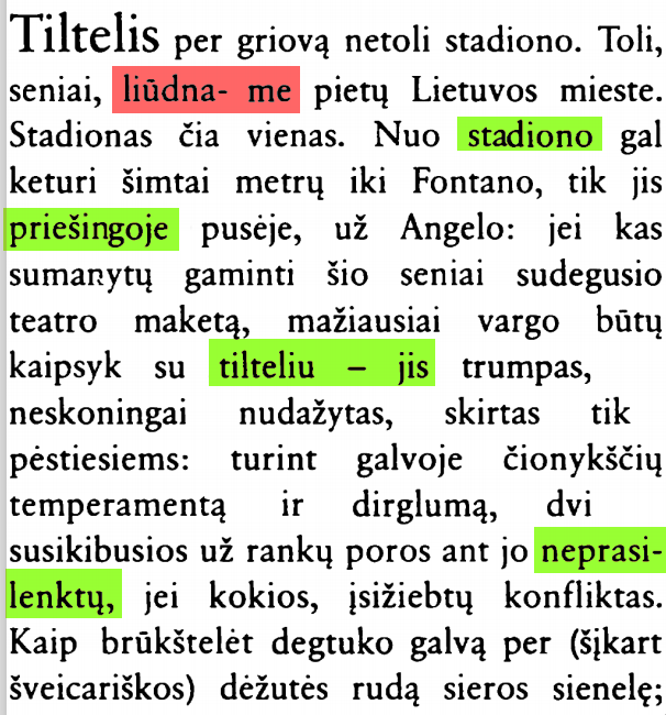

Post Word breaks: hyphens and dashes
Hello,
Is there any possible way to remove hyphen when in the original pdf we have a line ending with a word and hyphen (without a space between them):
This is an original example where we do not need to pre-
serve the hyphen in the word "preserve" if it is not broken
in two lines in the output file. The algorithm/rule is simple.
If we have any character (not a space) preceding the hyphen,
it means we have a word break between the lines.
And in opposite - this is an original example where we need
to keep the dash in the destination file.
If the line ended with a word and dash like this -
that would mean we still need to preserve this dash in the
destination (since there is a space preceding the dash)
Not sure if that's possible at all, could not find any set of parameters
that would work like this...
Thank you very much.
Using KPW2, if that matters...

Originally Posted by stillstill View Post
Hello,
Attaching the screenshots - original and converted, problematic place is red marked.
ID:	188702   Click image for larger version

Originally Posted by willus View Post
I converted your bitmap to a pdf at 150 dpi and then processed it with k2pdfopt using the default parameters. It eliminated 3 of the 4 hyphens. See attached.
Attaching original and output. 3 hyphens have not been removed in the first page of the output. Converted using the following options:
-dev kp2 -fs 12 -o C:\Users\demo\Downloads\%b_k2opt -nt -80 -ocrlang lit -ocr t -as -p 7 -cbox- -ibox- -cbox 0.3066in,0.1775in,4.147in,6.423in
additional options:
-f2p -1 -bp-- -fc-
Any ideas how to improve the hyphens detection?...
Thank you
stillstill is offline   Reply With Quote
Improving hyphen detection for this case would require a code modification. I'll make a note of it and maybe add an extra command-line option to tweak hyphen detection in the future. These hyphens are a bit "stubby" and also tilted somewhat, which is odd.
Zoomed in, and, indeed - they are tilted a bit. IMHO the easiest logic would be just if we have any dash-like symbol at the end of line, that is not preceded with space it should be interpreted as a hyphen. And I believe the hardest part is to detect that dash-like symbol, especially if we have slightly different types of it (like slight tilting, symbol width, line width...) due to variety of fonts used.
Anyway I really do appreciate your talent and hard work on this truly ingenious tool helping millions mobile readers.
Zoomed in, and, indeed - they are tilted a bit. IMHO the easiest logic would be just if we have any dash-like symbol at the end of line, that is not preceded with space it should be interpreted as a hyphen. ...
FYI the current detection algorithm is looking at the graphic, not the characters. It is looking for the "shape" of a hyphen. Thanks for the nice comments--I'm not sure k2pdfopt is helping millions, though--the download count is at 700k. Not that I'm complaining.
