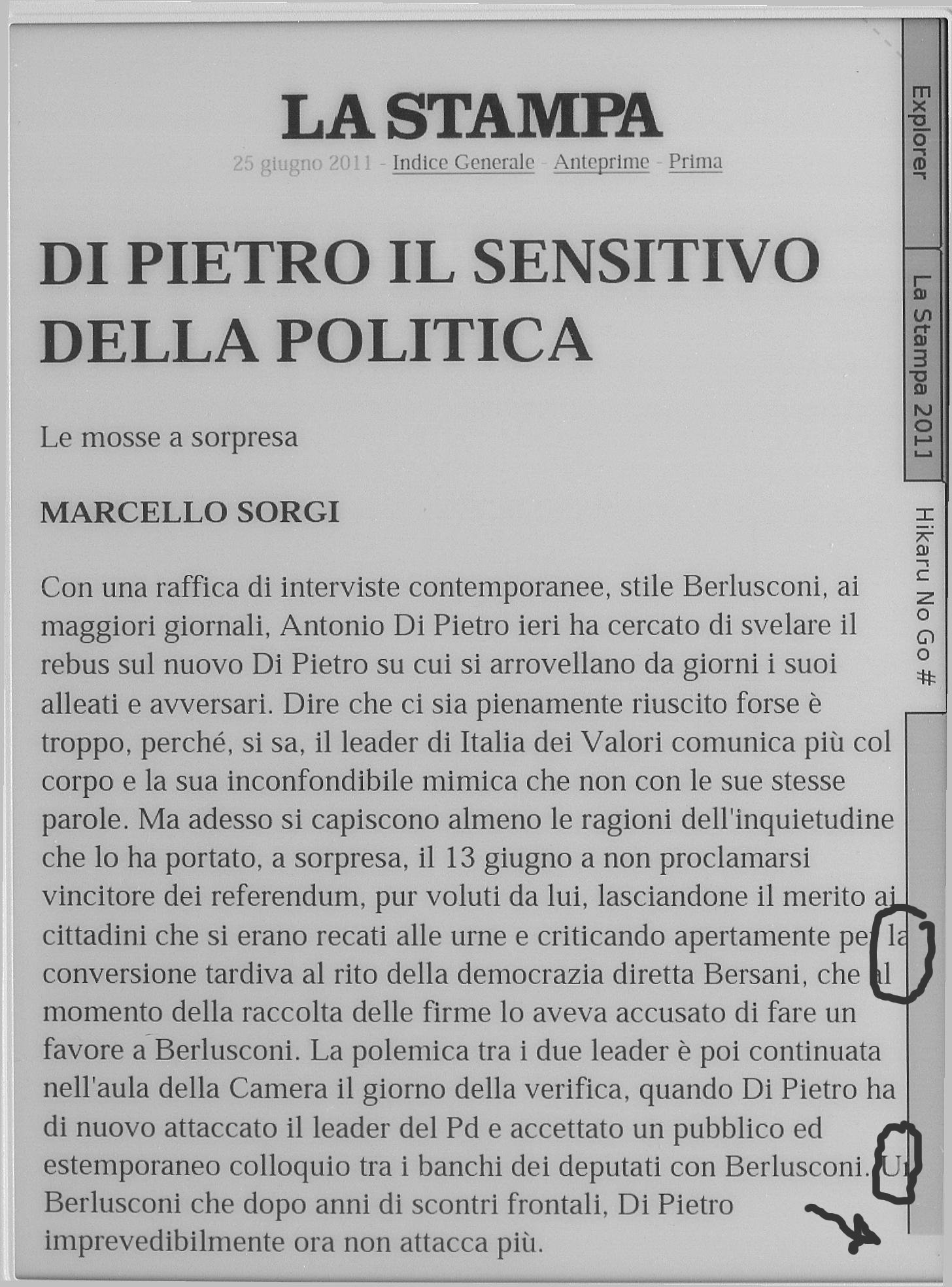

There are some problems with the display of the taskbar.
Setting the full-screen vision and then making it appear the taskbar, missing the lower part. Also, the content exceeds the page size occluded resulting from the taskbar. This type of setting is not stored and often causes the closing of the document.
Translate with google.
Thanks for the report.
What type of document are you reading? a .pdf? other?
ePub of a italian newspaper on default reader.
Showing taskbar does mean that you exit fullscreen mode so it's completely normal that bottom statusbar is not shown.
Issue: uds in fullscreen mode, then show tasbkar -> some text is cut while window remains fullscreen
Reported by joepsichip
Steps to reproduce:
1. taskbar hidden
2. pdf or epub fullscreen
3. show taskbar
Results:
- text at right is cut
Comments:
Perhaps we shouldn't make taskbar appear in front when there is an app in fullscreen.
So it will be hidden at the bottom but visible when exiting fullscreen or visiting desktop.
Iņigo

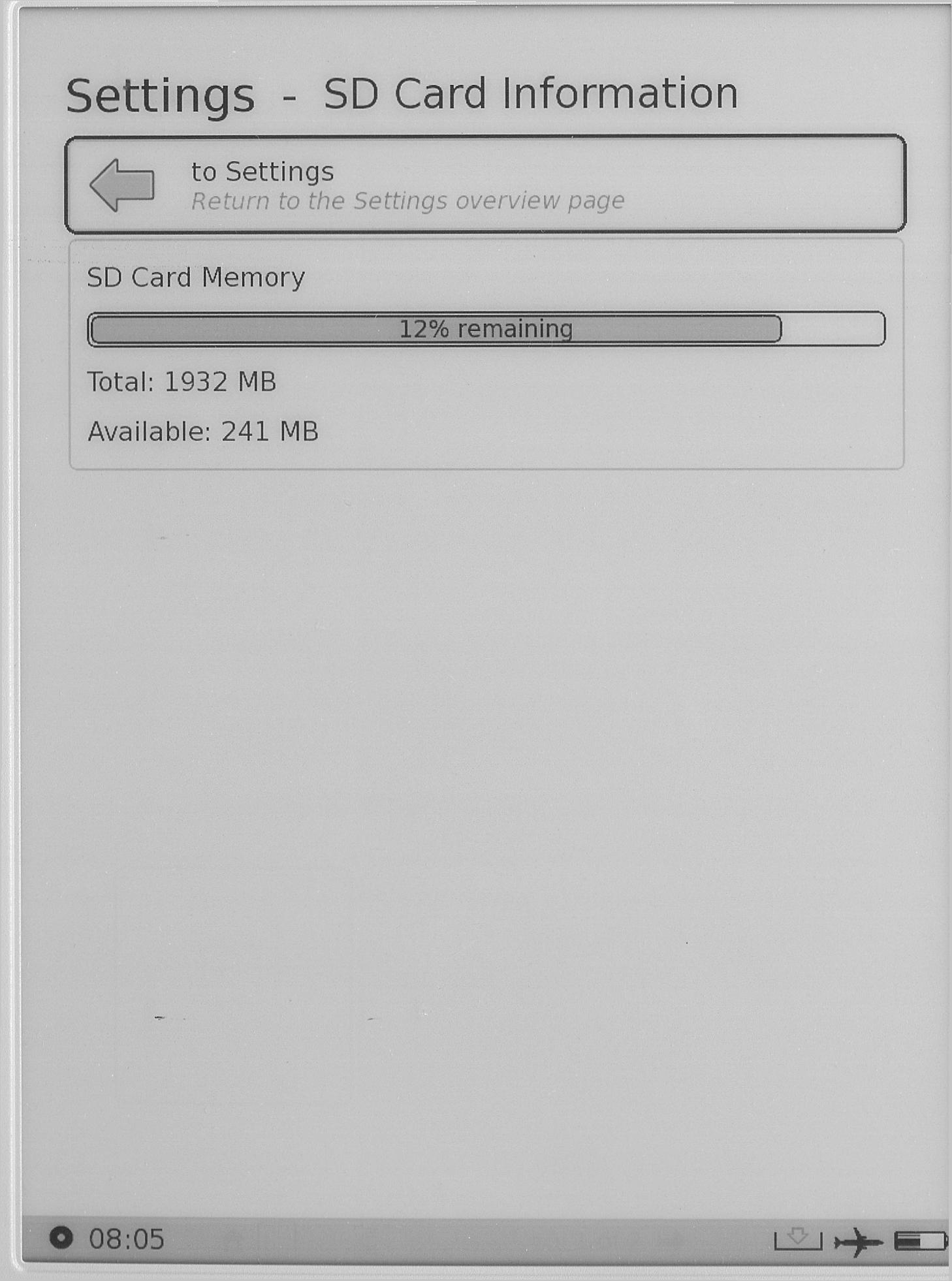

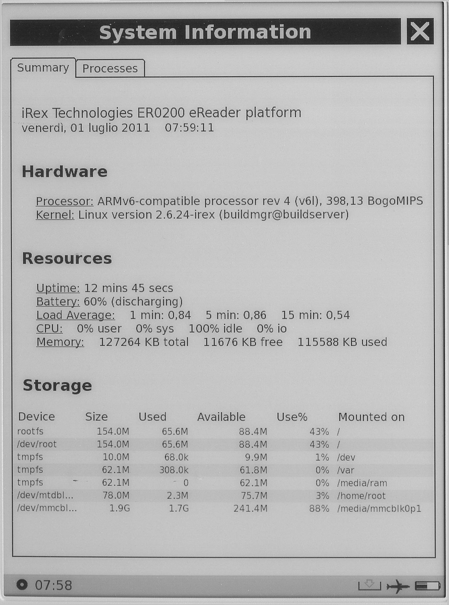

The free memory displayed by the System Information does not match the one shown in SD Card Information.
The device is going often on freeze with a pdf document in which I am entering numerous bookmarks and annotations.
But it does. The SD card is the last storage location (/media/mmcblk0p1) and has 241MB (12%) free.
Sorry, I've been away some days due to work reasons.
Gertjan has already answered the first issue.
Regarding the second one, I'm afraid we can't solve it as pdf viewer program, UDS, is not public so we can't look at how or what it does, sorry.

Thanks, Gertjan.
I will try to increase the free space by deleting some files.
