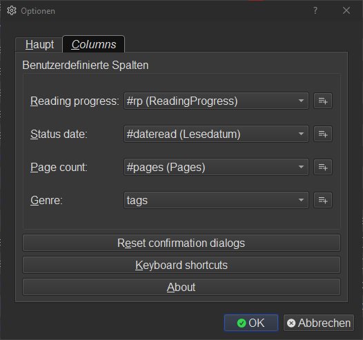

Originally Posted by thiago.eec View Post
Yes, you will need a reading progress column. I could not eliminate this. The plugin was designed to use this column from the beginning, so it would be really hard to change this behavior.
Sorry, I missed your post.
Can the reading progress column be built from other columns?
If #read=yes then #rp=100%?
If so, would you have the code for me, please?
Try this. It should return '100' for true, and '0' otherwise.
program:
	switch_if(
		check_yes_no($#read, 0, 0, 1), '100',
		'0'
I don't know if the plugin can detect changes to composite columns, though.
That I can do. I'll change the code to accept composite columns.
Not right now, but that is easy to change.
I tested here and I had to change the field part:
program:
	switch_if(
		check_yes_no('#read', 0, 0, 1), '100',
		'0'
thiago.eec is offline   Reply With Quote

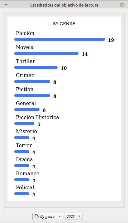

That looks like a glitch on linux webview. Unfortunately I don't have access to a linux machine to test this. Did you teste it on another linux distro?
Also, you could try running in debug mode and post the log, to see if we get any more info.
Something strange is happening...
I took advantage of the last two updates and look, the bars do not appear in the option by month, but they do appear in the option by gender genre.

Old 09-10-2023, 08:34 PM   #174
thiago.eec
Posts: 1,321
Karma: 1436993
Join Date: Dec 2016
Location: Goiânia - Brazil
I took advantage of the last two updates and look, the bars do not appear in the option by month, but they do appear in the option by gender.
Could you send me a debug log when trying to first open the Statistics dialog?

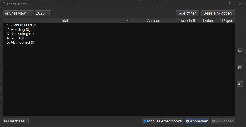

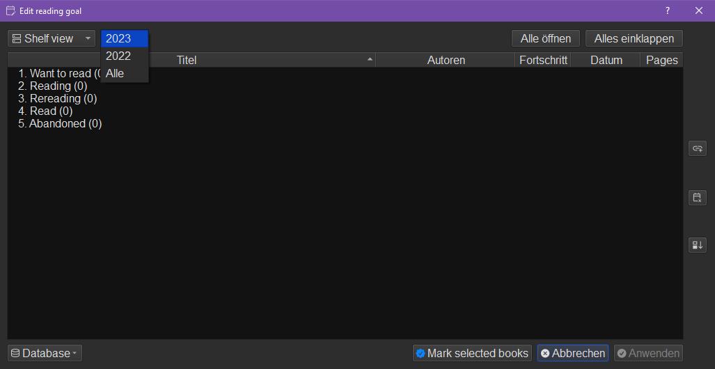

hmmm...am I doing something wrong?
Neither with my composite column nor with a newly created one from the options do books appear in the reading goals.
select book in book list --> add to reading goal --> four digits year --> edit reading goal = empty, but year 2023 is visible
If I add a book read in 2022 reading goal is still empty but 2022 is visible too.
Additionally if I try to add a custom challenge I get this error
I'm going to need some more info to help you.
Please follow these steps...
Scratch that. Just found the bug.
I've done a refactor for this last release and ended up breaking the 'Allow other years' option, when the database is completely empty.
