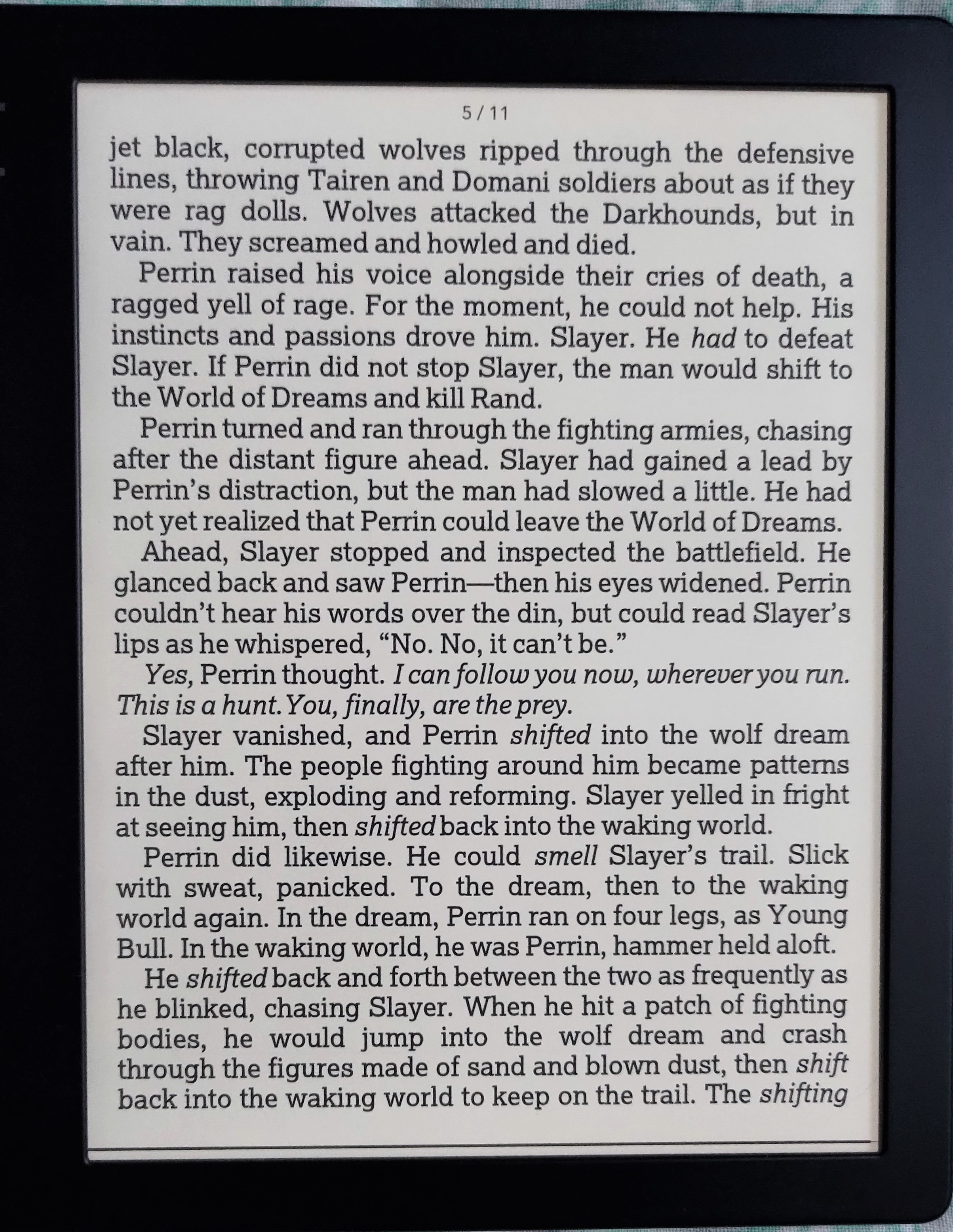

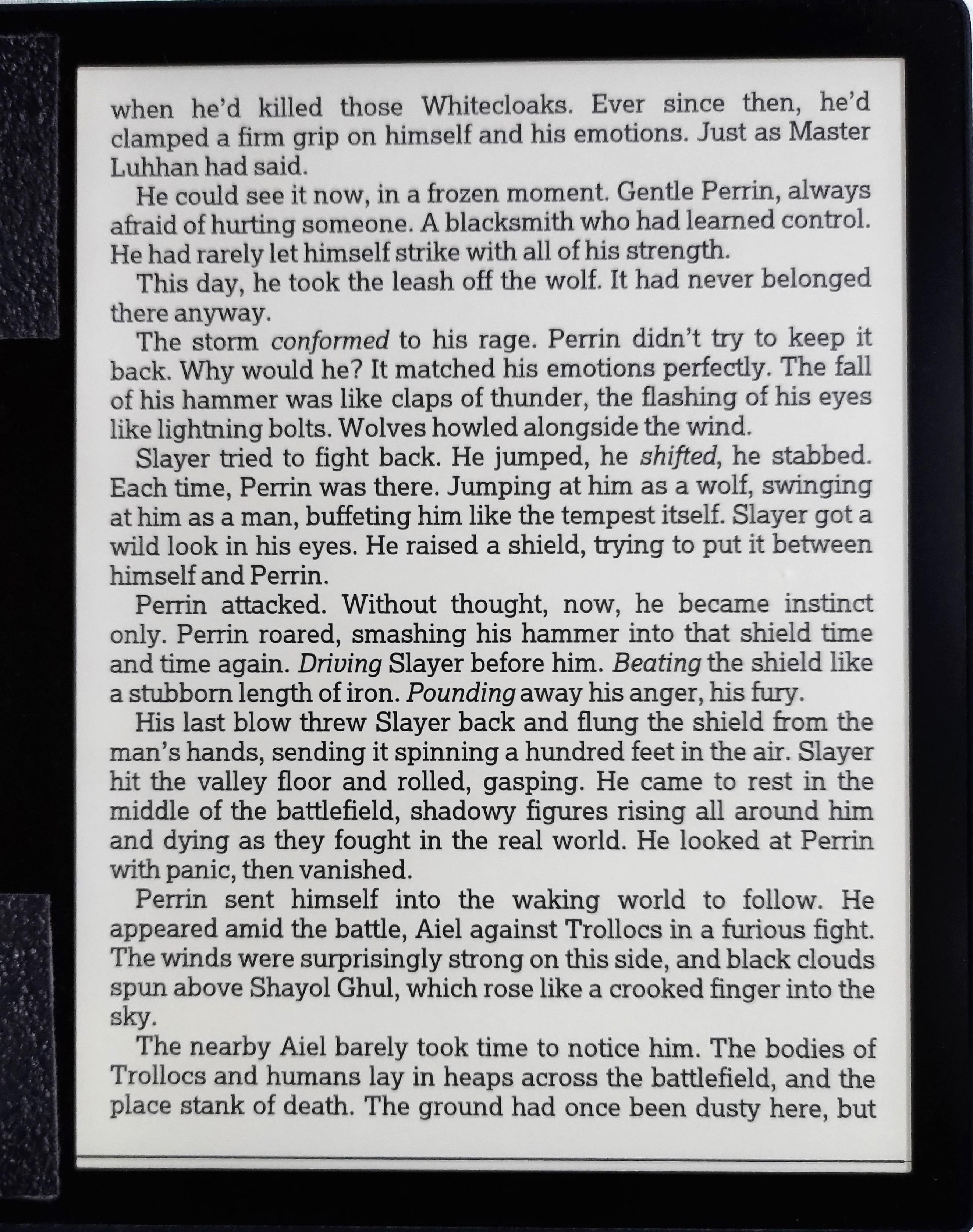

I made it smaller than default on both my Sage and Libra (-0.06em and -0.07em respectively). But then I don't hyphenate and kerning/ligatures are disabled.
I'm going to try smaller. Would you mind posting either screen caps or photos from both Kobos so I can see which I want to try. Thanks.
Photos as requested.
