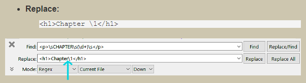

@Ashjuk:
  1. Please add space to tutorial-find-regex-chapter.png screenshot to comply with the content.
  2. Can you repeat the spellcheck-context-suggestion.png screenshot so that the context menu displays a little lower and the misspelled word "wrd" is better visible?
  3. All individual icons are 33x33px except one which seems huge (compared to the others): insert-image.png
  4. Not updated images:
