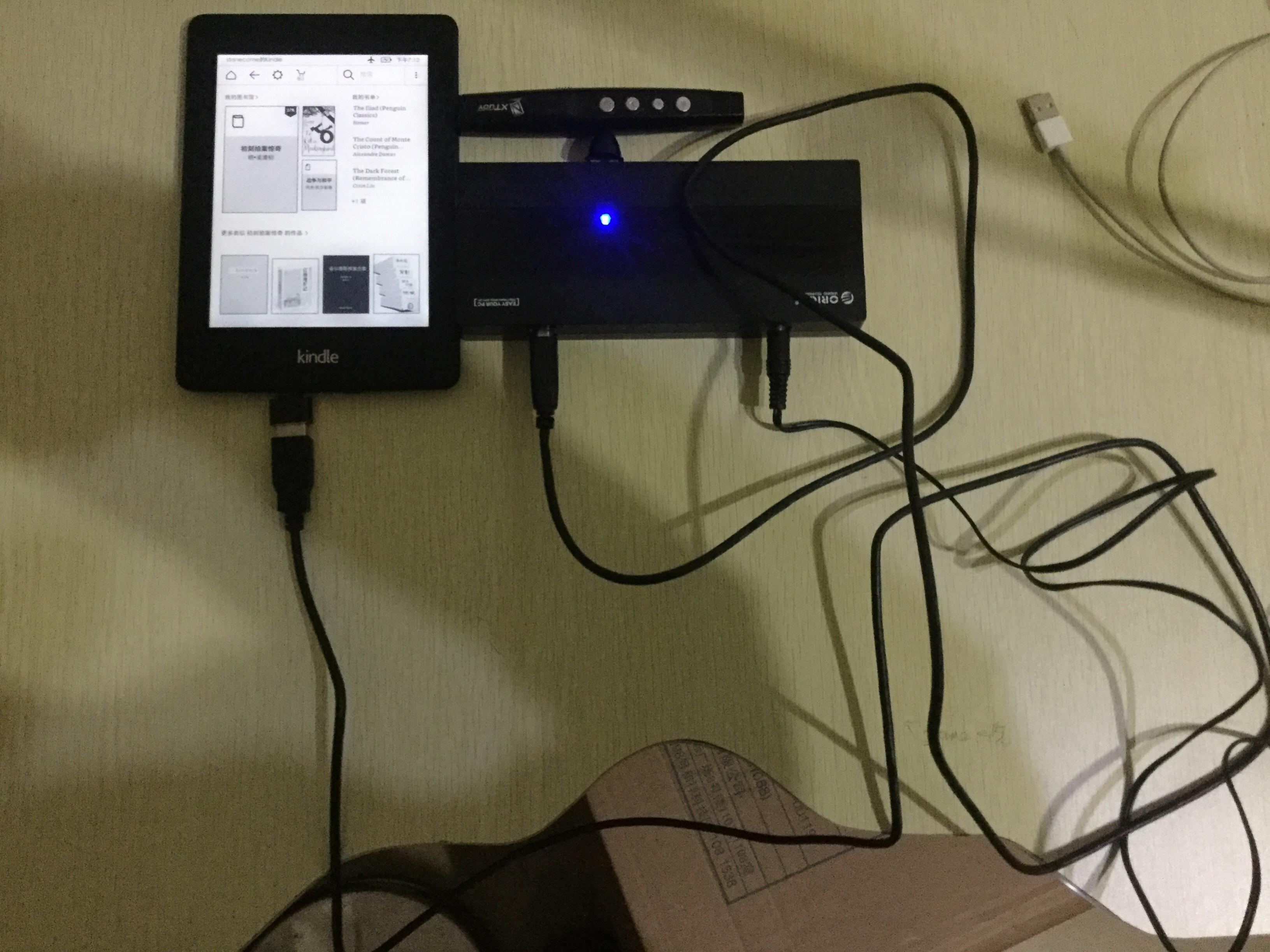

Thanks for writing this program. It also working in my paperwhite2, but it needs some configuration. I guess the mini usb port doesn't have enough power to push for any usb device, so when I plug my presenter directly to my kindle pw2, no response. Same problem occured when I used my little raspberry Pi. So I take my usb hub out, and connect kindle to one side, receiver to another side. Bang. It works perfct!

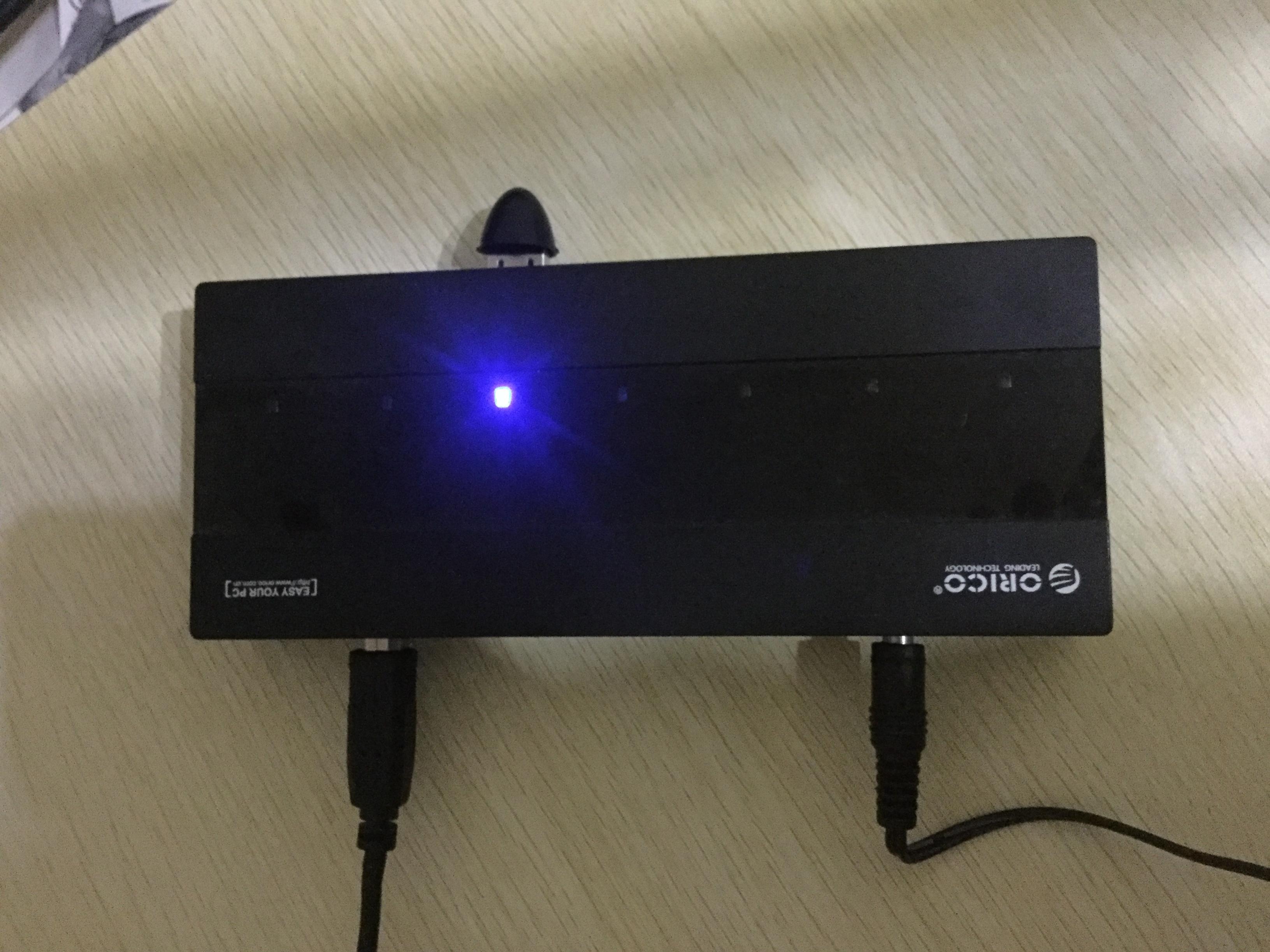

Sure. my kindle PW2 firmware version is 5.8.8(3144280022),KUAL version is 2.7, kindle lazy version is 0.9. You can download the pictures I have uploaded. Connect kindle to one side, presenter receiver to the other. And the most import thing you should do: PRESS THE POWER BUTTOM TO RESTART YOUR KINDLE. As the programmer said, kindlelazy do not support hot plug in, so you should restart your kindle to reconfigure the device.
