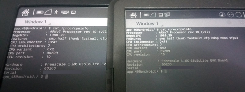

Most probably, the M96 does not have 3d acceleration, OpenGL. Try using the "Terminal Emulator" (jackpal.androidterm), and type the command `cat /proc/cpuinfo`.
On the M96 you will probably read "... Freescale i.MX 6SoloLite EVK Board". This is what you find in (I verified) the T68, i86 and MaxCarta.
On the C67ML you will read a different CPU/hardware, something that supports 3d. If you could divulge what you will find there...
Originally Posted by eReader fan View Post
Mdp. do you have a i86 carta+ right? It would be interesting to know if there is any problem running there
The i86 uses a i.MX6SoloLite: it does not have 3d acceleration, so NX and TeamViewer will not work on it.

`cat /proc/cpuinfo` on a T68 and a MaxCarta: both are
