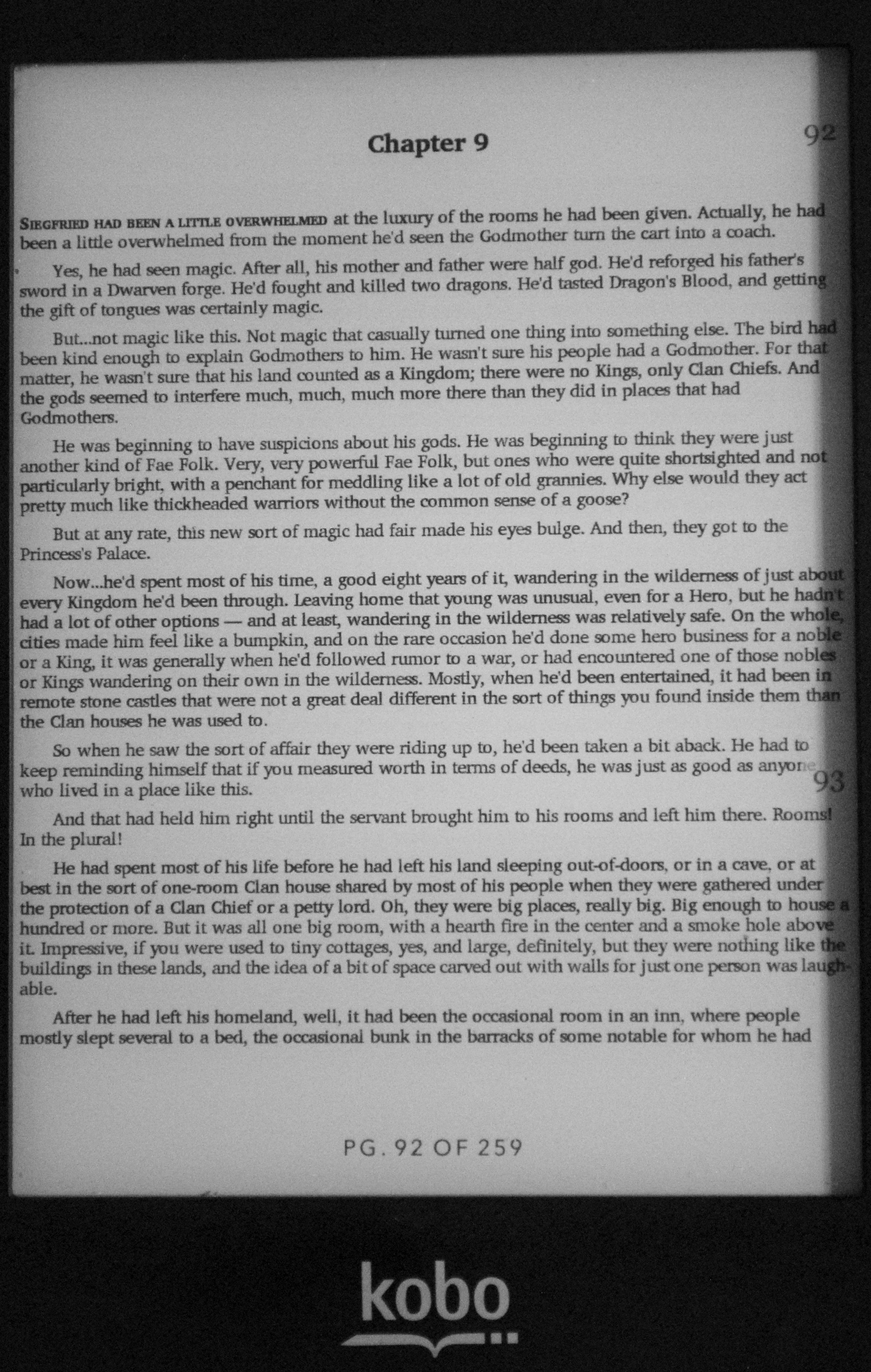

Originally Posted by buffaloseven View Post
Also, I never noticed this before, perhaps it's always like this, but if page numbers in margins is enabled, it messes up text...
Attachment 97996
I don't really understand the function of this side-margin page number. It seems to only be for epubs... but, the page numbers the Kobo puts at the bottom of the page seem to work the same way... For me at least, the side margin and bottom margin page numbers are always the same...
