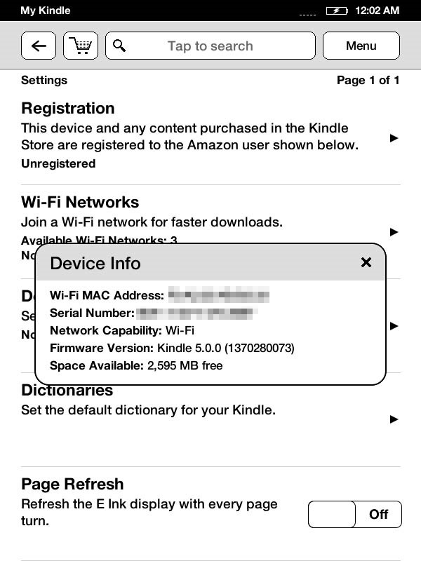

non_fox is offline   Reply With Quote
Old 04-20-2012, 11:32 AM   #178
geekmaster
Carpe diem, c'est la vie.
geekmaster's Avatar
Posts: 6,433
Karma: 10773670
Location: Multiverse 6627A
Device: K1 to PW3
Originally Posted by non_fox View Post
Thank you.
I do not understand. Is it working now?
