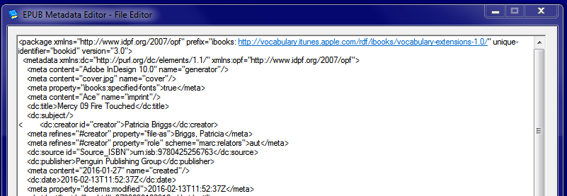

I can clearly see what's causing Sigil to give the error message. In EPUB Metadata Editor, if you open the "Batch Operations / Advanced Tasks" panel and click the "Edit .opf file" button, you'll see an unnecessary "<" character (image attached). Just delete it, click the Save button, and then Save in the main window of the program, and you should be able to view the epub in Sigil successfully.
Now, as to tracking down what's causing that character to appear in the first place, that's harder (unless this happens to you all the time!) You will need to monitor when it happens so that you can send me the original version of the EPUB (before any changes are made) and then tell me what to do to make the problem happen. Does that make sense? Then I can dive into debugging and track down the root cause.

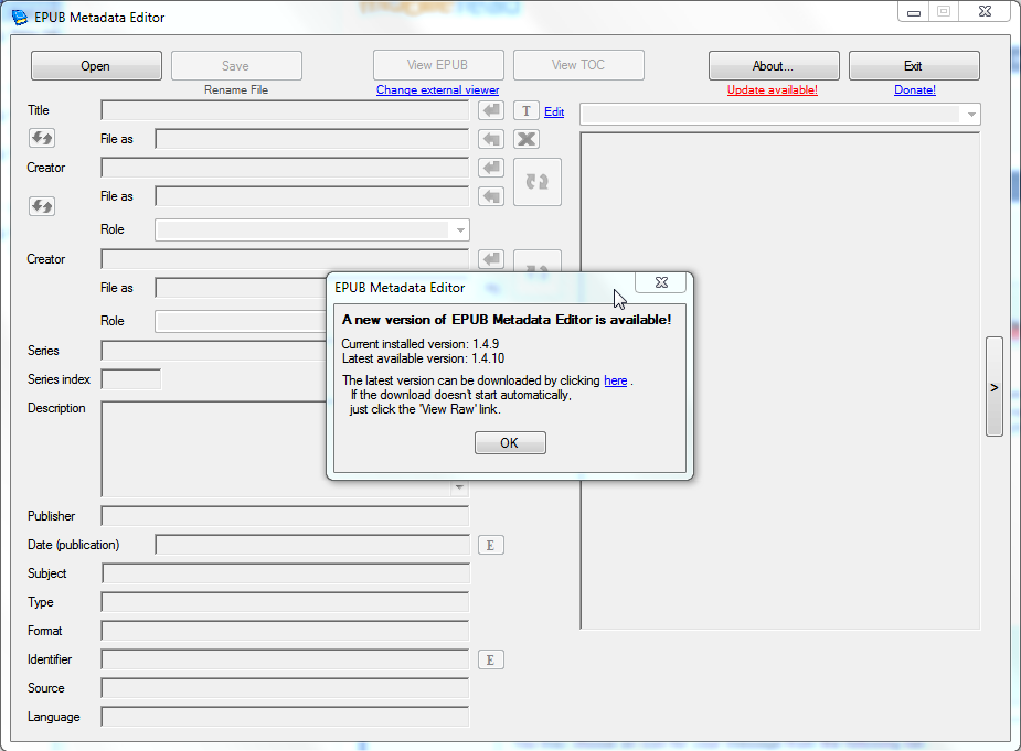

Maybe you could add an easy way to go to the update site/page from the program in the next update. Something like an "update to latest version" button in the "about" screen would be nice for n00bs like me.

Hi Ennas,
Actually, there already is. When there is an update, you can click the little "Update available!" link. A dialog box appears, with another link to the download location and some instructions.

Really? I don't see it. I guess it's only there when you're not up-to-date. Great!
That's right: it only appears when there's an update available.
