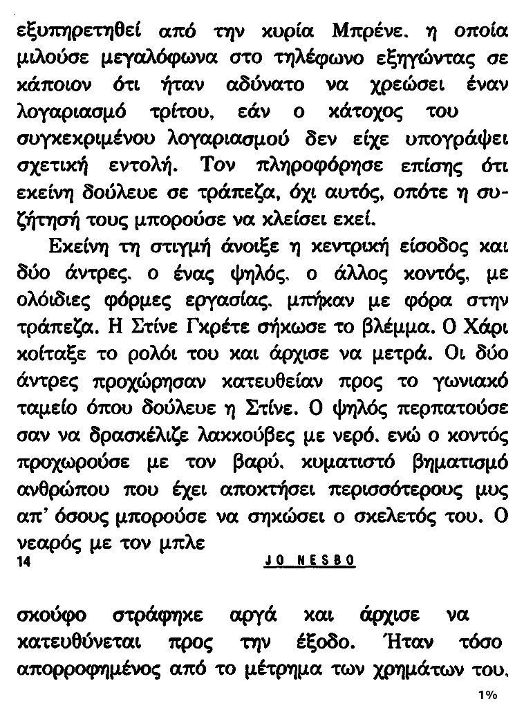

Hello there!
I am trying to find the optimal options for k2pdfopt for my Kindle Paperwhite 2, unfortunately I can't..
The pdf is attached, the language is Greek and after some search, I have used the following options: -mode fp -dev kp2.
Can you please help me?
Thank you very much for your time!
slide13 is offline   Reply With Quote

Originally Posted by slide13 View Post
Hello there!
What do you not like about the conversion? Is the text too small?
Option 1:
k2pdfopt -mode fw -ls- -dev kp2 myfile.pdf
If the text is too small for you, then:
Option 2:
k2pdfopt -dev kp2 myfile.pdf
Option 1:
Option 2:
Thank you so much for your immediate response and support!
Yes, the text was too small, the 2nd option helped me, even though the letters are somehow "dirty" now, and the chapters don't start from a new page, or the header/footer seem to be put in the middle of the page (screenshots attached).
But it's ok, it is more than readable, thank you very much dear willus!
Your program rocks and you're so helpful!
Congratulations!

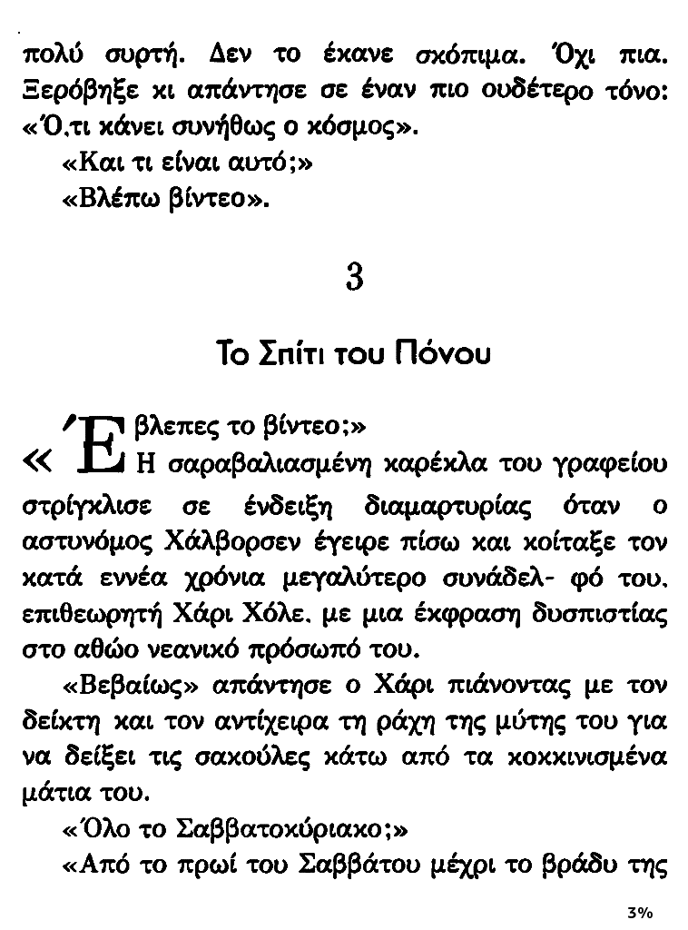

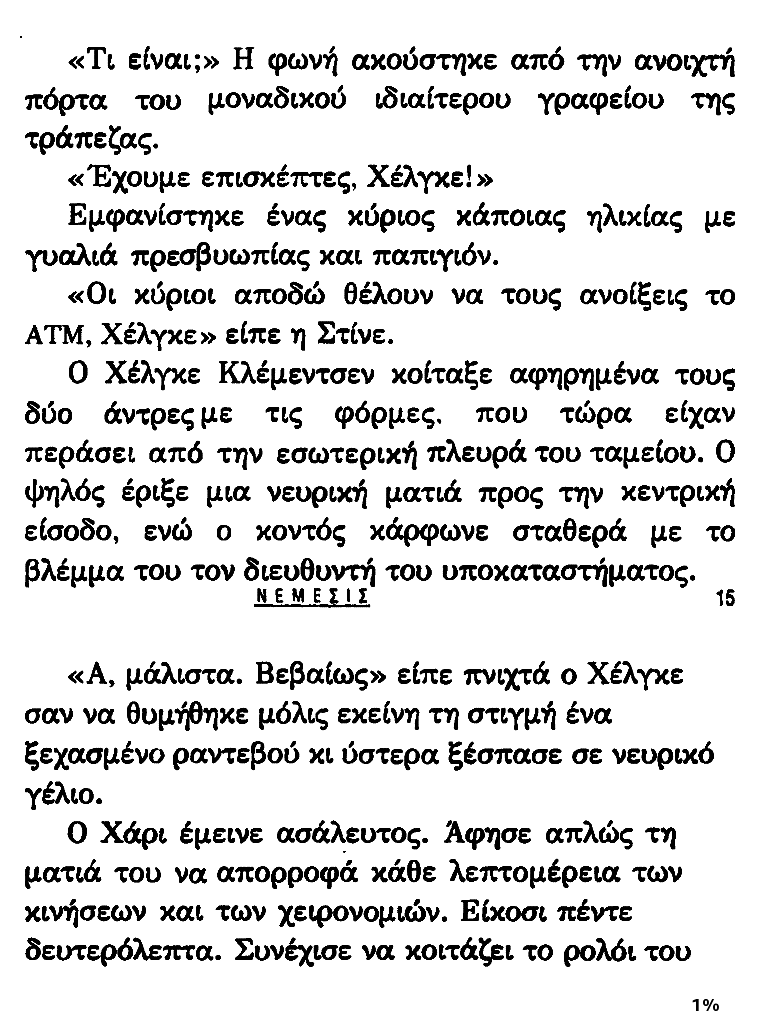

ID:	177165   Click image for larger version
ID:	177166   Click image for larger version
Congratulations!
If the page numbers and headings bother you, you can crop them out pretty reliably like so for your particular document:
k2pdfopt -dev kp2 -m 0.29in,0.73in,0.32in,0.33in nesbo.pdf
The "dirty" look is not really the fault of k2pdfopt. Your source file, if you magnify it enough, has a very pixelated look to it.
