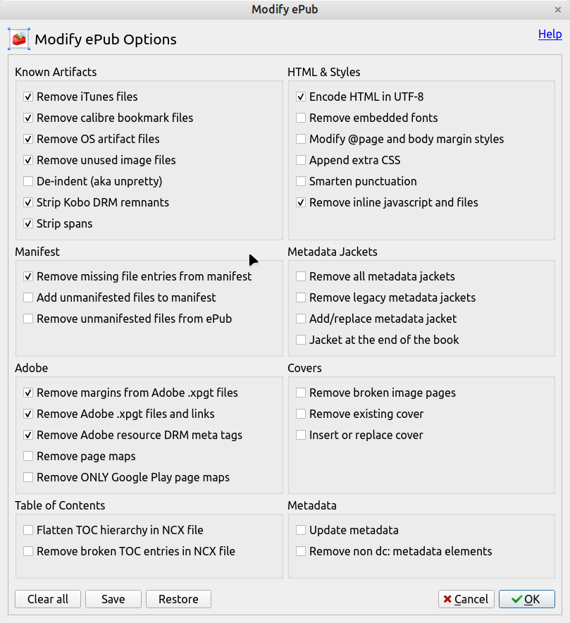

Here is what I have found works after doing Beautify All Files in the editor:
For my first run of Modify epub I use these setting:
Name:	Screenshot from 2023-03-10 17-13-43.png

This is the log file

For my second run of Modify epub I use these setting:
Name:	Screenshot from 2023-03-10 17-15-04.png
this is the log file.
Modify ePubs version (1, 8, 1)
Logfile for book ID 2810 (Furies of Calderon / Jim Butcher)
Job details 2810
  Modifying:  /tmp/calibre_6.14.0_tmp_0jptokt3/3ey61pz7_modify_epub/2810.epub
	  Parsing xml file: OEBPS/volume.opf
	  Parsing xml file: OEBPS/toc.ncx
	Looking for redundant entries in manifest
	Looking for Adobe xpgt files and links to remove
	Looking for pagemaps
	Looking for Google Play pagemaps
	  Removed Google Play anchors from: OEBPS/xhtml/13_butc_9780441012688_oe.xhtml
	  Removed Google Play anchors from: OEBPS/xhtml/56_butc_9780441012688_oe.xhtml
	  Removed Google Play anchors from: OEBPS/xhtml/19_butc_9780441012688_oe.xhtml
	  Removed Google Play anchors from: OEBPS/xhtml/55_butc_9780441012688_oe.xhtml
	  Removed Google Play anchors from: OEBPS/xhtml/10_butc_9780441012688_oe.xhtml
	  Removed Google Play anchors from: OEBPS/xhtml/37_butc_9780441012688_oe.xhtml
	  Removed Google Play anchors from: OEBPS/xhtml/28_butc_9780441012688_oe.xhtml
	  Removed Google Play anchors from: OEBPS/xhtml/06_butc_9780441012688_oe.xhtml
	  Removed Google Play anchors from: OEBPS/xhtml/next-reads.xhtml
	  Removed Google Play anchors from: OEBPS/xhtml/30_butc_9780441012688_oe.xhtml
	  Removed Google Play anchors from: OEBPS/xhtml/32_butc_9780441012688_oe.xhtml
	  Removed Google Play anchors from: OEBPS/xhtml/38_butc_9780441012688_oe.xhtml
	  Removed Google Play anchors from: OEBPS/xhtml/51_butc_9780441012688_oe.xhtml
	  Removed Google Play anchors from: OEBPS/xhtml/01_butc_9780441012688_oe.xhtml
	  Removed Google Play anchors from: OEBPS/xhtml/29_butc_9780441012688_oe.xhtml
	  Removed Google Play anchors from: OEBPS/xhtml/17_butc_9780441012688_oe.xhtml
	  Removed Google Play anchors from: OEBPS/xhtml/41_butc_9780441012688_oe.xhtml
	  Removed Google Play anchors from: OEBPS/xhtml/27_butc_9780441012688_oe.xhtml
	  Removed Google Play anchors from: OEBPS/xhtml/04_butc_9780441012688_oe.xhtml
	  Removed Google Play anchors from: OEBPS/xhtml/39_butc_9780441012688_oe.xhtml
	  Removed Google Play anchors from: OEBPS/xhtml/23_butc_9780441012688_oe.xhtml
	  Removed Google Play anchors from: OEBPS/xhtml/22_butc_9780441012688_oe.xhtml
	  Removed Google Play anchors from: OEBPS/xhtml/52_butc_9780441012688_oe.xhtml
	  Removed Google Play anchors from: OEBPS/xhtml/26_butc_9780441012688_oe.xhtml
	  Removed Google Play anchors from: OEBPS/xhtml/03_butc_9780441012688_oe.xhtml
	  Removed Google Play anchors from: OEBPS/xhtml/35_butc_9780441012688_oe.xhtml
	  Removed Google Play anchors from: OEBPS/xhtml/15_butc_9780441012688_oe.xhtml
	  Removed Google Play anchors from: OEBPS/xhtml/12_butc_9780441012688_oe.xhtml
	  Removed Google Play anchors from: OEBPS/xhtml/48_butc_9780441012688_oe.xhtml
	  Removed Google Play anchors from: OEBPS/xhtml/24_butc_9780441012688_oe.xhtml
	  Removed Google Play anchors from: OEBPS/xhtml/44_butc_9780441012688_oe.xhtml
	  Removed Google Play anchors from: OEBPS/xhtml/34_butc_9780441012688_oe.xhtml
	  Removed Google Play anchors from: OEBPS/xhtml/33_butc_9780441012688_oe.xhtml
	  Removed Google Play anchors from: OEBPS/xhtml/50_butc_9780441012688_oe.xhtml
	  Removed Google Play anchors from: OEBPS/xhtml/53_butc_9780441012688_oe.xhtml
	  Removed Google Play anchors from: OEBPS/xhtml/25_butc_9780441012688_oe.xhtml
	  Removed Google Play anchors from: OEBPS/xhtml/31_butc_9780441012688_oe.xhtml
	  Removed Google Play anchors from: OEBPS/xhtml/47_butc_9780441012688_oe.xhtml
	  Removed Google Play anchors from: OEBPS/xhtml/46_butc_9780441012688_oe.xhtml
	  Removed Google Play anchors from: OEBPS/xhtml/14_butc_9780441012688_oe.xhtml
	  Removed Google Play anchors from: OEBPS/xhtml/20_butc_9780441012688_oe.xhtml
	  Removed Google Play anchors from: OEBPS/xhtml/05_butc_9780441012688_oe.xhtml
	  Removed Google Play anchors from: OEBPS/xhtml/36_butc_9780441012688_oe.xhtml
	  Removed Google Play anchors from: OEBPS/xhtml/40_butc_9780441012688_oe.xhtml
	  Removed Google Play anchors from: OEBPS/xhtml/21_butc_9780441012688_oe.xhtml
	  Removed Google Play anchors from: OEBPS/xhtml/02_butc_9780441012688_oe.xhtml
	  Removed Google Play anchors from: OEBPS/xhtml/07_butc_9780441012688_oe.xhtml
	  Removed Google Play anchors from: OEBPS/xhtml/09_butc_9780441012688_oe.xhtml
	  Removed Google Play anchors from: OEBPS/xhtml/45_butc_9780441012688_oe.xhtml
	  Removed Google Play anchors from: OEBPS/xhtml/54_butc_9780441012688_oe.xhtml
	  Removed Google Play anchors from: OEBPS/xhtml/43_butc_9780441012688_oe.xhtml
	  Removed Google Play anchors from: OEBPS/xhtml/11_butc_9780441012688_oe.xhtml
	  Removed Google Play anchors from: OEBPS/xhtml/42_butc_9780441012688_oe.xhtml
	  Removed Google Play anchors from: OEBPS/xhtml/49_butc_9780441012688_oe.xhtml
	  Removed Google Play anchors from: OEBPS/xhtml/16_butc_9780441012688_oe.xhtml
	  Removed Google Play anchors from: OEBPS/xhtml/08_butc_9780441012688_oe.xhtml
	  Removed Google Play anchors from: OEBPS/xhtml/18_butc_9780441012688_oe.xhtml
	  Removing Google Play pagemap file: OEBPS/_page_map_.xml
	  Manifest item removed: _page_map_.xml (_page_map_)
	Looking for Adobe DRM meta tags to remove
	Looking for html files to remove charset meta tags/encode to utf-8
	Looking for inline javascript blocks to remove
	Looking for .js files to remove
	Stripping Kobo remnants
	Looking for files to remove: ['iTunesMetadata.plist', 'iTunesArtwork']
	Looking for files to remove: ['META-INF/calibre_bookmarks.txt']
	Looking for files to remove: ['.DS_Store', 'thumbs.db']
	Looking for unused images
	Stripping spans
ePub updated in 0.82 seconds
If the first thing I do to an epub from google is run Modtify epub uning the second set of setting then all page marks are removed.
bernie

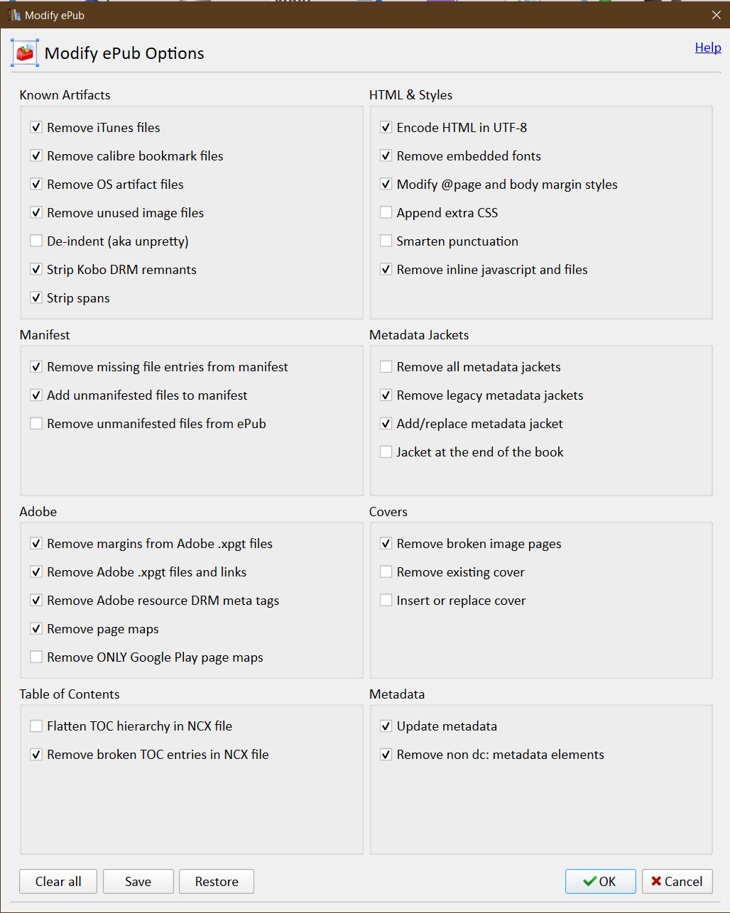

I've attached my Modify Epub settings. Yes, they're different from yours. But, I can't see anything that would stop it from removing those Google Play page maps (again, I've tried all combinations of those two checkboxes). I've also included the top of one of the pages with the play map on it and the Modify Epub log for the run.
EDIT 1: I was also wondering if it might be an epub3 thing. But, since your files are xhtml, I'm assuming that book that you used is also an epub3 (just like the one I'm using).
EDIT 2: And, I've just made another two runs with your first and second set of settings. No difference.
Logfile for book ID 1969 (Fixer Redux / Gene Doucette)
Job details 1969
  Modifying:  C:\Users\Dave\AppData\Local\Temp\calibre_46q9x9yr\yj1641ug_modify_epub\1969.epub
	Updating metadata and cover
	  Parsing xml file: toc.ncx
	Looking for unmanifested files
	Looking for broken links in the NCX
	ncx name:  toc.ncx
	Looping over ncx entries
	Looking for legacy jackets
	Adding or updating jacket
	 Current jacket removed:  OEBPS/jacket.xhtml
	  Manifest item removed: jacket.xhtml (calibre_jacket)
	  Spine itemref removed: calibre_jacket
	  Manifest item added: jacket.xhtml (calibre_jacket)
	  Spine item inserted: calibre_jacket at pos: 1
	Looking for html pages containing only broken image links
	Looking for non dc: elements in manifest
	  Removing child: {http://www.idpf.org/2007/opf}meta
	Looking for embedded fonts
	Looking for css @font-face style declarations
	Looking for inline @font-face style declarations
	Looking for CSS margins
	Stripping spans
ePub updated in 0.44 seconds
Name:	20230310 -- Modify Epub Settings.JPG
Attachment 200239
Don't select to remove unused images as there is a bug. If the image is specified to be used in CSS (section break graphic), Modify ePub will treat it as unused and deleted it. Use the Calibre error checker and it will correctly tell you if any graphics are unused for you to delete.

Originally Posted by enuddleyarbl View Post
Are those <a id="GBS...."/> the actual Google Play page maps? I ask because I downloaded a free Google Play book (Bram Stoker's "Dracula"), added it to Calibre and ran Modify Epub on it. I've put the whole log, below, but for our purposes here, the important part is:
	  Removing Google Play pagemap file: Ops/_page_map_.xml
It found and removed the page map file and manifest item, but did nothing about those anchor tags. The book is in epub2 format (not epub3) and the anchors are non-self-closing. But, after the run, they got converted to self-closing and another run of Modify Epub still didn't do anything with the tags.
This isn't the end of the world for me. If those kinds of tags get in my way, I can always run some easy regex to move or clean them out. But, what I'm seeing with Modify Epub isn't what I'm expecting. But, then, it could just be that I don't understand what's what. However, the help file says the option should remove both the files and the anchors. It doesn't seem to be doing that latter.

If the Google eBook has <a id="GBS...."></a> then Modify eBook won't work to remove them because it's a bug in the code. It has to be <a id="GBS...."/> in order to work.

Modify ePub changed all those <a></a> pairs to self-closing anchors. The next run of ME still didn't delete the (now) self-closing anchors.
enuddleyarbl is offline   Reply With Quote
Old 03-11-2023, 01:41 PM   #1734
Posts: 84,218
Karma: 153715495
What you do is not delete any page maps on the first run and then delete the page maps on the second run.
I've tried it and yes, it does work.
