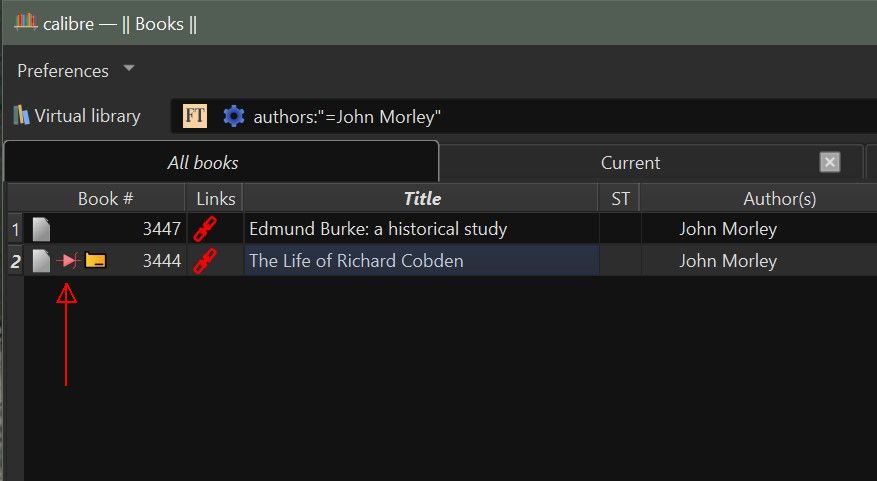

FWIW: Whenever a book is converted the conversion settings used are stored in the database regardless of whether they are specifically set or the 'default' settings in Preference are used.
The template function has_conversion_options can be used to interrogate, I use it to set a column icon:
Name:	Screenshot 2025-10-23 074636.jpg
They can be removed in Bulk Metadata edit
