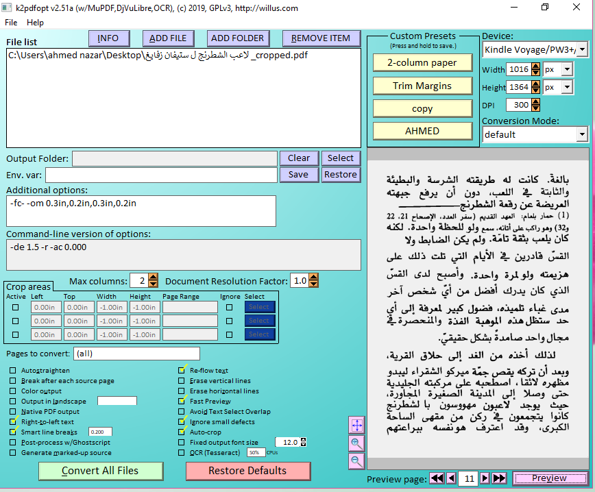

could you find the best setting even if i use text reflow to make it in good shape on kindel the space between lines is not the same and it look bad
this is an image of it

Originally Posted by ahmd5800 View Post
and this is the sourse file sir
The default options work pretty well for me (along with -r to go right to left). You can increase the size by setting dpi to 400 instead of 300, for example, e.g.
k2pdfopt -r -odpi 400 -vls 1.5 mydoc.pdf
Your margin cropping is a bit aggressive (it will cut off some of the text on some of the pages) and not really necessary--nor are the -ac or -de options since your scan is very clean.
The font varies in size because some of it is from the footnotes, which are typeset in smaller font.
The -vls 1.5 should keep the line spacing more uniform at 1.5x single space.
Last edited by willus; 02-03-2019 at 04:00 PM. Reason: Add comment on line spacing

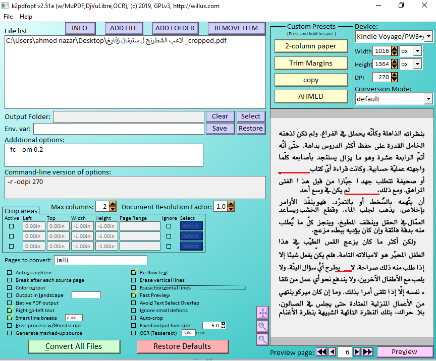

thanx sir but how can i get red of abnormal space like in the picture
also if i change the dpi is it ok?
what about if i change the device and chose smaller one (hight and width), is it stel work on my device?
best regard
Yes--most devices will just fit the PDF page to their screen even if the dimensions or resolution don't exactly match that of the device.
To prevent the large spacing between words you can either turn off full justification like so:
-j 2-
... or you can adjust the word-breaking parameter, e.g. try:
-ws 0.05
K2pdfopt tries to mirror the justification of the source document, which is why full justification is turned on by default for your case.
