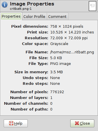

Originally Posted by Brynwall View Post
The size is correct on all 5 of them, they are all in .png format, and they are all 16 bit (from what I can tell).
16-bit (65536 colors) or 4-bit (16 colors)?
Originally Posted by FAQ, First Post
...on FW 5.x, that means checking the size, format, resolution of each and every file in your pool, to see if it matches the device, and really is a PNG8 (optionally properly dithered down to 16 colors).

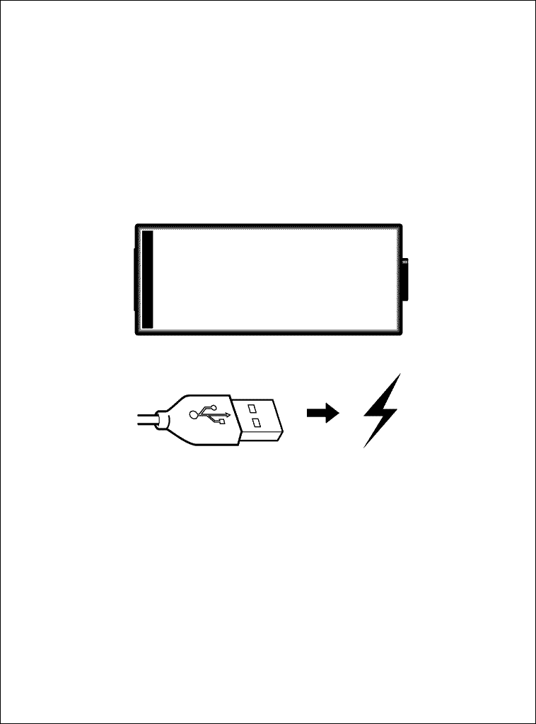

Originally Posted by Amazon, PW-1
/opt/amazon/low_level_screens/758x1024/critbatt.png
critbatt.png: PNG image data, 758 x 1024, 8-bit grayscale, non-interlaced

For the ones that are broke, you can use imagemagick to correct them ('identify' is just one of its command line tools).
I suppose if you got this much correct, it would work:
Geometry: 758x1024+0+0
Resolution: 28.35x28.35
Print size: 26.7372x36.1199
Units: PixelsPerCentimeter
Type: Grayscale
Base type: Grayscale
Endianess: Undefined
Colorspace: RGB
Depth: 8-bit
Channel depth:
gray: 4-bit
## I mean, get ^^^ part correct, the following is just the stats of critical battery image:

In the above case, four shades of gray out of the 16 (i.e: depth=4bits).
The gimp does not give out with that many details:
ID:	142136   Click image for larger version
Name:	Screenshot at 2015-09-20 07:15:26.png

Yep, ideally, PNG8 (256c), properly dithered to 16 shades of grey.
If you do dither yourself, the tricky thing is that some image processors will then store that as a true 16c palette, which, err, the Kindle doesn't like, it really, really wants a 256c palette.
