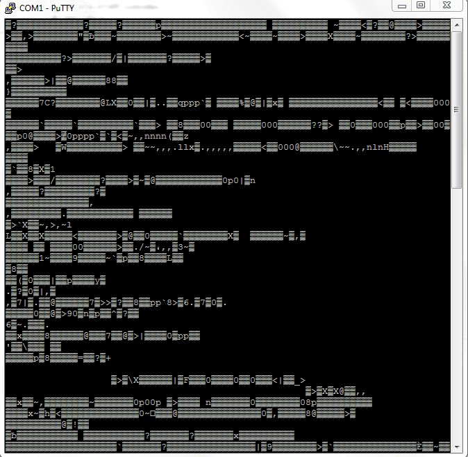

Old 06-24-2016, 03:23 PM   #156
dalvick
dalvick began at the beginning.
Posts: 9
Join Date: Jun 2016
Device: KT2
hello,
have you an idea how to resolve this?
[Image violates Posting Guidelines for size - MODERATOR]
thank you

Old 06-24-2016, 03:52 PM   #157
geekmaster
Carpe diem, c'est la vie.
geekmaster's Avatar
Posts: 6,433
Karma: 10773670
Location: Multiverse 6627A
Device: K1 to PW3
Originally Posted by dalvick View Post
hello,
thank you
That can happen when you send binary data to the console. Depending on your terminal program, you may be able to type "reset" (without quotes) followed by the enter key, or you may have a "reset terminal" in your terminal app settings menu (in putty, click the putty icon in the upper-left corner of the window, and "Reset Terminal" is near the bottom of the list). That usually works for me. If not, close and reopen your terminal window, but you may lose any work in progress in the window you close.

Old 06-24-2016, 04:50 PM   #158
knc1
Going Viral
knc1's Avatar
Posts: 17,212
Karma: 18210809
Location: Central Texas
Device: No K1, PW2, KV, KOA
or your ground lead to the Kindle came loose.
Old 06-24-2016, 07:31 PM   #159
geekmaster
geekmaster's Avatar
Posts: 6,433
Karma: 10773670
Device: K1 to PW3
Because it is all left-justified, it just looks like his character set got hosed. I have seen screens like than many times, and a "reset terminal" almost always fixes it.
But having extra options, just in case needed, is a good thing...
Old 06-24-2016, 07:49 PM   #160
knc1
Going Viral
knc1's Avatar
Posts: 17,212
Karma: 18210809
That same behavior has had another (2) two reported causes -
Wrong interface voltage used with the serial adapter -
Serial adapter that takes an external reference to set the interface voltage and the source used had a lot of noise on it.
Since the poster did not include any detail other than "serial port" -
We don't even have any clues to guess from.
Posters:
Context! Context! Context!
This is a technical forum that handles technical questions -
And most of the time, our crystal balls are off-line (crystal ball air-time is far too expensive).
Old 06-24-2016, 08:26 PM   #161
geekmaster
geekmaster's Avatar
Posts: 6,433
Karma: 10773670
Device: K1 to PW3
Posters:
I had problems on some of my kindles (K4/K5) that were flaky using the GND pin/pad on the TTL serial connector. I got working using my full level-shifter circuit. Then I discovered that half the circuit was not needed (kindle Rx) if I used a solid grond, like the USB shell, or another obvious solid ground (3.3v tolerant Rx on the 1.8v input). So a good ground is very important, and the one on the connector is not a good ground in my experience. But more like NO output, not scramled characters. It looks like CR/LF are working (typical screen layout) so more like character set issues (perhaps triggered by a few bad "binary" characters). Caused by bad ground -- persistent until terminal reset...
Old 06-25-2016, 08:01 AM   #162
dalvick
Posts: 9
Join Date: Jun 2016
Device: KT2
hello, thank you for answers
i use this without external power
http://www.ebay.fr/itm/RS232-To-TTL-...-/252399950706
and do the same think when i unplug 5v cable and use external!
terminal reset dont resolve it and with tera term ger the same issue

Old 06-25-2016, 08:55 AM   #163
knc1
Going Viral
knc1's Avatar
Posts: 17,212
Karma: 18210809
Wrong interface voltage, that adapter is not for 1.8 volt, low voltage, ttl serial.
That is a RS-232 (12 volt interface) adapter.
It is very likely that you have destroyed the serial port in the SoC.
Disconnect that thing and get the proper adapter.
If your very lucky, the SoC might still work.

Old 06-25-2016, 09:41 AM   #164
geekmaster
geekmaster's Avatar
Posts: 6,433
Karma: 10773670
Device: K1 to PW3
The only way you can use that adapter is if you run it with the RS232 side connected to an older PC (most modern PCs do not have an RS232 port), or with a USB RS232 adapter connecting that 15-pin RS232 connector to a modern PC. You must also use a level shifter circuit on the TTL (3-pin) side. This adapter uses 5v TTL and the kindles are 1.8v TTL). However, MAX232 chips are known to generally work okay when powered by 3.3v, but your adapter seems to derive its power from the RS232 interface (so no easy way to adjust it). Depending on how that green LED is wired into your circuit, it might cause problems (though it may just be a power indicator, which is fine).
Old 06-25-2016, 03:39 PM   #165
dalvick
Posts: 9
Join Date: Jun 2016
Device: KT2
thank you
The adapter is a 5v interface, i hope that the serial port still a live.
as english is my 4th language is hard to me to understand all, next time will try read more before acting
thank you very much again, your work is amazing
