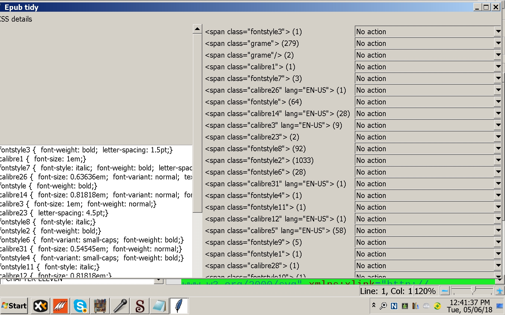

Problem
Hi
I use ePubtidy a lot but sometimes I get the problem illustrated by the attached image. If you gave time available could you have a look at it please.
Thasaidon is offline   Reply With Quote

@Thasaidon
I am not sure what the problem is - please describe the issue. Is it that the names of the included tags go off the scroll box?
CalibUser is offline   Reply With Quote

Sorry. I should have given more of an explanation.
Basically it is not possible to access all the tags on the right because they go off the screen and I cannot access the 'OK' button
This would not matter if I could access the "OK" button at the bottom of the screen as I could access those tags that are visible and click on "OK". I could then run the plugin again and hopefully the number of tags would have been reduced enough so I can access the rest.
