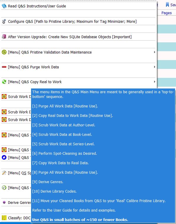

Version 3.6.106 - Python 3.8 & Performance Improvements
Version 3.6.106 - 13 February 2020 Q&S has been overhauled, refurbished, refactored and restructured to greatly improve its performance and reliability, and to make it fully Python 3.8 compatible. Retested with both Calibre 4.10.1 (Python 2.16+) and Calibre 4.99.4 (Python 3.8).
Remember to run the menu option near the top of the Q&S menu starting with "After Version Upgrade: Create New SQLite Database Objects"; this should be done after any installation of Q&S, new or upgraded.
Also, hover your mouse over the Q&S main menu to view its blue main menu ToolTips (see the attached).
See the Original Post for more details.
