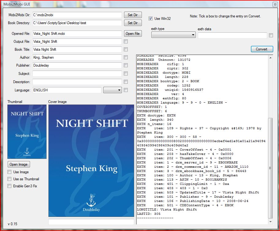

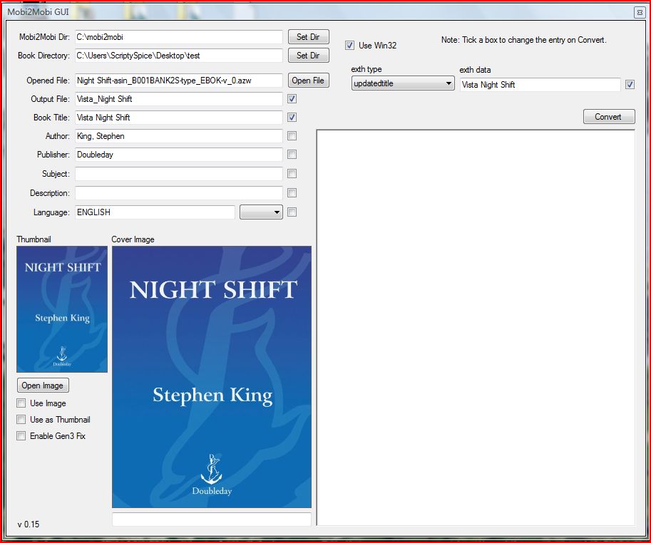

Thanks for that Wallcraft..
Yes the updatedtitle should be the last entry in the exthtype drop list.

*That* was the ticket Wallcraft. The GUI now with the "exth data", works perfectly!

I might look at modifying the GUI to process the book title as per this method when the book source is .azw. This will save having to know you need to play around with the updatedtitle exthtype. I might bug you via PM when I get that mod sorted for testing if you don't mind.

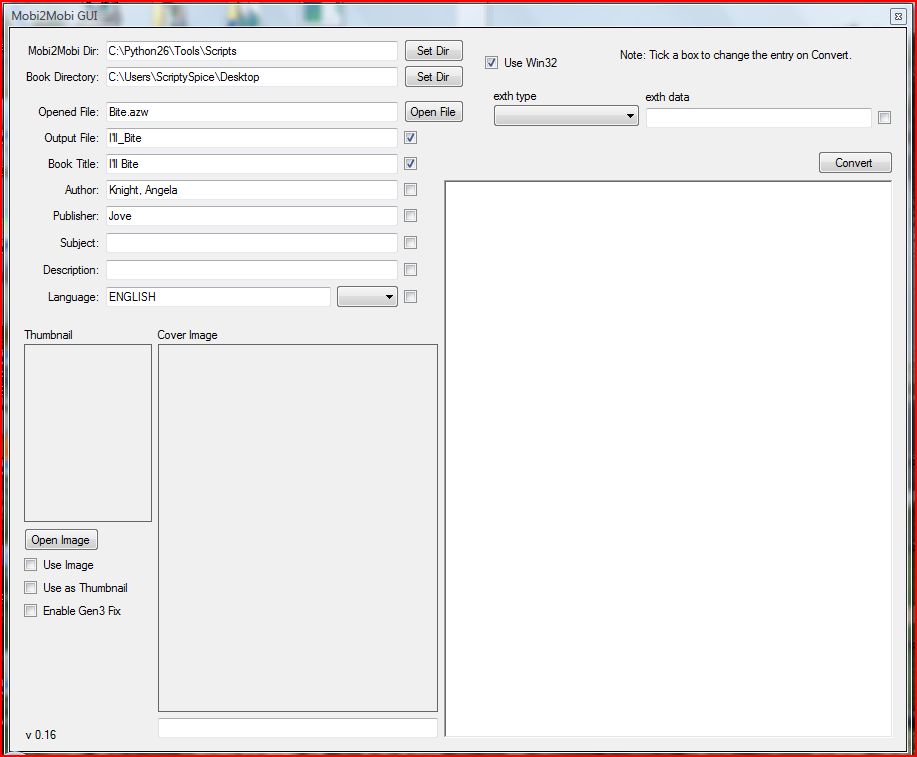

Here are the results of v16. The original title of the book is "Bite".
In the pics 1 and 2, I forgot and used the "exth data" box to name the file "Don't Bite".
In pics 3 and 4, I *did not* use the "exth data" box and named the book "I'll Bite".
The last pic is from my Kindle where both titles showed up correctly. IT WORKS!!!!!

v0.16 Released
When converting an AZW file with the Book Title field updated, the GUI also updates the exthytype 'updatedtitle' with the same details. On Kindles the 'updatedfile' field overides the 'longtitle' field info.
Thanks to wallcraft for pointing us in the right direction in regard to this.
