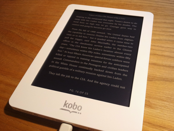

[ALL] Night Mode - read light-on-dark
Nightmode for Kobo
Read light-on-dark on your Kobo AuraHD / Glo / Touch or Mini!
Installation / Removal
  • Download the attached zip file
  • Connect your Kobo to your computer
  • Extract the file KoboRoot.tgz from the installer / uninstaller folder
  • Copy it to the .kobo folder on your device
  • Safely remove the USB storage and unplug
  • Your device will reboot automatically
Control nightmode
There are two ways to control this mod:
  • Long-press the LIGHT/HOME button to toggle on/off
  • Use a launcher to start the nightmode.sh script:
    • KoboLauncher: Add:
      Night Mode = /mnt/onboard/.kobo/nightmode.sh
      to .kobo/KoboLauncher/kobo_launcher.ini
    • or KoboTweaks: (not working on 2.6+) Add:
      Night Mode=tweaks.executeSystemCmd(\"/mnt/onboard/.kobo/nightmode.sh\")
      to .kobo/kobotewaks.ini
Configuration
In your .kobo folder, there will be a configuration file called nightmode.ini. You can change whether the state should be retained over a restart of the device, the default state after power up and the duration for a long press. The new setting will take effect after a restart.
FAQ
  • I have updated my firmware and it stopped working!
    Simply install the mod again
  • Will this drain my battery?
    The effect on battery life should be negligible
  • I can see more ghosting when the mod is activated!
    This is normal, as eInk screens are optimized for black-on-white mode. Change the refresh rate if it annoys you.
More info
For a more detailed description, the changelog and the source code, visit github:
http://dbeinder.github.io/kobo-nightmode
Credits
  • KevinShort, for the idea and a first proof of concept
  • Nicolas Devillard and others, for the iniParser library
yoq is offline   Reply With Quote

The first thing I noticed were the huge gaps between the lines before noticing that it's in night mode.
