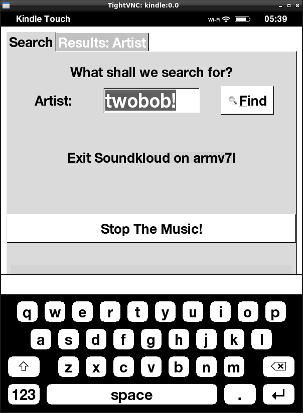

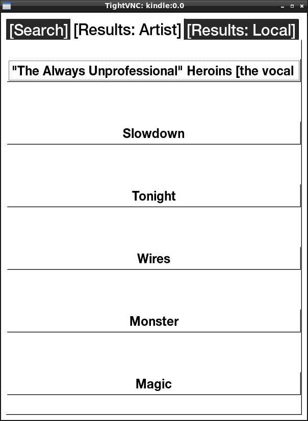

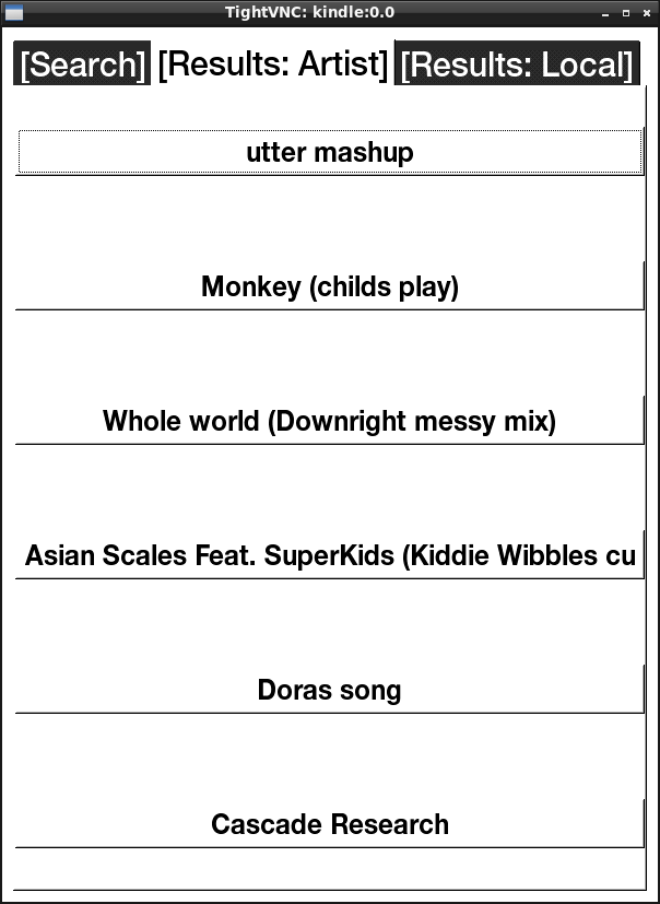

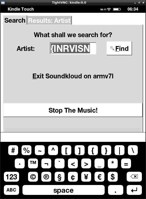

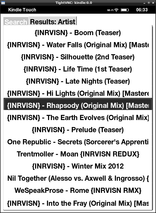

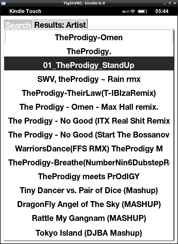

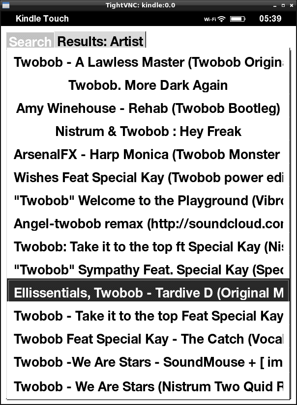

got 15 results loading happily.
will wait on qlob to implement some iteration and other API related searches.
Would like to load a larger results set and just display the first 15 (or possibly implement a scrollbar based solution)
Would like to add some user defaults (results per page etc)
Need to fix the odd escaping behaviour of bash on my quotes.
But yeah. much better.

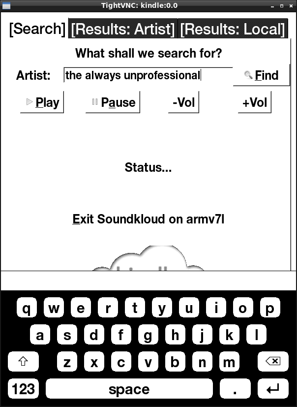

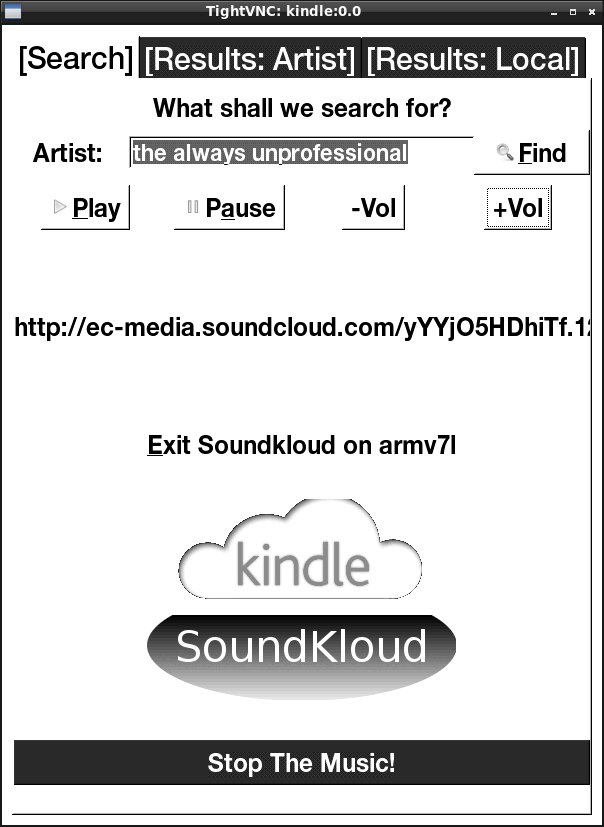

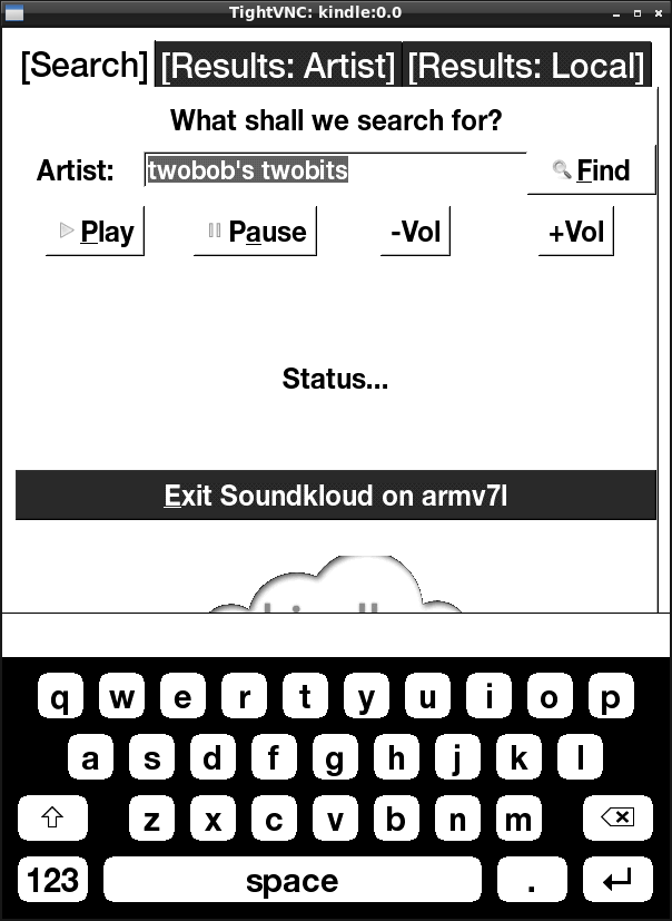

Todays edits:
Status box with updated stream info every few seconds. (currently just prints the stream url badly )
per-label text-style control
gtk_widget_modify_font(label03, pango_font_description_from_string("Tahoma 11.2"));
Local search to play local files for local people.
Wider search box and smaller font to allow for longer search terms.
Search terms now accept spaces.
Other bits and bats. play button now restarts stream, pause works, volume also can be set.

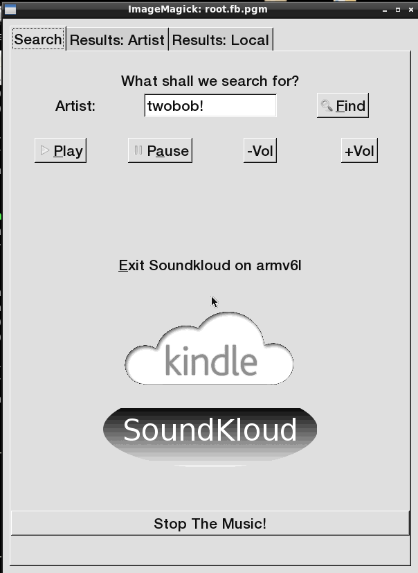

Thanks to https://www.mobileread.com/forums/sho...93#post2367393 and a bit of gratuitous grafting we have this all neatly running on the 3.
Wow. that was less hard than I imagined... (next up... install python on the 3) (embedded in the loop for now I think)
