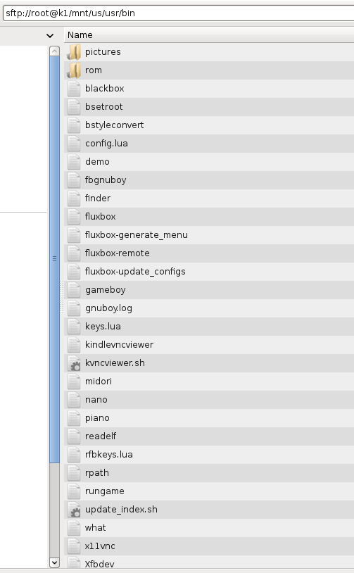

Well. that is really up to you. everything you typed about I ASSUME you meant /mnt/us before...
"then gets picture from usr/bin/pictures "
err no /mnt/us/something...
I did highlight those important paths in the original script.
Personally, I have amended the kindle system path to include the /mnt/us/usr/bin/blah stuff
(as outlined http://minimodding.com/article9-Kind...ng-custom-apps)
did you try PATH=$PATH:/mnt/us/usr/bin rungame
You can affect the environment variables at runtime by putting it before the call.
TBH It's a basic script. ignore the top bit.
just the bottom few lines actually matter.
check you DO have the stuff in either /mnt/us/fbgnuboy/here
(I honestly don't have that but that's the default "install location" IIRC)

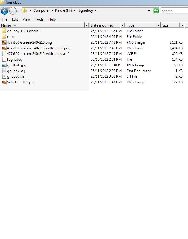

From what I understand I create the .ini file in the launchpad folder, which has within it:
!/mnt/us/fbgnuboy/rungame
So, it points to rungame - is this just a file we create in the relevant directory, and does it need a .sh extension?
There were 2 different scripts, do we need both of them called gnuboy.sh and one called rungame, or should everything be in one script (as I can't understand if there is meant to be two, how the second script is coming into play)
Presumably eips -g ./gb-flash.jpg does not need a path change as it already changes dir to the correct place.
What the stuff does only matters to me as I'm trying to understand where scripts should be as clearly I'm not doing it right... :-)
I wondered if HOME=/tmp would alter the cd /mnt/us/fbgnuboy so that ./fbgnuboy wouldn't run? I don't understand how that command works, though I understand it is there because of Gameboy requiring to write (plus whatever reasons relate to the custom modding link you sent).
Or maybe the prolem is because I'm saving the script in Notepad and not in Linux??
Anyway thanks for all the help, it's a learning curve..
edit: do I have to make the file gnuboy.log in advance?

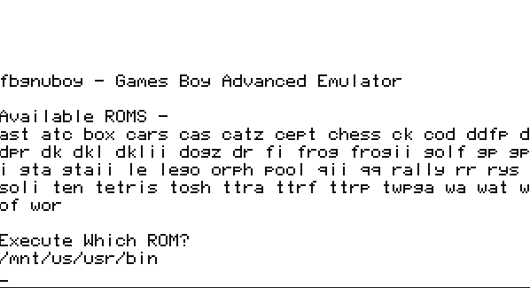

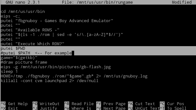

therefore... if in doubt... in the future exactly where you "are" during a script you can drop in a pwd
Simply stick echo $PWD in the script (pictured, mine runs in /mnt/us/usr/bin/)
IN THIS CASE HOWEVER... using putei will lay it out nicely...
(pictured)
Heck you can put a echo $PATH too in the script if you want to be sure...

twobob: you said try the call with the superfluous bit in earlier post, so I tried it..
As far as I can see I checked all the paths, and checked all the Linux basics I might be wrong about, but still getting zip...
Anyways, I appreciate the scripting 101, hopefully it will help someone else too, and at least I can still run it in Kindle Terminal.
I tried the script in SSH and it works despite this message:
eips: paint_char> character "!" not available
..at least up to the point of selecting a rom.

Might I ask that you post the exact script you are using please?
And an idea of the exact content of the relevant bits of your file system would make supporting you a shedload easier too : )
so:
rungame script. A copy of your current one please.
screenie of /mnt/us/fbgnuboy/ directory content
(see if there are any surprises in there...? compare it to script...)
a copy of your launchpad.ini thing you are triggering (the one for the gameboy, check it for whitespace or other usual suspects)
