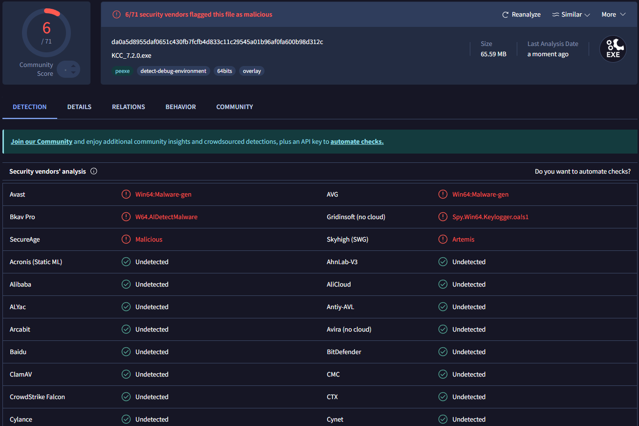

Is it safe?

Posts: 55,706
Karma: 182544312
Up to you. Run any random program more complex than "Hello, World!' through a mass of antivirus programs and you will get false positives 90% of the time.

Malwares and Malicious don't bother me that much cause it really looks like false positive, but keylogger?

As the kcc developer, I have no idea why random antivirus flag kcc.exe. Especially after a new release and it hasn’t reached the critical mass of downloads yet.
You are also welcome to run the code directly using the earlier guide.
The exe is built directly on GitHub servers using the code publicly available. You can also rebuild the exe yourself on GitHub servers if you fork the repo and enable github actions.
Scanning will always give some false positives, you can inspect the kcc code yourself to verify there's nothing weird there.
