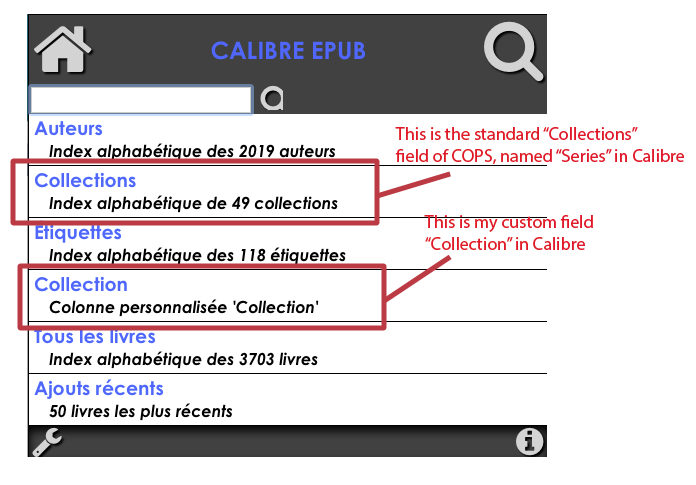

1. First my questions :
a. Why is the field named "Series" in Calibre named "Collections" in COPS ?
- This is not only confusing for anyone, but I happen to have created a custom column in Calibre with the name of collection (and not Collections). So it is even more confusing for me !
b. I can't figure out what parameters should be written in config_default.php and/or in config_local.php. Il seems to me that some stuff only works in one of the files and some in the other. In the end I essentially have the same parameters in both files.
- If someone can explain how these two files should be used together, I would appreciate

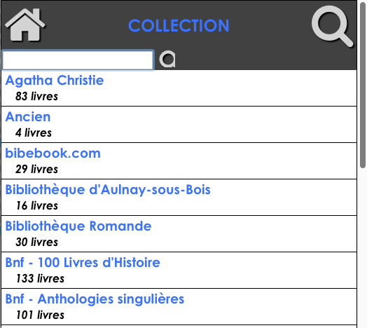

I have the custom field named "Collection" appear in the welcome window of COPS.
YEAH!
The custom field is displayed along with the standard sections (Authors, Tags, Collections, etc.)
The label says "Custom column "Collection"
If I click on the label I go the a second page with all my "Collections" (not to be confused with the hard wired Collections/Series). The names and book counts are correct and match the Calibre data.
YEAH! YEAH!
But when I click on one of the labels I either go to a blank page [IOS] or into a never-ending wait (the blue circling dots next to the title of the html page) [MacOS/Safari]
By the way, my custom column in also NOT displayed in the book detail window as I believe it should
For those that it could help, the page the browser is trying to reach is something like
http://xx.x.x.xxx/COPS/index.php?pag...m=1&id=14&db=0
or
http://xx.x.x.xxx/COPS/index.php?pag...om=1&id=3&db=0
etc.
Sorry for the long post. I tried to explain the whole context in order to provide useful information to the experts that, I hope, will answer my questions and issue.

Just a few quick answers:
1a - COPS is language localized. Collections is french for series.
If you want to use “series” in cops you can:
- change the language of your device to english, or
- change the french language file in the /lang directory, or
- use the command at the bottom of the config_local.php file and use the english language (never tried it).
