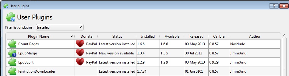

Jade Aislin
Jade Aislin could sell banana peel slippers to a Deveel.Jade Aislin could sell banana peel slippers to a Deveel.Jade Aislin could sell banana peel slippers to a Deveel.Jade Aislin could sell banana peel slippers to a Deveel.Jade Aislin could sell banana peel slippers to a Deveel.Jade Aislin could sell banana peel slippers to a Deveel.Jade Aislin could sell banana peel slippers to a Deveel.Jade Aislin could sell banana peel slippers to a Deveel.Jade Aislin could sell banana peel slippers to a Deveel.Jade Aislin could sell banana peel slippers to a Deveel.Jade Aislin could sell banana peel slippers to a Deveel.
Posts: 174
Karma: 3100
Join Date: Sep 2011
Device: Kobo Auro H2O, PRS-T1
Originally Posted by s_stabeler View Post
( I thought I had the latest version of the plugin though, since Calibre hadn't mentioned a newer version...)
I haven't been getting told about updates either. When I checked the plugin updater, under installed plugins, I found that FFDL is not listing the available version. In addition, the release date says 01 Jan 0101 (see attached pic). I'm not sure why or if anyone else is having this problem. The plugin still works. I'm just not being told of updates.
Name:	plugin problem.jpg
Jade Aislin is offline
Old 08-01-2013, 08:37 AM   #1590
Firedancer885
Occassional Beta Tester
Firedancer885 can teach chickens to fly.Firedancer885 can teach chickens to fly.Firedancer885 can teach chickens to fly.Firedancer885 can teach chickens to fly.Firedancer885 can teach chickens to fly.Firedancer885 can teach chickens to fly.Firedancer885 can teach chickens to fly.Firedancer885 can teach chickens to fly.Firedancer885 can teach chickens to fly.Firedancer885 can teach chickens to fly.Firedancer885 can teach chickens to fly.
Posts: 284
Karma: 3516
Location: Hungary
Mine is the same.
Firedancer885 is offline
