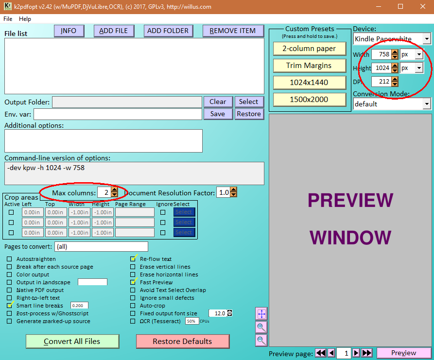

Hi,sorry but i do not speak eanlish very well,i ave this problem, I have the pocketbook aqua2 analysis 758 on 1024,212 ppi., it does not have a choice, I get the nearby Kindle dx, the pocketbook basic 167 ppi lower resolution, I do not get reflow, I choose fitpage, native pdf, smart line breaks, in but it's in other books, not in the wicker type I read without pictures does not grow the font even when I change the fixed output font size to a larger number
If you want reflow, you should not select fit page or native pdf. Do not select those. You can override the device settings with your own device settings. I recommend something like on the screenshot attached. If your text does not have multiple columns, set the maximum number of columns to 1.

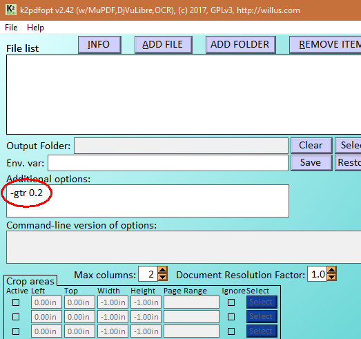

Dear Villus,
same problem with iliastald, reflowing isn't work very well, I have tested your recommended settings but it's not working. I attach you an image before and after convertion.

Originally Posted by Conan1982 View Post
Dear Villus,
Try a larger value than the default (the default is 0.006) for -gtr, like 0.2. (gtr = Gap Threshold for Rows.) See the attached screenshot. This makes k2pdfopt more likely to separate rows of text even when they are crowded together. The drawback is that too high of a value might separate images or figures incorrectly, but if you don't have any images or figures, you can set this to a higher value without much drawback.

It works (with value at 0.8-0.9)!!
Thanks!
