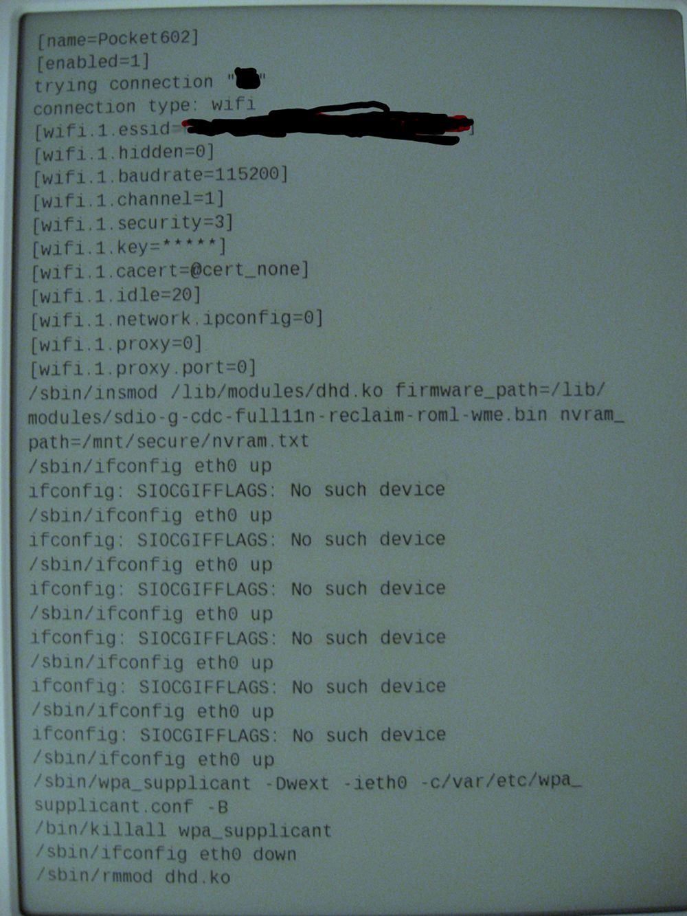

I got my 602 today and after playing around a bit I also wanted to connect it to my wifi network.
When it didn't work, I upgraded the firmaware to 2.0.4. Also this didn't solve the problem.
In the end this only worked after I removed the "Hide SSID" option in the router.
If the 602 is not able to connect to a hidden SSID this will render the device completely useless for me
With the SSID in the open the lines after
/sbin/wpa_supplicant -Dwext -ieth0 -c/var/etc/wpa_supplicant.conf -B
read
/sbin/udhcpc -n -t 7 -T 3
udhcpc (v1.16.1) started
Sending discover ...
Sending select for 192.168.x.x ...
Lease of 192.168.x.x obtained, lease time 864000
deleting routers
route: SIODELRT: No such process
adding dns 192.168.x.x
Please look into this and let me know if the 602 really can't handle hidden SSIDs. In this case I will have to return it.
read
deleting routers
Sure does handle hidden routers. You just have to enter the router's name and PW manually.
Old 01-25-2011, 07:17 AM   #144
review
review got an A in P-Chem.review got an A in P-Chem.review got an A in P-Chem.review got an A in P-Chem.review got an A in P-Chem.review got an A in P-Chem.review got an A in P-Chem.review got an A in P-Chem.review got an A in P-Chem.review got an A in P-Chem.review got an A in P-Chem.
Posts: 315
Karma: 6448
Device: 903
However, it seems that one has to make sure that there aren't any special characters in the SSID. Like Fritz!Box or so. E.g. I also can't connect to a hidden wlan network if there is a special character in the SSID but I can connect to the same network if the name is broadcasted. pferdefuss might try to change the SSID to something simple and short and put this in manually.
review is offline   Reply With Quote
Old 01-25-2011, 10:06 AM   #145
pferdefuss
pferdefuss began at the beginning.
Device: Pocketbook 602
Thumbs up 602 - How to handle hidden SSIDs
OK, the special characters might mess this one up
I'm still calling "bug" here, but I guess it's low priority
Apart from that, I might actually refrain from keeping my SSIDs hidden. Seems that it doesn't provide the additional layer of security I was expecting from it the whole time
for taking the time and enlightening me .
