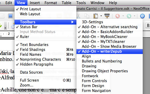

Originally Posted by andersvinther View Post
Strange - I don't have that menu...
Then I stupidly closed the floating menu...
Look at the attached picture…
Luke

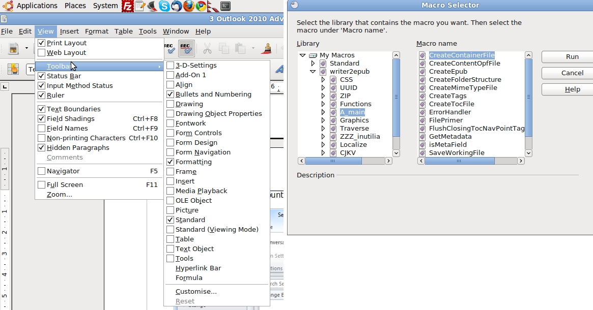

Join Date: Aug 2010
Hi Luke,
Thanks for your reply...
My Toolbar menu does not have any writer2epub entries... see image...
I am installing OO on windows now to see if I can get it to work there...
Thanks,
Anders
