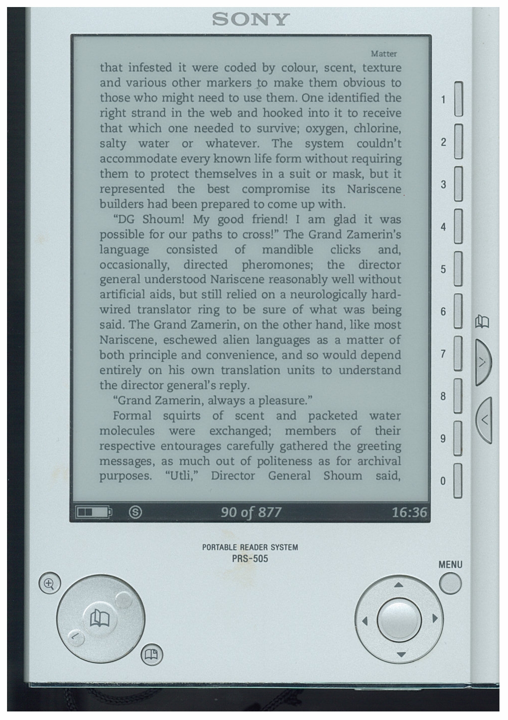

gregcd
gregcd rocks like Gibraltar!gregcd rocks like Gibraltar!gregcd rocks like Gibraltar!gregcd rocks like Gibraltar!gregcd rocks like Gibraltar!gregcd rocks like Gibraltar!gregcd rocks like Gibraltar!gregcd rocks like Gibraltar!gregcd rocks like Gibraltar!gregcd rocks like Gibraltar!gregcd rocks like Gibraltar!
gregcd's Avatar
Posts: 90
Karma: 100000
Location: New Zealand
Device: prs-t1, prs-650 to sell
Just for comparison, here is a screenshot of on LRF file using a reader that has been flashed with caecilia.
I've got over the quirks of LRF and enjoy the justification of text and speed that epub lacks on the 505.
Theres no ragged right here
gregcd is offline   Reply With Quote
