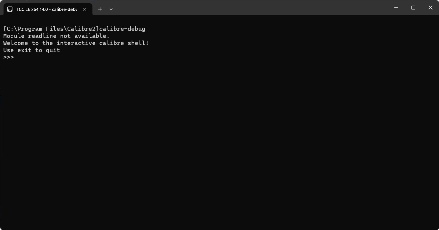

Posts: 81,405
Karma: 150264805
Windows 11 here and calibre-debug won't work. I get some sort of calibre interactive shell. Going to the calibre directory doesn't help. I have uninstalled calibre 7 and reinstalled. calibre-debug is still broken.
