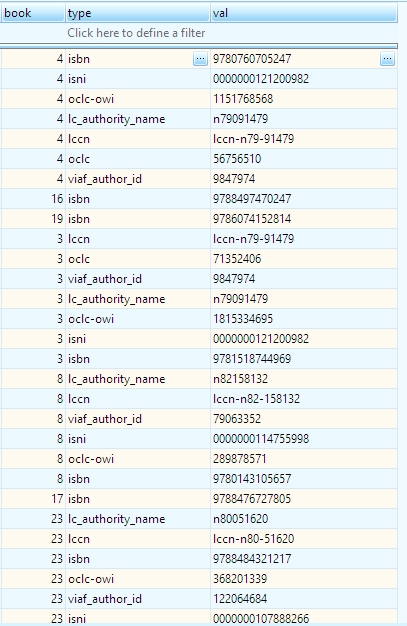

I think the issue might possibly be that you are trying to create 2 Identifiers simultaneously from a single source field. Identifiers is a complex metadata item, which is why it is not shown in the columns available in Preferences > Add your own columns. It is stored in the database with a key of both book ID and ID TYPE (e.g. isbn or issn or sudoc) and a result field of the value for that combination of book ID and ID TYPE. See the attached image of the metadata.db table "identifiers". That should give you a visual impression of the "destination" that you actually are attempting to populate.
You could create a temporary "Comments Short-Text Like Title" Custom Column each for sudoc and worldcat, then populate each using S&R separately. Then, use S&R for each temporary Custom Column to create a single Identifier for that respective temporary Custom Column. Once both of the Identifiers have been updated, you could delete the contents of the temporary Custom Columns.
Or, you could just keep the temporary Custom Columns permanently, and not make them into Identifiers. Up to you.
Note that if you want to see an Identifier in the Library View, you must create a Composite Custom Column (i.e., built from other columns) with a template such as {identifiers:select(sudoc)} or {identifiers:select(worldcat)} or {identifiers:select(isbn)}.
If you already have a "real" Custom Column for sudoc and worldcat, you would not need a Composite Custom Column to see their values. Your choice.
As usual with Calibre, there are many ways to do something. Your personal preferences should guide you to the correct one for you.

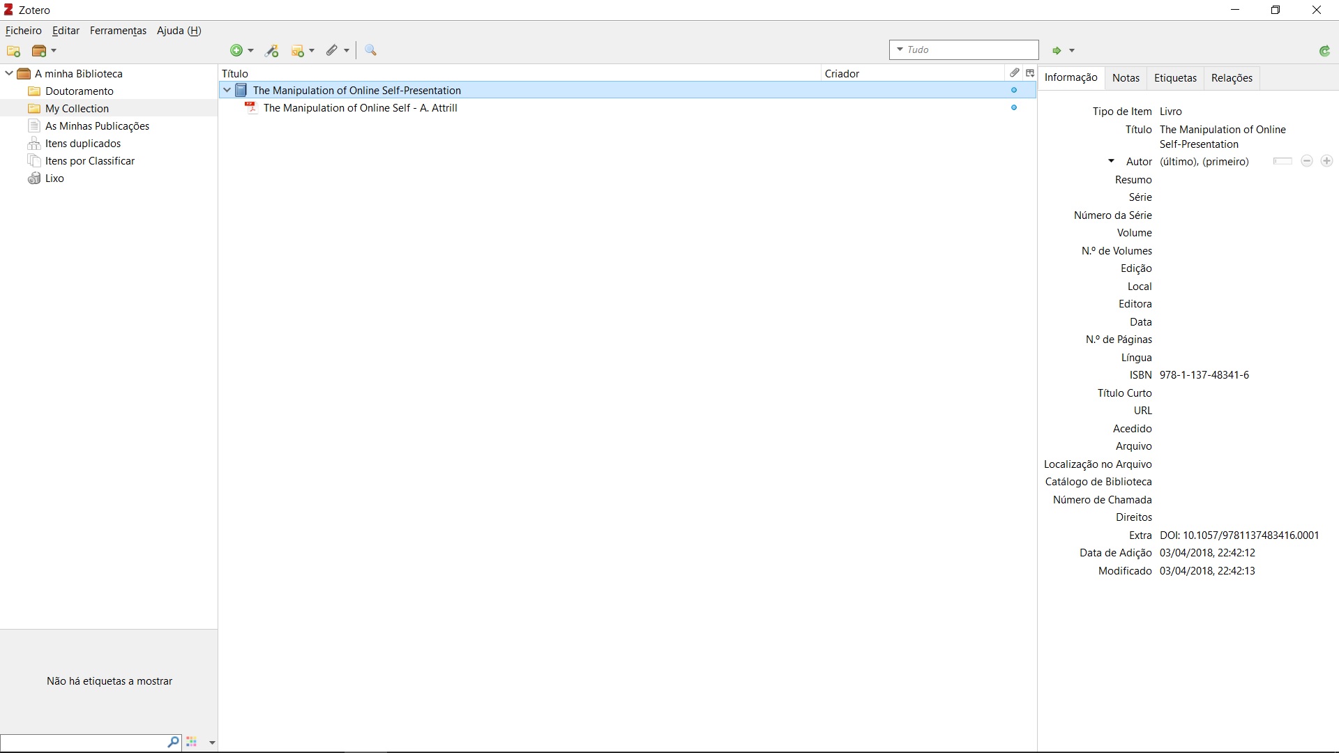

RIS records and goal
Hi there,
Did you see the picture i sent? It has a view of each thing I did.
First question's answer:
The RIS record type is the one present in the record I reproduced at the end of the reply (the one that works) and is "TY - BOOK".
Second question's answer:
The L1 tag adds the pdf file to the record, as you can see in the picture attached.
Finally, and maybe I should have stated this in the beginning, what I am trying to achieve:
  • I am a PhD student.
  • I "grabbed" near 4000 books from the internet.
  • I "passed" them through Calibre so I can have a good deal of metadata e the various fields, with correct ISBN, etc.
  • I would like to export them changing the name and the metadata, and ending with only one pdf file, instead of the three files (file+cover+metadata), so that I can import them to a reference manager (Endnote, Mendeley, Zotero) - !!!this is not working!!! So, instead, I am trying to export them from Calibre to Zotero with the pdf file attached. The thing is that your plugin works perfectly to export all the metadata but it misses the L1 (as you already justified why). So I was trying to solve it on my own, but I know nothing about programming.
  • Now I think that I can, after I add the files to Zotero, export them to Mendeley, add the feature that they have of identifying The TOC (Table of Contents) and in the end have a set of files with the correct ISBN, the Name of the File that I want, the several metadata and tags and TOC and start from there to analyse my bibliography and querying it, etc. Ultimately I want to add them to a content analysis software like MaxQDA or NVivo and start working on my thesis with a solid database.
  • Sorry for this.

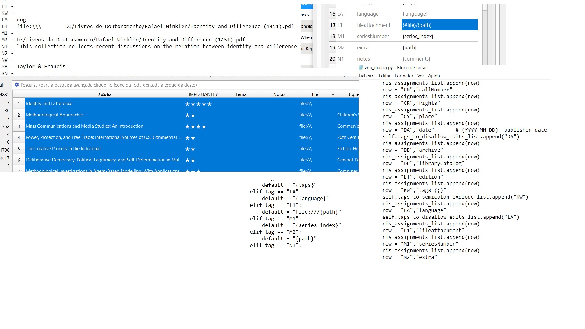

Expression for L1
Hi there DaltonST,
Besides the fact that I know little about this, I think i did not explain myself well, sorry.
When we are in the "ZMI: Export RIS" in the "L1" row how can i put an expression that goes like this:
"file:\\\"+"{path}"+"{filename}"
whereas
"file:\\\"
I turned it around and created a column in Calibre with the content "file:\\\" for all entries and it is called "file" and then I put {#file} in the "ZMI: Export RIS" and it returns in the RIS file after "L1 - " the expression "file:\\\"
"{path}"
Returns, as normal, the path of the file connected to each of the rows - but it doesn't return the filename. It just returns the path, without the filename
"{filename}"
I don't know how to ask Calibre for the filename. As well as path there must be an expression that returns the filename in Calibre.
So the problem is not in Zotero, maybe you are misreading it. The problem is that I cannot build a full expression that redirects Zotero to the actual file
I can build file:\\\ + {path} but it puts some spaces between the two expressions. And more than that I don't know how to complete it with the actual filename.
Sorry. Hope you can understand me.

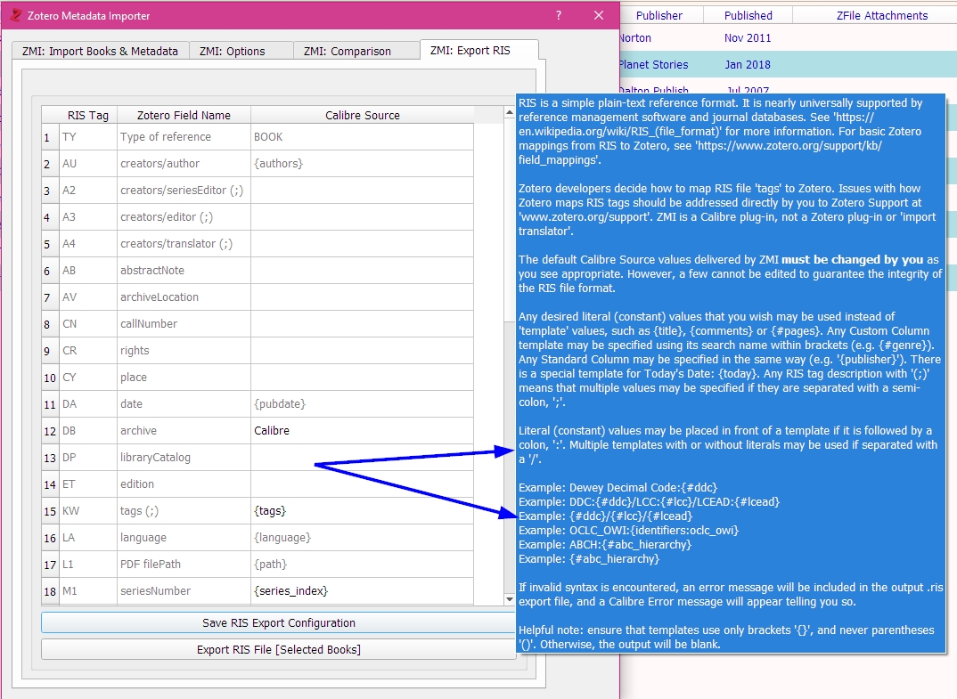

As I mentioned in my last post, you must read the ToolTips. It explains the syntax for the value fields. To combine 2 templates, you must separate them with a slash. Example: {#mysomething}/{#myotherthing}
Regardless, Zotero will not be redirected to the actual file because Zotero did not export the .ris file; it was created within Calibre.
Please read my prior post. What you are trying to do appears to be a waste of time for the reasons I stated.
I have tweaked the .zip file attached to the previous post. You should reinstall ZMI from that .zip file.
DaltonST

I know what you are saying. I did that. I read all the instructions. I join {#file}/{path}. It returns what I want but puts spaces between the expressions. But beside that I still need {#file}/{path}/{something that would return the filename from Calibre}.
Can we speak directly?
The Zotero works fine with the file you plugin/Calibre produces and with a file that was never inside zotero.
If I produce the RIS file with your plugin and then alter it manually to a file that zotero does not know it works.
