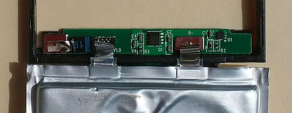

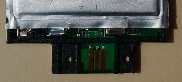

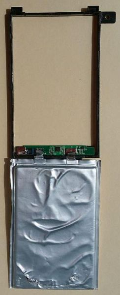

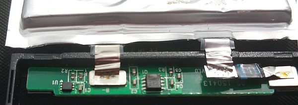

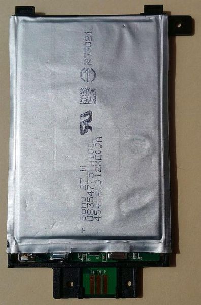

This is the battery from a PW3 (identical to that in my dead PW2, whose battery is now in my PW3), with the outer label peeled off, and the metal "tray" removed. It was inflated (like most dead LiPo batteries). I tore the foil pouch opening it. I hope the gases I inhaled were not TOO toxic.

Here is a cropped closeup from that the photo above, showing circuit details.
