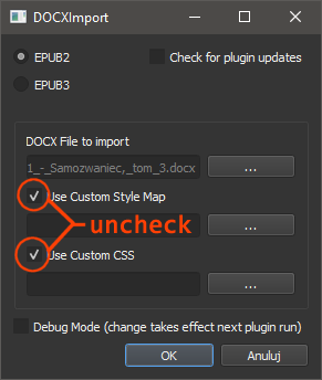

The problem occurs when you check the checkboxes for "Custom Style Map" and "Custom CSS" but do not select the appropriate files.
So first and foremost, UNCHECK all checkboxes.
BeckyEbook is offline   Reply With Quote
BINGO!
Thank you!
Kind regards,
Gunivortus
