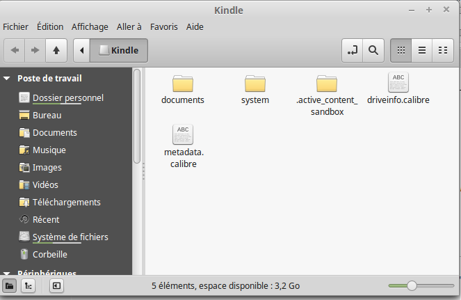

Maybe
Here is what I see

Maybe
Here is what I see
Yup--just drop the file right there--don't put it inside a folder.
