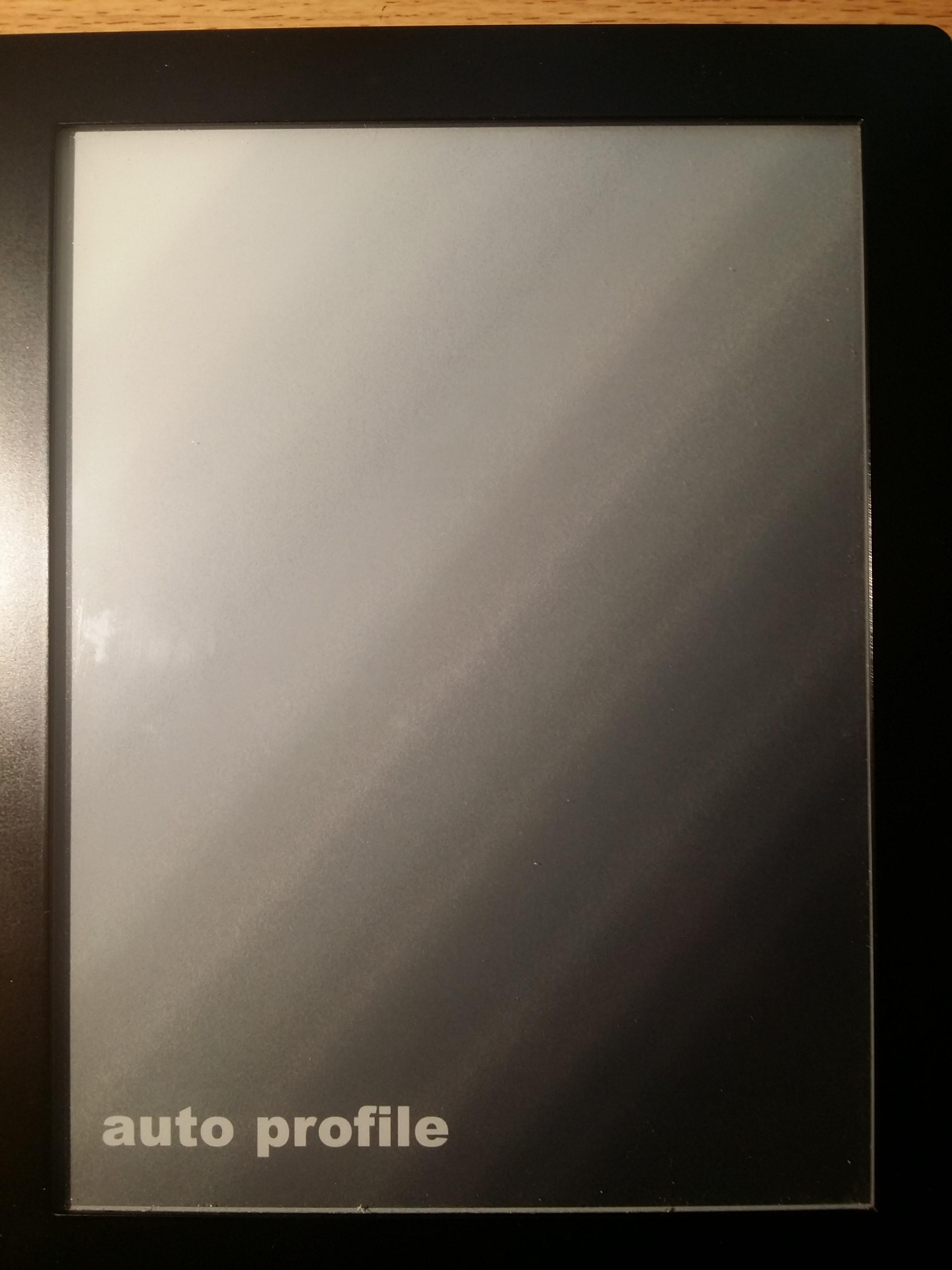

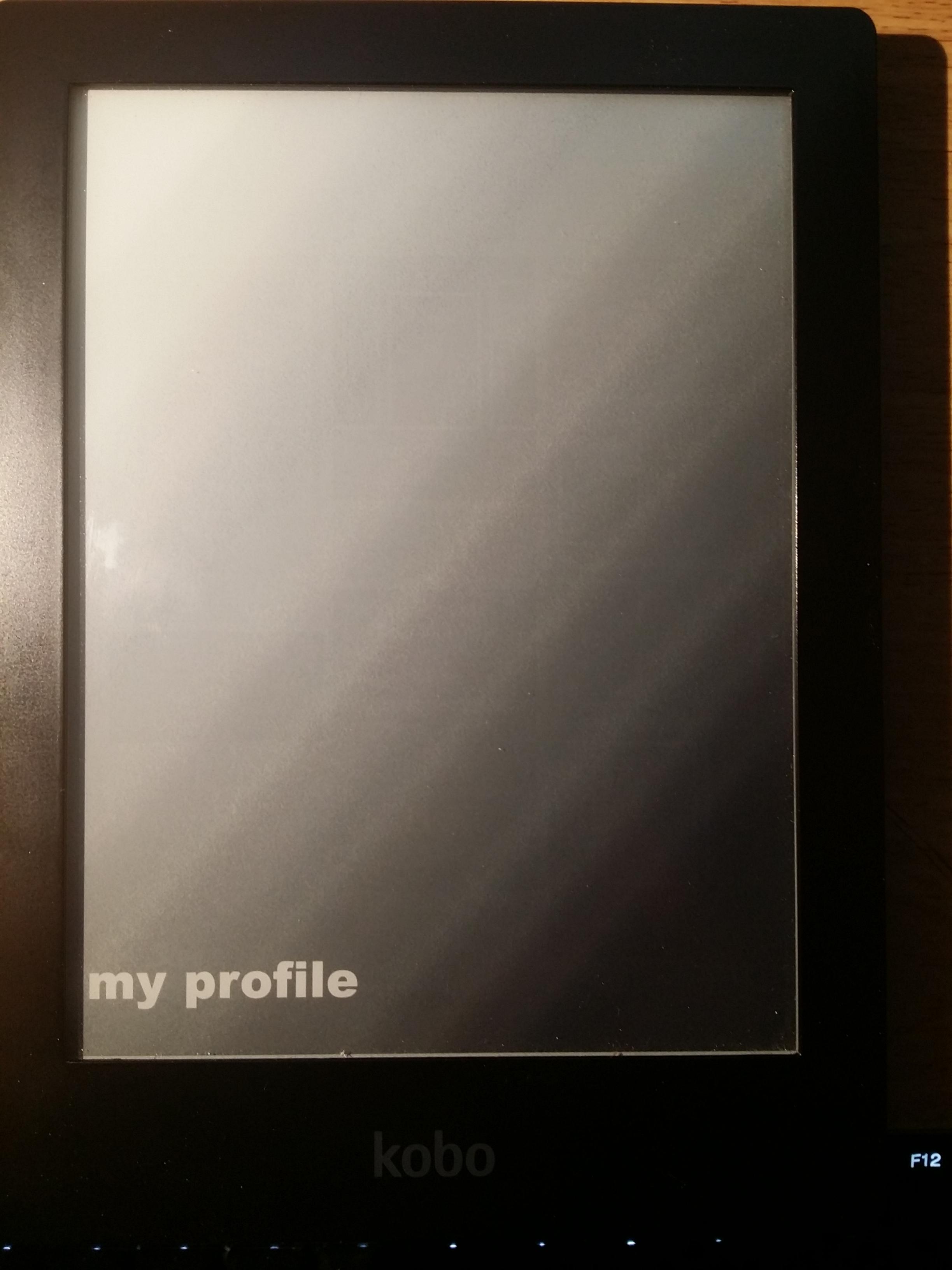

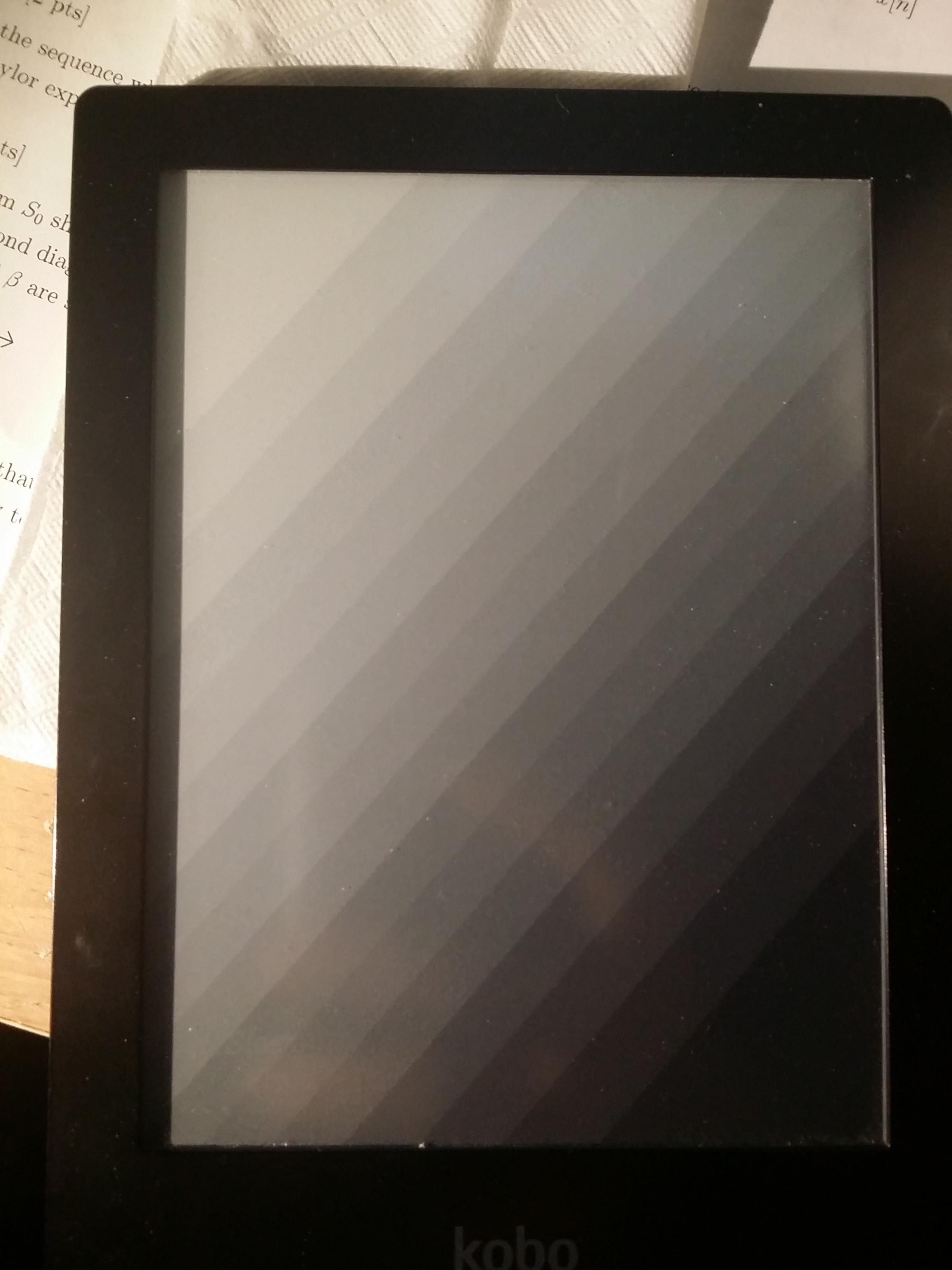

I used to have a kindle 3rd gen. Before it broke I almost perfected the art of creating wallpaper files. I made a custom PNG profile in photoshop to export as a greyscale with 8 levels, and I set each level manually once based on the kindles 8 level screen.
the Aura HD screen is listed as having 16 levels on wikipedia. I loaded a gradient from white to black (which I assume photoshop makes linear) as the only image and noticed that the kobo does not dither the image, but instead has a hard sampling a.k.a. quantization technique. I notice very equal spacing between each sample. If the original gradient is linear than the quantization is linear.
I applied a 2 different 16 level ditherings to the gradient with photoshop and loaded those images to inspect them.
one of the ditherings photoshop used its own algorithm.
for the other one, I manually chose the greys from 8-248 in steps of 16, so: {8,24,32,...,232,248}
I attached files for all of these examples.
my conclusion is that a linear levels for dithering is not ideal. there are uneven bands on the Aura HDs screen but not on my computer monitors from both dithered images.

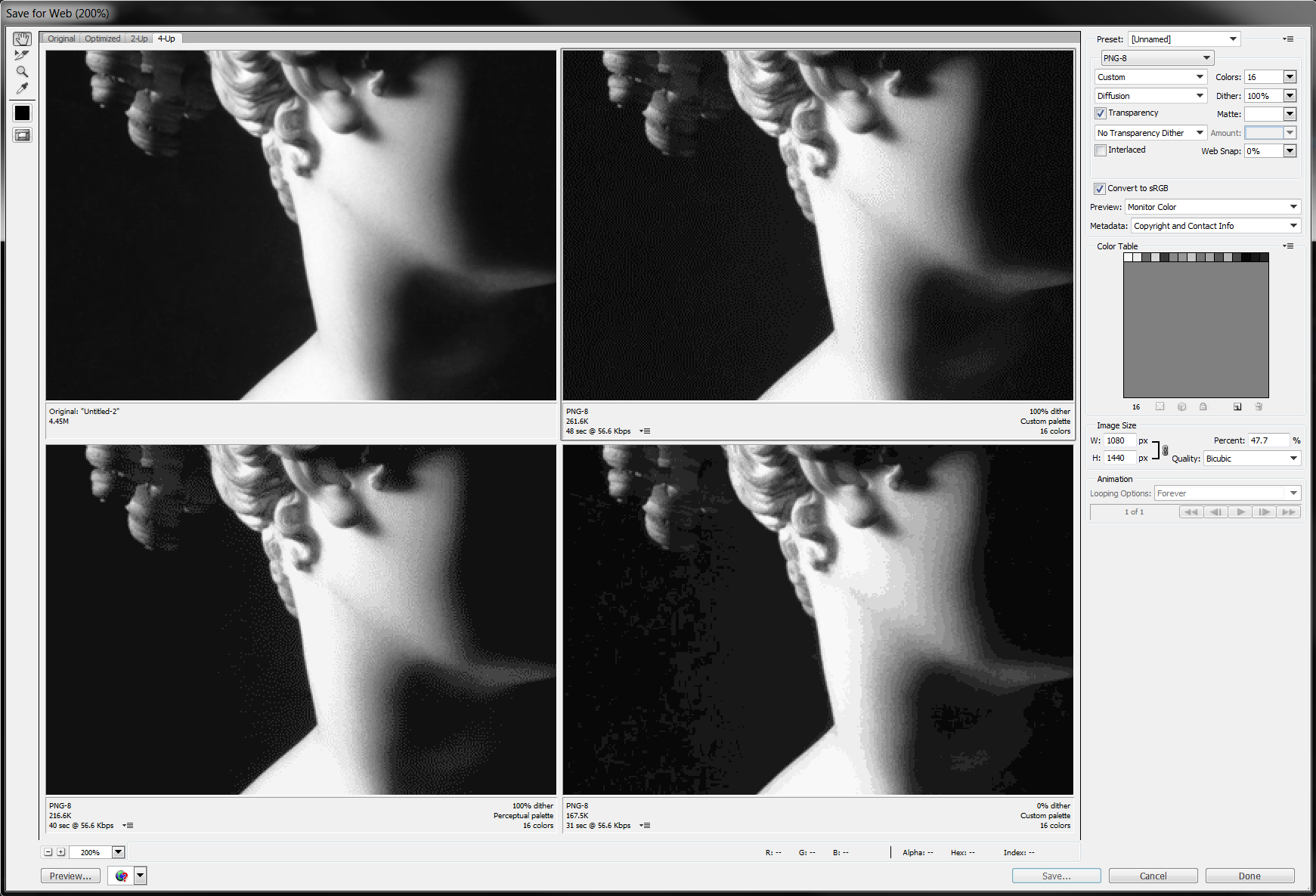

I will also share show I save my images.
I only use photoshop, perhaps there is an equivalent procedure in GIMP, I do not know.
-first I get a high res image of course,
-crop it to 3:4 ratio
-(edit) select auto contrast or use curves manually to get some clipping into the black and white
-sharpen if needed
-if it's a color image, I go to: image > adjustments > black and white. then I play with the presets until I find something I like and then maybe tweak it from there.
(this control can give significantly better results than simply desaturating)
-resize to 1080x1440
-file > save for web. then choose PNG-8, 16 colors, adaptive mapping, 100% dither.
-save
I have included a screenshot of some dithering comparisons
top left is the original image
top right is 100% dithered with my 16 level profile
bottom left is 100% dithered with an auto 16 level profile
bottom right is 0% dithered with an auto 16 level profile (somewhat how the aura hd would show the image itself based on the gradient test)
my profile does look better on the PC screen but if the results of the gradient test repeat then it might not translate to a better image on the aura. but the difference is negligible in a more detailed area anyway.

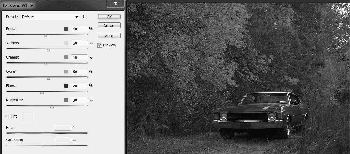

It's a damned good first post and that looks like a lot more detail work than my own images got.
I opened them up in paint.net, clicked 'Adjustments -> Black And White' which gave me an image that looked fine. Then I had a look at the sizing, decided what was important in the image and either resized or cropped then resized so that I had something about the right size for the screen.
If the ratio wasn't right I increased the canvas size with the current image at the center and then picked a colour for the new canvas around the image.

Does the black and white option have a way to adjust how bright each each color would be in the final image? because for some pictures with lots of colors it makes a world of difference. When I get home I will make a gif animation of one particularly striking example I found recently.
also your cropping method sounds a bit lengthy, in photoshop I set the ratio to 3:4 and put the vertical rectangle around what I want. press enter and that's it, the ratio is always perfect. I resize at the very end right before saving. I think this will maximize output quality.

I included 2 attachments, one is an animated gif showing the power of the black and white converter in photoshop. you can read the preset on the left. there is default which is mediocre, a few awful ones and a few good ones.
the other is the original color image, credit goes to an anonymous photographer.

there is one fatal drawback to Paint.net; when you save as a PNG, there is only "bit depth" to choose from. the lowest number of 8 is much too high. a 16 value grayscale is 4 bits. I would not use paint.net because of this limitation alone. It can work for very contrasty and sharp images like some of the ones lhommealenvers has in his folder.
The GIMP does have what I am looking for and I will list steps for conversion here:
* Play with the color curves and brightness/contrast. my method: the colors I want to be light, I make light. Same for dark.
* make other adjustments you wish to
* colors -> desaturate, and I use the luminosity setting because of my previous curves adjustments
* resize to 1440x1920, or whatever resolution you have.
after you adjusted everything you wanted do this step last:
* image -> mode -> indexed
*generate optimum palette: 16 colors (maybe less for older models? I know the kindle 3rd gen uses 8 levels)
(IMO the most important part: )
* color dithering: choose from any of the Floyd-Steinbergs. I do not see a difference in grayscale. 'Positioned' looks similar to 'patterned' in photoshop. this might work better for images with very fine (near pixel sized) noise that you want to keep
* save your image
the biggest benefit photoshop brings is how easy the black and white conversion is. it combines the many seperate steps that you need to do in paint.net and GIMP, if you really care about which colors appear bright in your final image. I think sometimes it really matters, as I hope you can see from my attachments. also photoshop has really easy and quick previews of the indexing and dithering, which it also forces to be a last step.
