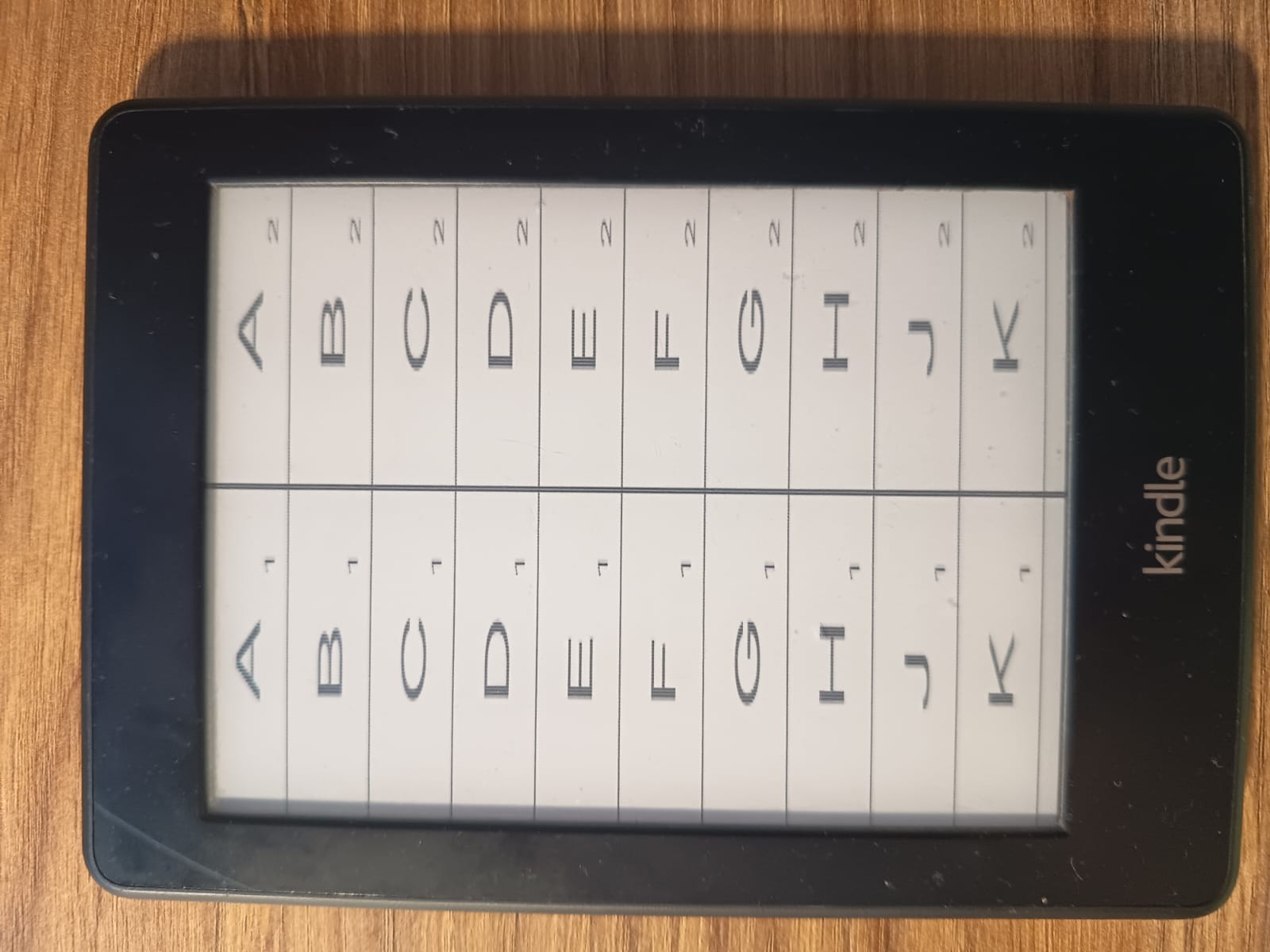

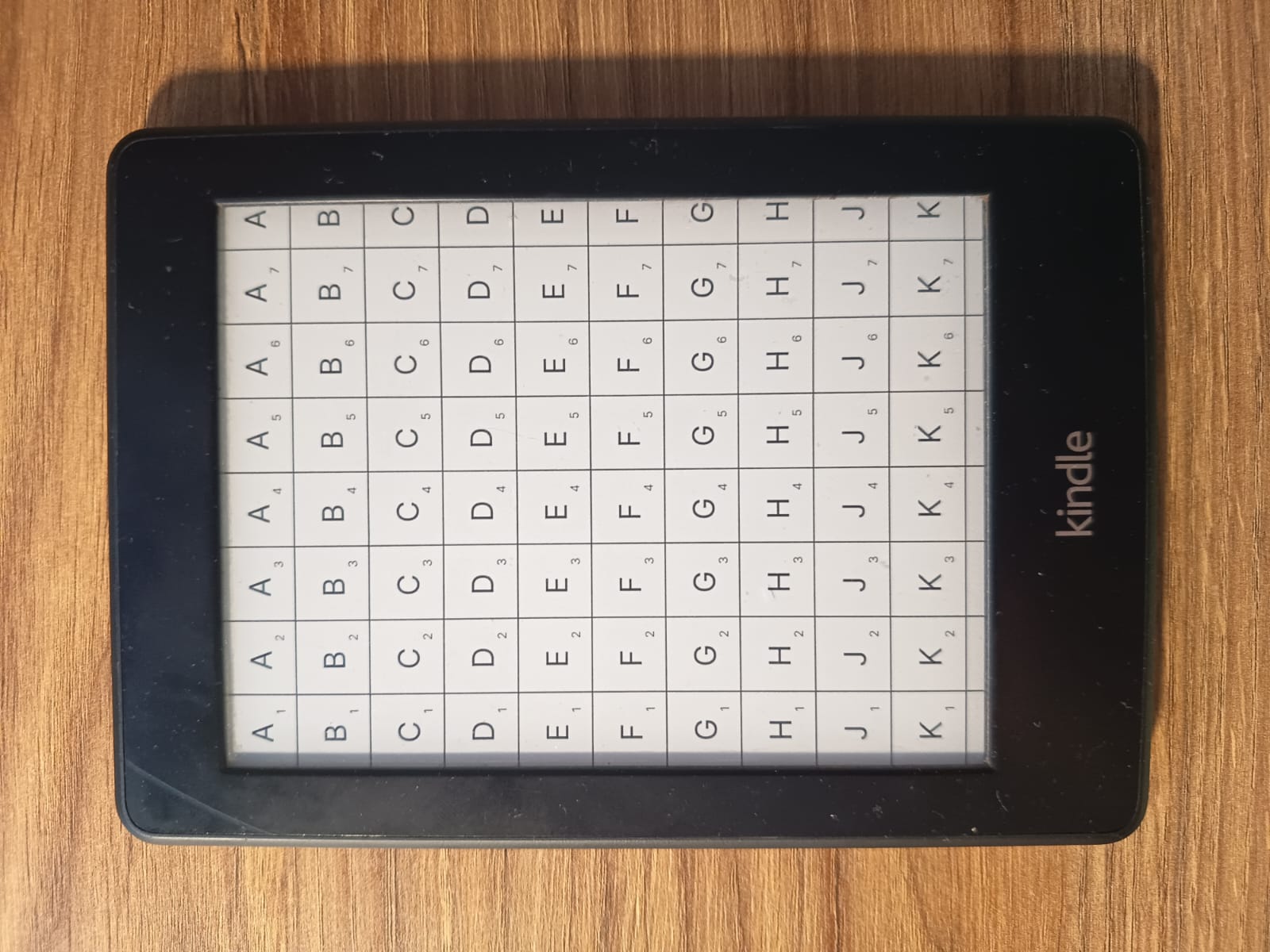

Thanks a lot for this, I've got it almost working and I hope you can help. So my Kindle (PW2 - 6th gen, DP75SDI) seems to be updating images from my server but it does distort them. When I update manually, or just put Kindle to sleep it looks good but just for a few seconds and then it distorts the image. When it updates itself from server it's distorted straight away and again when I put it to sleep it looks good just for a few seconds. I've attached photos of my test grid working and distorted (only horizontally).
I suspect it'll be something with resolution of my images? I've tried 758x1024 and 768x1024 px both with the same results. I did nothing special to images, just exported them out from Figma.
I'm nearly there, maybe I'm missing something?
Thanks!
ID:	218039   Click image for larger version

Oh, that's... interesting. The script just uses "eips" to update the image - info here: https://wiki.mobileread.com/wiki/Eips - syntax is "eips -f -g {imagefile}".
A fair bit has been said about the PNG format sent to the Kindle. The HA Kindle screensaver add-on (separate from my extension) has this to say:
https://github.com/sibbl/hass-lovela.../main/index.js - near the bottom, lines 302-326
It indicates the PNG output to be greyscale, bit depth 8 (that is actually somewhat unusual these days - creating a greyscale PNG specifically using 8-bit coding), with dithering and various other transformations that apply to the image, not the file format. With that, the missing piece may simply be to make it an 8-bit PNG, whereas most PNG output today is 24-bit color or higher.
Not sure if that's the whole problem, though. Rendering it twice is oddly suspicious, but one render could be coming from "linkss" rendering (which may be smarter), with a duplicate coming shortly behind it by the "eips" renderer called by the script.
If rendering it as an 8-bit PNG doesn't improve things, maybe upload an example file?
