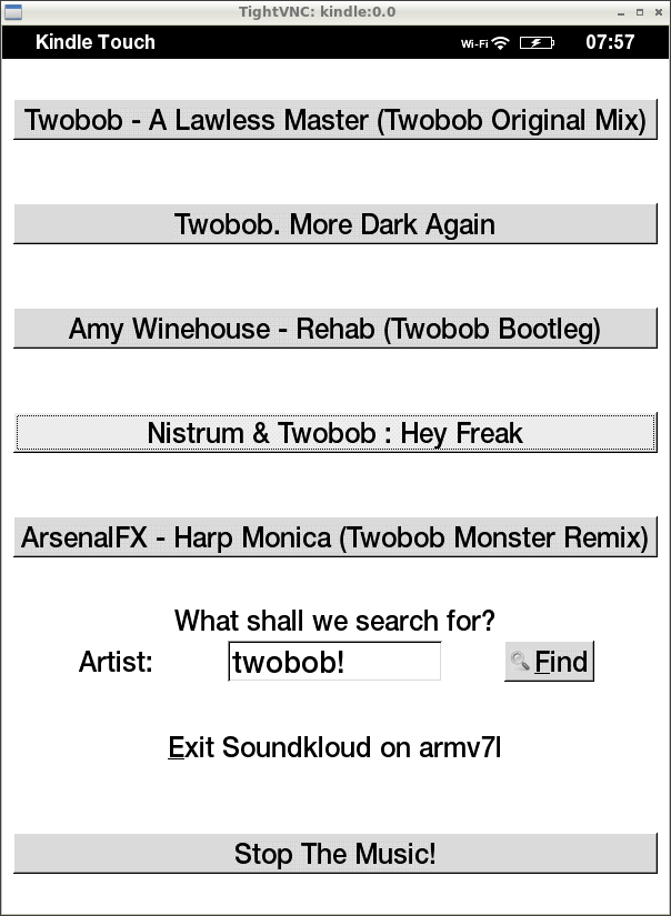

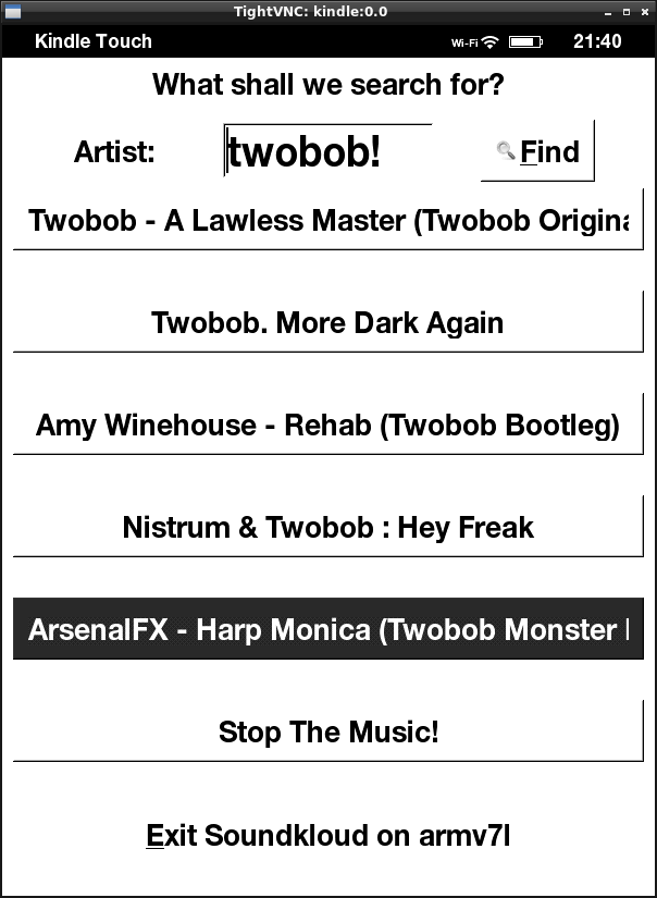

okay so... to get this working on as many devices as we can:
The gui is the issue. since on the 3 the level of separation of the kindlet from the python layer makes handling updated files require some home-brewed methods of file watching.
It's also tricky to test locally. As the gui won't "run" on a pc, without wrapping it in something (the snake game amongst others does actually have examples of this)
so - to recap - I don't want to do it as a kindlet. I will repurpose this code to be a launcher for the Gnuboy games on the 3 perhaps.
So what do we use? And how do we get around the separation from python.
One thought would be to implement a pure c interface to the soundcloud API. as it happens someone did this a few years back - hopefully the code isn't too rotten. It was...
That would require -loauth -lssl -lcrypto support.
So, to that end, I saw about building a liboauth with buildroot last night. and am playing with getting the buildroot libraries and resources available to the Toolchain.
so far I have
CFLAGS="-U_FORTIFY_SOURCE -fno-stack-protector -O2 -fno-finite-math-only -ffast-math -march=armv6j -mtune=arm1136jf-s -mfpu=vfp -pipe -fomit-frame-pointer -fPIC" /opt/arm-2007q3/bin/arm-none-linux-gnueabi-gcc test.c -o test `~/GIT/buildroot-2012.03/output/host/usr/bin/pkg-config gtk+-2.0 --cflags` -L~/GIT/buildroot/output/host/usr/arm-unknown-linux-gnueabi/sysroot/lib/ -L./lib/ -lgtk-directfb-2.0 -lgdk-directfb-2.0 -lgdk_pixbuf-2.0 -lpangocairo-1.0 -latk-1.0 -lcairo -lpixman-1 -lpng12 -lgio-2.0 -lpangoft2-1.0 -lpango-1.0 -lfontconfig -lfreetype -lz -lexpat -lgobject-2.0 -lgmodule-2.0 -lgthread-2.0 -lglib-2.0 -ljpeg -ldirectfb-1.2 -lfusion -ldirect-1.2 -loauth -lssl -lcrypto -lcrypto1 -I./usr/include -I./usr/include/directfb
which does actually build now on the PC at least. however.. the use of the directFB calls and oauth does mean for now this nerfs my local testing. Therefore I will carry on building the Touch version and simply backport the code to the 3 when happy.
Thus allowing for local testing.
Just thought I should share the the project isn't entirely stalled. just in a holding pattern while we get the ui sorted.

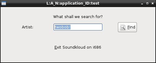

and to test it locally
~/k3-dev $ CFLAGS="-fno-stack-protector -O2 -fno-finite-math-only -ffast-math -pipe" gcc test.c -o test `pkg-config gtk+-2.0 --cflags --libs`-I./usr/include -I./usr/include/directfb
works fine now

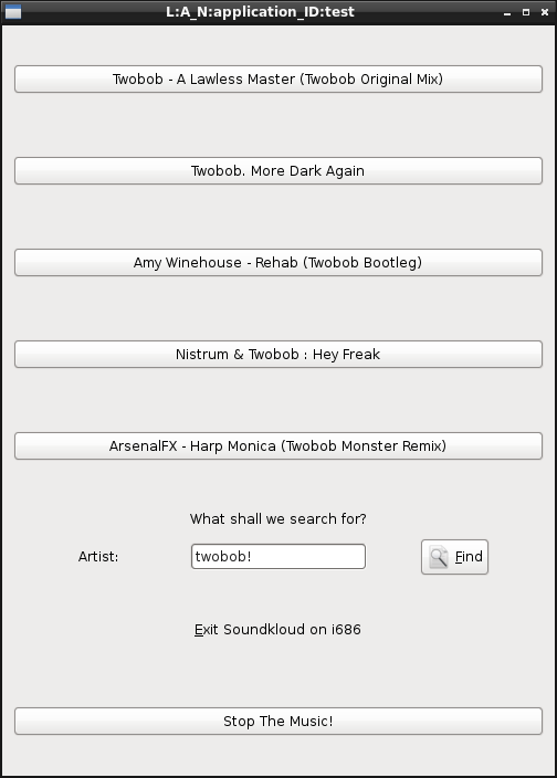

and one for me http://www.gtk.org/api/2.6/gtk/gtk-General.html oh and http://ehuss.net/shared/ since I am having to re write that windows specific c-soundcloud library - ho hum
EDIT: Okay I think I got the library rewritten enough to build under linux, linked and running on the PC. next up test it doesnt explode a kindle and then invoke some methods.
I successfully instantiated an instance of the Kloud Api object before concluding testing for the night. seems to work okay.
EDIT: But it blows up on transferring data and wont play nice on my other kindle.
Will investigate reintegrating python via c. if it aint broke...

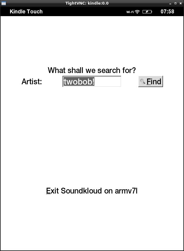

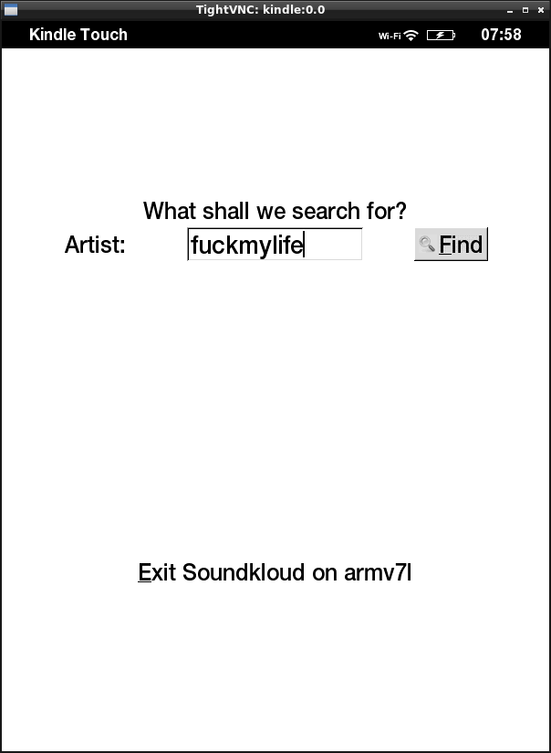

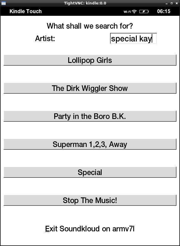

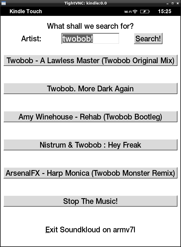

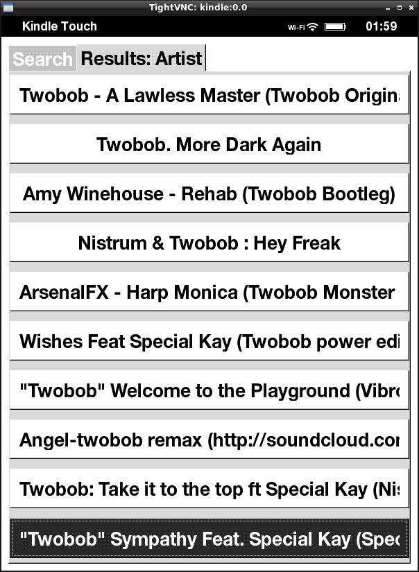

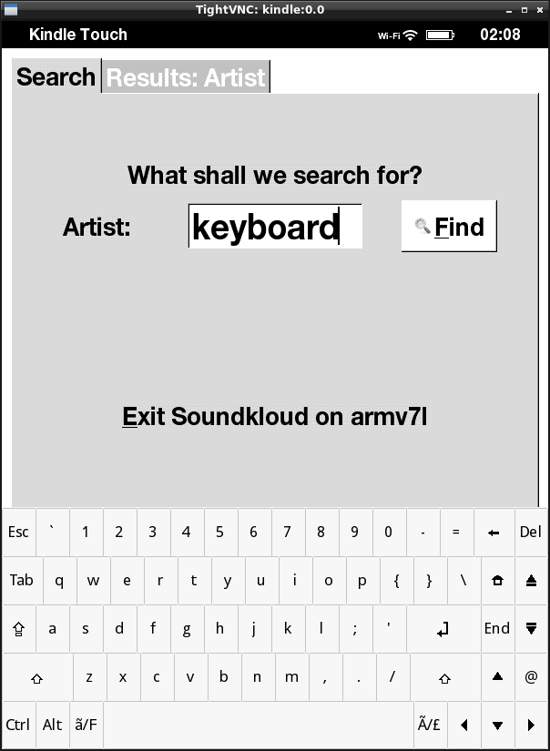

ah well. back to testing on the Touch then now it works too

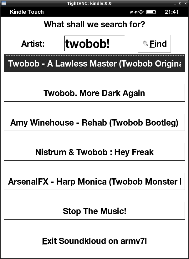

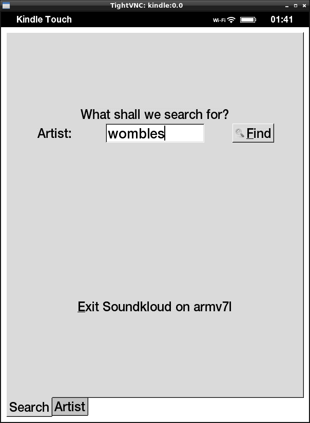

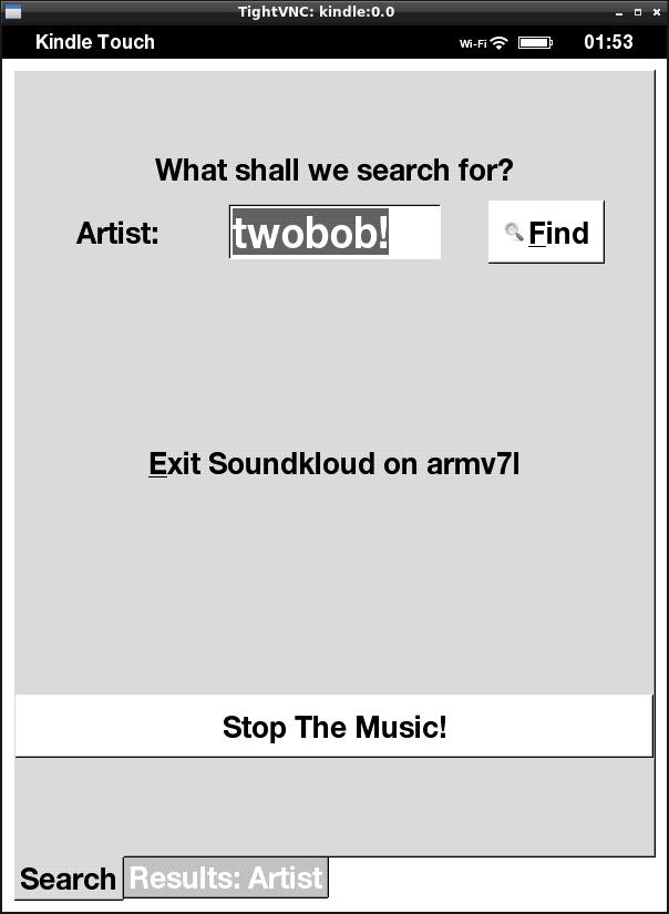

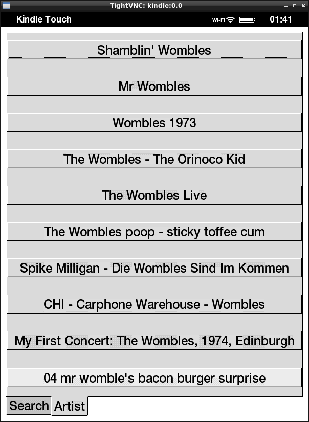

Assuming we are still going to use mplayer we should probably look at:
http://www.mplayerhq.hu/DOCS/tech/slave.txt
which means we probably want to pump a fifo? maybe?
http://developer.gnome.org/glib/stab...-Channels.html
someone else was doing this IIRC. feel free to chip with some tips about controlling mplayer remotely.
I have the gtk main loop running (needs extending with events), I have forked data, I have mplayer, just need a bit of time...
Here was an interesting thing I found: "GtkWorker (Python recipe)"
http://code.activestate.com/recipes/521881/

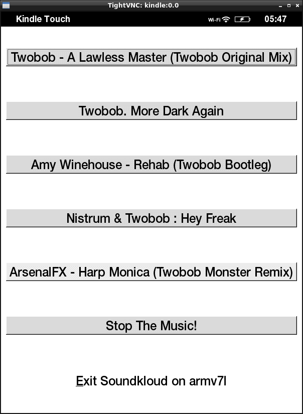

Notes on fixing the menus popping up in a new window each time
http://stackoverflow.com/questions/1...gnal-is-emitte

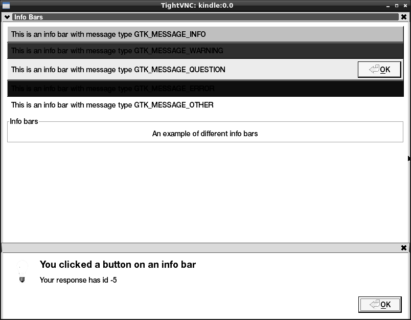

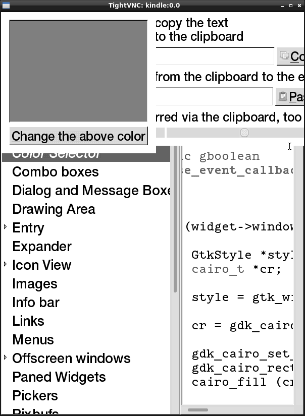

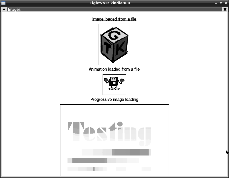

Old 12-24-2012, 07:52 PM   #140
twobob
( ͡° ͜ʖ ͡°){ʇlnɐɟ ƃǝs}Tır
twobob's Avatar
Posts: 6,586
Karma: 6299993
Join Date: Jun 2012

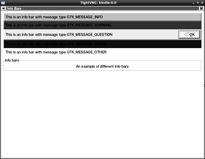

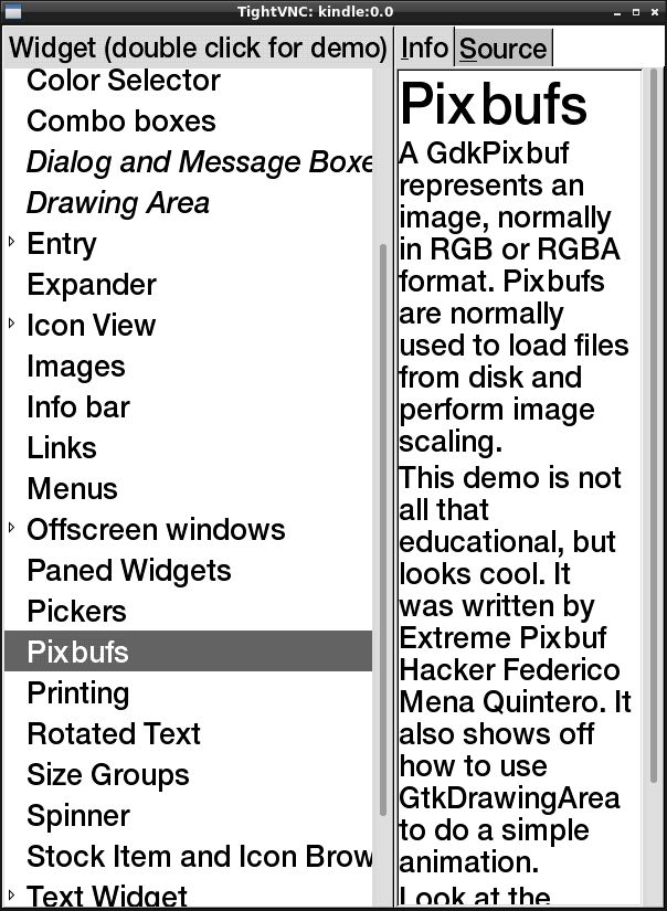

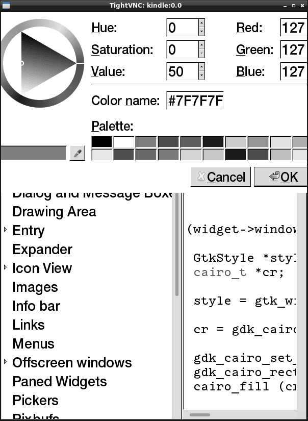

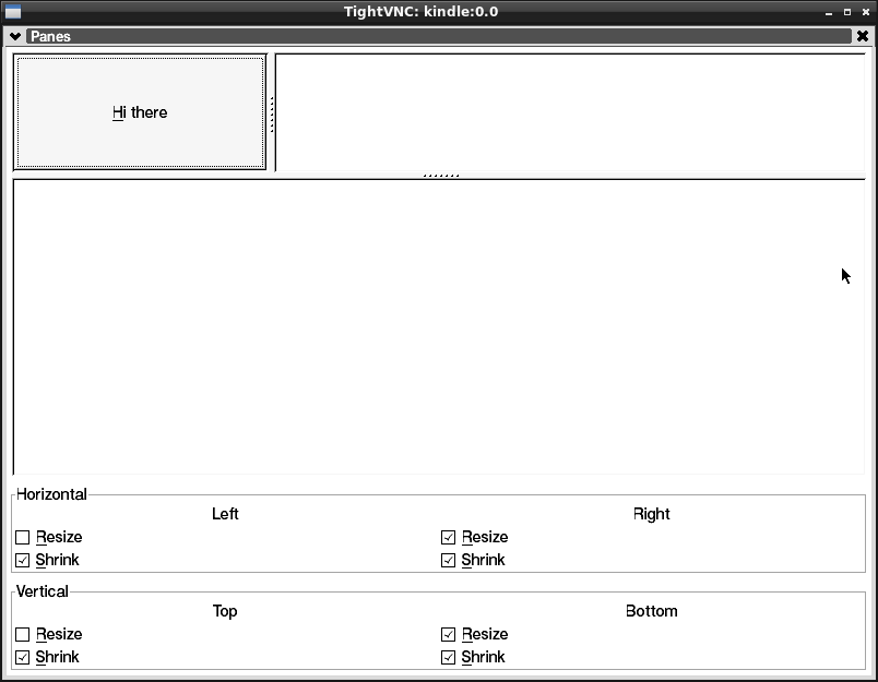

above display was of http://git.gnome.org/browse/gtk+/tree/demos/gtk-demo
(ref: http://www.gtk.org/api/2.6/gtk/gtk-General.html and http://developer.gnome.org/gtk-tutorial/stable/)
to actually invoke the individual demos one would http://stackoverflow.com/questions/2...-run-gtk-demos
another interesting snippet of code for another project.
Calling https://trac.webkit.org/browser#releases/WebKitGTK (http://webkitgtk.org/?page=download)

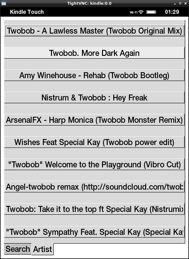

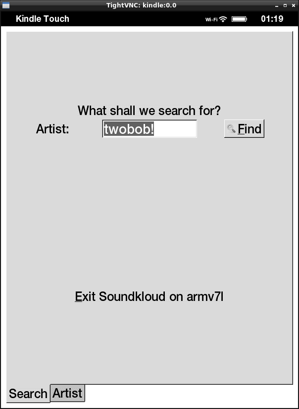

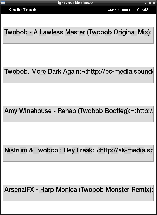

Old 12-24-2012, 09:16 PM   #141
twobob
twobob's Avatar
Posts: 6,586
Karma: 6299993
Join Date: Jun 2012

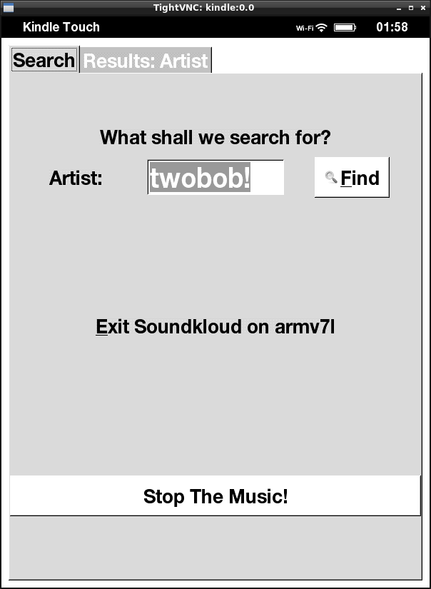

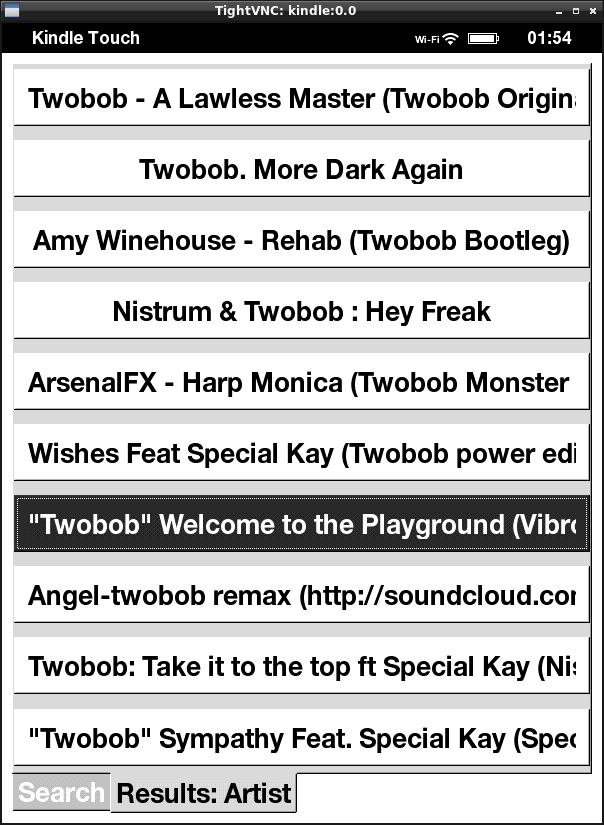

Why the menus look horrible...
It is important to make the distinction between what GTK+ controls and what the window manager controls. You are able to make recommendations and requests for the size and placement of top-level widgets. However, the window manager has ultimate control of these
features.
Conversely, you can use GTK_WINDOW_POPUP to create a pop-up window, although its name is somewhat misleading in GTK+. Pop-up windows are used for things that are not normally thought of as windows, such as tooltips and menus. Pop-up windows are ignored by the window manager, and therefore, they have no decorations or border frame.
There is no way to minimize or maximize a pop-up window, because the window manager does not know about them. Resize grips are not shown, and default key bindings will not work.
GTK_WINDOW_TOPLEVEL and GTK_WINDOW_POPUP are the only two elements available in the GtkWindowType enumeration. In most cases, you will want to use GTK_WINDOW_TOPLEVEL, unless there is a compelling reason not to.
Note You should not use GTK_WINDOW_POPUP if you only want window manager decorations turned off for the window. Instead, use gtk_window_set_decorated (GtkWindow *window, gboolean show) to turn off window decorations.

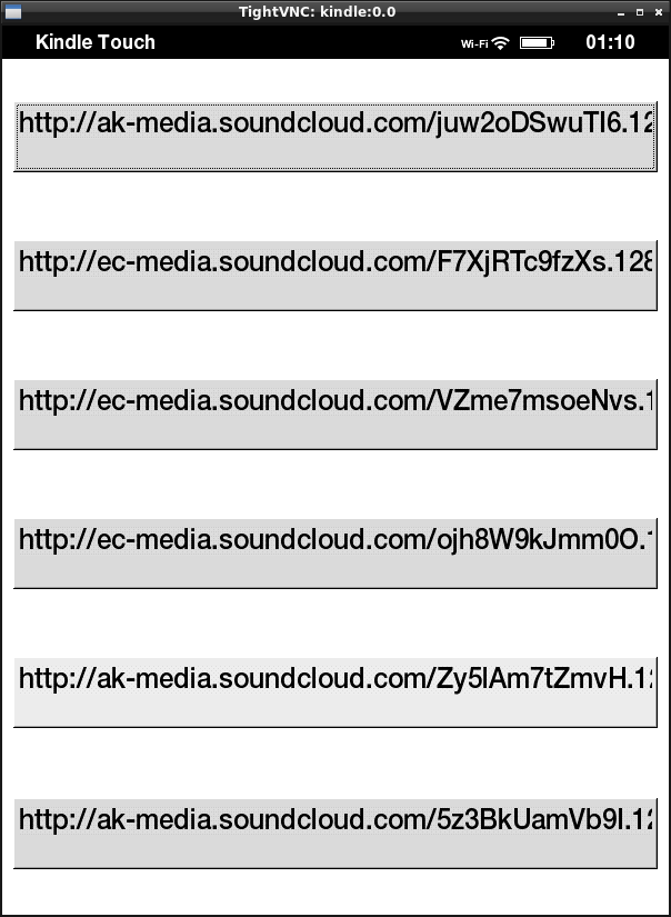

Code to start splatting stuff back into gtk into helpful pieces...
#!python
# encoding: utf-8
# encoding declaration as specified here http://www.python.org/dev/peps/pep-0263/
import soundcloud
import subprocess
import sys
import os
from time import sleep
import random
# create client object with app and user credentials
client = soundcloud.Client(client_id='8c882aabb8d9314021b236a291cd874c',
                           client_secret='blahbebalh')
tracks = client.get('/tracks', q = sys.argv[1], limit=5,filter="streamable")
generator = random.Random()
i = 1
temp = {} #initalize dictionary
for track in tracks:
#  temptrk =  u'[{2}] Title: {0}\n ID: {1}'.format(track.title.encode('utf-8'), track.id, i)
    titleage = track.title.encode('utf-8')
    tempy = titleage+'\n'
    temp.update({i:track.id}) #set dictionary key
    i=i + 1
  #  print tempy
#Let's just play the last one for now
#return full list of links
for listing in range(1,i):
	queryb = listing
	trackid = temp.get(queryb) #retrieve key
	track = client.get('/tracks/{0}'.format(trackid))
	#tempart = "Artist: {0}\nDuration (in secs): {1}".format(track.user.get(u'username'), (track.duration/1000))
	temptitle= track.title.encode('utf-8')
	stream_url = client.get(track.stream_url, allow_redirects=False)
# this next bit actually gets returned.
	print "{0}¬{1} &".format(temptitle,stream_url.location)
#print "Track Loading complete"
Thoughts on delimiters. and why we have chosen ¬
DELIMS:
Excluded US-ASCII Characters disallowed within the URI syntax:
control = <US-ASCII coded characters 00-1F and 7F hexadecimal>
space = <US-ASCII coded character 20 hexadecimal>
delims = "<" | ">" | "#" | "%" | <">
unwise = "{" | "}" | "|" | "\" | "^" | "[" | "]" | "`"
reserved = ";" | "/" | "?" | ":" | "@" | "&" | "=" | "+" | "$" | ","
for base64 the valid charset is:
ABCDEFGHIJKLMNOPQRSTUVWXYZabcdefghijklmnopqrstuvwx yz0123456789+/
the = is used as filler for the last bytes, as the length must be mulitple of 3
Okay long story short - I got it all working again. but this time with no stupid lag or asynchrous menuing (well, so far) attached final pic of working playback menu.
next up.. searching.
Name:	TightVNC: kindle:0.0_092.png
ID:	98261   Click image for larger version
Name:	TightVNC: kindle:0.0_094.png
ID:	98263   Click image for larger version
Name:	TightVNC: kindle:0.0_095.png
Old 12-27-2012, 02:19 AM   #142
twobob
twobob's Avatar
Posts: 6,586
Karma: 6299993
Join Date: Jun 2012
heh. a search box. and mainly working playback.
progress...
thanks qlob for chatting over the options with me. helpful.
Name:	TightVNC: kindle:0.0_096.png

Old 12-28-2012, 04:01 AM   #146
twobob
twobob's Avatar
Posts: 6,586
Karma: 6299993
Join Date: Jun 2012
some progress.
still getting used to chucking the widgets around in events.
needed some refactoring but in the main moving along.
nice to test locally.
Name:	TightVNC: kindle:0.0_098.png
ID:	98297   Click image for larger version
Name:	TightVNC: kindle:0.0_101.png
ID:	98298   Click image for larger version
Name:	TightVNC: kindle:0.0_100.png
ID:	98299   Click image for larger version
Name:	TightVNC: kindle:0.0_102.png
ID:	98300   Click image for larger version
Name:	TightVNC: kindle:0.0_103.png
ID:	98301   Click image for larger version
ID:	98302   Click image for larger version

Old 12-28-2012, 12:15 PM   #149
twobob
twobob's Avatar
Posts: 6,586
Karma: 6299993
Join Date: Jun 2012
Originally Posted by twowheels View Post
Whoops!! I was joking due to its lack of audio capabilities! Even though I'm a software developer and might be capable, I have nowhere near anything resembling free time!
Heh. just playing wid ya.
Whilst it is indeed audio nerfed honestly think it could work on the PW.
Figured you were just joshing with us. No qualms.
"free time": hmmm...
"time" human construct designed to make trains/workers/slaves work punctually.
"free" human construct designed to describe the state of being before time became such an issue.
You know what? your probably better off without it
Old 12-28-2012, 09:43 PM   #150
twobob
twobob's Avatar
Posts: 6,586
Karma: 6299993
Join Date: Jun 2012
more progress.
Tabbed search and results page to get around horrible widget destruction issues.
meh I hate it when pointers go out of scope.
Anyways....
Issues fixed: Huge load lag. This (soundcloud-based) delay has been shifted more properly to the search method.
Results not being displayed properly. (no more stupid duplicates)
Currently Needs addressing:
Can only search on artist. (but the python is nice and separate and can be very easily extended, there is provision for multiple-named scripts also)
Some results oddly wont play and return a 403... could be duff filters. will test on the PC.
moving along slowly though
Oh yeah and we also need to get http://www.gtk.org/api/2.6/gdk/gdk-Input-Devices.html working for the 3...
Artists featured so far:
Name:	TightVNC: kindle:0.0_106.png
ID:	98347   Click image for larger version
Name:	TightVNC: kindle:0.0_108.png
ID:	98348   Click image for larger version
Name:	TightVNC: kindle:0.0_110.png
ID:	98349   Click image for larger version
Name:	TightVNC: kindle:0.0_111.png
ID:	98350   Click image for larger version
Name:	TightVNC: kindle:0.0_112.png
ID:	98351   Click image for larger version
Name:	TightVNC: kindle:0.0_113.png
ID:	98352   Click image for larger version
Name:	TightVNC: kindle:0.0_114.png
ID:	98353   Click image for larger version
Name:	TightVNC: kindle:0.0_115.png
ID:	98354   Click image for larger version
Name:	TightVNC: kindle:0.0_116.png
