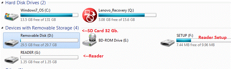

Last week I bought new device in Belgium. Firmware version is 1.0.04.11081. When I am trying to run jailbreak I can see the following messages on a screen:
C:\Reader\rupor-jailbreak>flash_reader.bat
Volume in drive D has no label.
Volume Serial Number is 420A-13E9
Continue? <Y/N> Y
.\OS Firmware\files\new.mmcblk2p2.img
.\OS Firmware\files\new.mmcblk2p2.md5
.\OS Firmware\files\update.img
.\OS Firmware\files\update.img.sig2
4 File(s) copied
Sony Reader MSC utility 1.07 (c) 2012 Igor Skochinsky, Vladimir Boroda
avail: 1
openDrive [\\.\D:]: 1
usbInitCheck: 0
Press any key to continue . . .
After reboot device doesn't show update screen and just starting. I am using 32 Gb SD card. Could it be a problem?
User0296 is offline   Reply With Quote

User0296
Are you sure that drive D: is actually SD card in the reader you are trying to jailbreak?
rupor is offline   Reply With Quote
Old 02-12-2013, 04:28 AM   #145
User0296
User0296 began at the beginning.
Join Date: Feb 2013
Device: PRS-T2
Yes, I am sure, because after format in reader SD card doesn't have label.
D:\>dir
Directory of D:\
08.02.2013 12:12 <DIR> Sony_Reader
08.02.2013 12:57 245 driveinfo.calibre
08.02.2013 12:53 7*031 metadata.calibre
07.02.2013 23:59 <DIR> OS Firmware
2 File(s) 7*276 bytes
2 Dir(s) 31*683*969*024 bytes free
