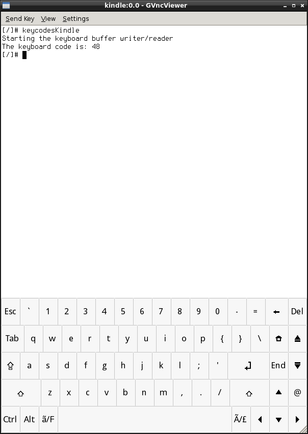

EDIT:
tested as working on the k5
built: me@dev ~/GIT $ g++ -o keycodesKindle ./keycodes.cpp

So. Yep works. Seemingly

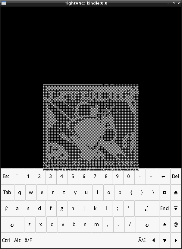

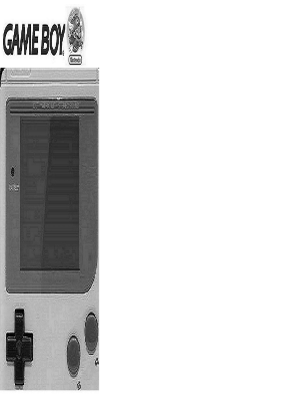

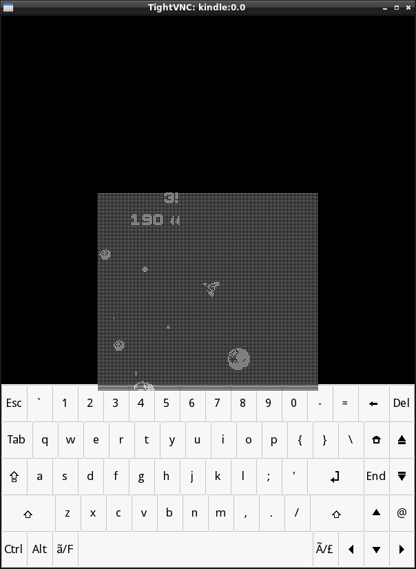

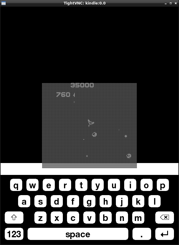

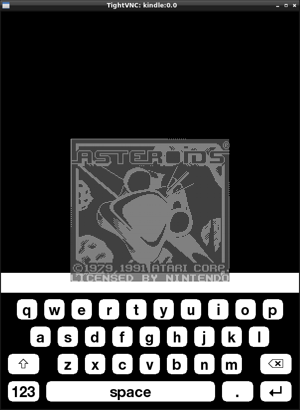

further to this...
still "unworking" but pictured options.

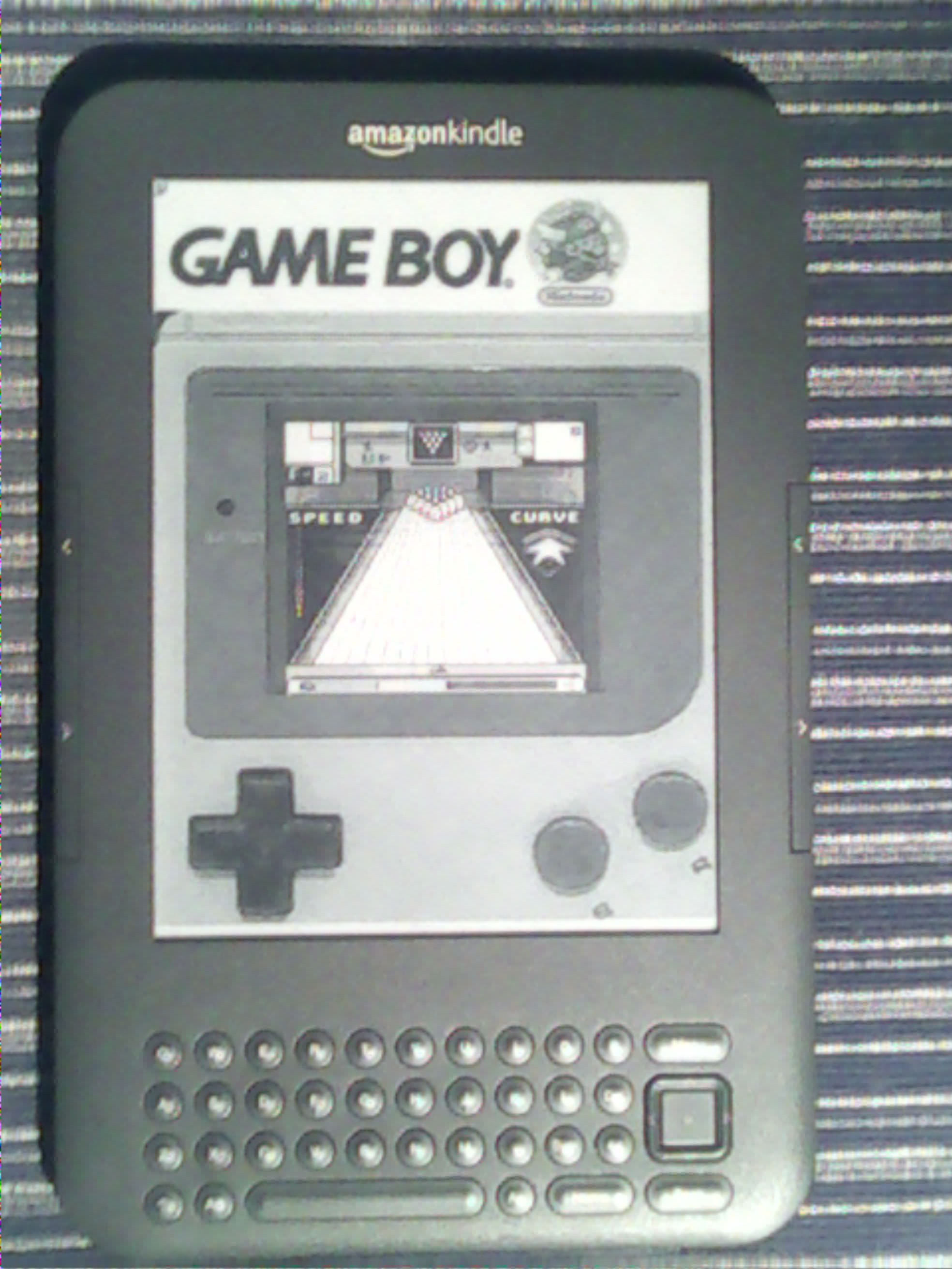

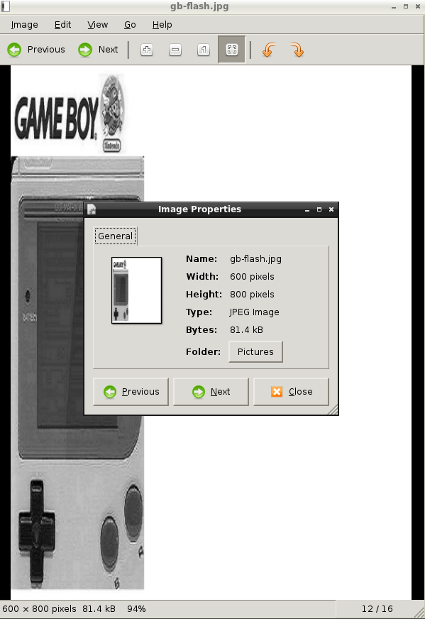

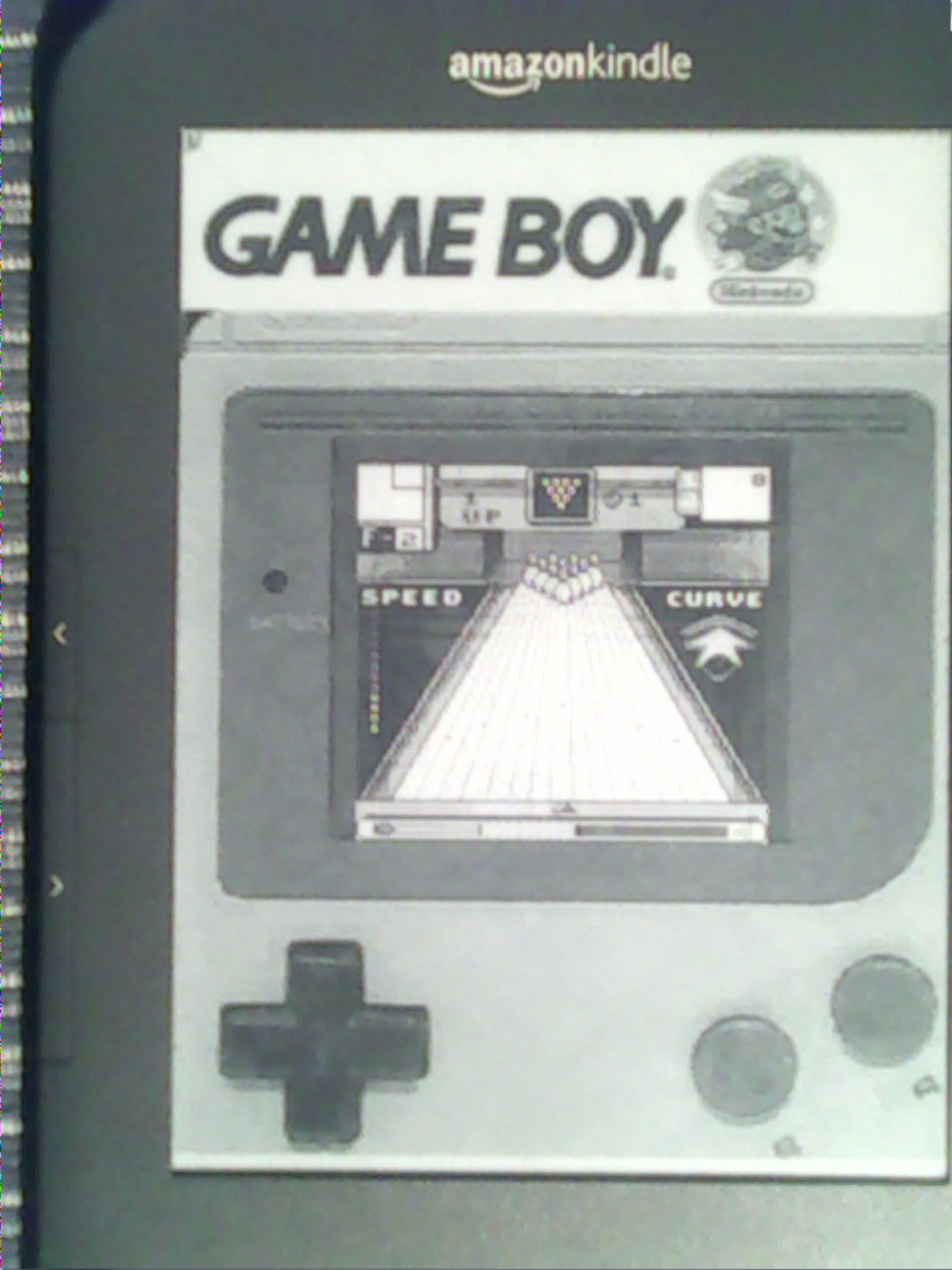

Okay so I got it as a simple script.
should be the size as pictured in second screenie.
/mnt/us/usr/bin/run-game (or something)
#!/bin/sh
# draw pattern
eips -p
sleep 1
#draw picture frame
eips -g /mnt/us/usr/bin/pictures/gb-flash.jpg
sleep 1
fbgnuboy ./rom/$@ 2> /mnt/us/gnuboy.log
or the old favourite (THIS SCRIPT ASSUMES /mnt/us/fbgnuboy for the game engine and /mnt/us/fbgnuboy/roms for the games locations!!!)
I high-lighted all the location calls so you can check you have them right...
#!/bin/sh
# getkb - get translated ascii keys from K3 keyboard
# v1.2 by geekmaster
# STDOUT: pressed keys, until Enter key pressed.
getkb() {
eips -z 2 38 # scroll
XP=0
YP=39
DN=/dev/null
KN="1234567890____qwertyuiop____asdfghjkl_____zxcvbnm_."
KS="1234567890____QWERTYUIOP____ASDFGHJKL_____ZXCVBNM_,"
KP="1234567890____~@#$%^&*()____<>[]{}?/\_____;:'|-+=_?"
KM=$KN
ST=""
while :;do
eips $XP $YP "$ST""_ "
L="_"
set $(waitforkey); K=$1 D=$2
[[ $D -eq 0 ]]&& continue
# [[ $K -eq 28 ]]&& break # enter
[[ $K -eq 190 ]]&& break # use Aa for enter
[[ $K -eq 14 ]]&& ST="$(echo ${ST%?})" && continue # del
[[ $K -eq 42 ]]&& KM=$KS && continue # shift
[[ $K -eq 126 ]]&& KM=$KP && continue # Sym
[[ $K -eq 57 ]]&& L=" " # space
[[ $K -le 52 ]]&& L="$(echo \"$KM\"|cut -b$K-$K)"
# [[ "$L" == "_" ]]&& L="($K)"
[[ "$L" == "_" ]]&& continue
# echo -n "$L"
ST="$ST$L"
KM=$KN
done
echo "$ST"
putei() {
st=$1
ii=${#st}
while [ $ii -ge 0 ]
do
eips 0 39 "$(echo $st | cut -b-50)" # write to the bottom
st="$(echo $st | cut -b51-)"
ii=$(( ii - 50 ))
done
killall -stop cvm launchpad 2> /dev/null
cd /mnt/us/fbgnuboy
eips -c;
putei "fbgnuboy - Games Boy Advanced Emulator"
putei ""
putei "Available ROMS -"
putei "$(ls ./roms | sed -e 's/\.[a-zA-Z]*$//')"
putei ""
putei "Execute Which ROM?"
game="$(getkb)"
#draw picture frame
eips -g ./gb-flash.jpg
sleep 1
HOME=/tmp ./fbgnuboy ./roms/"$game".g* 2> /mnt/us/gnuboy.log
killall -cont cvm launchpad 2> /dev/null
Tested as working on mine.
manages loading GB and GBC files just fine. simply enter the first part of the filename.
like ast for ast.gb or ast.gbc.
remember Aa Key is "enter Key" for load script.
Z X A S (I think?) for the games ; )
HOME to exit. : )

Old 11-23-2012, 09:13 PM   #147
twobob
( ͡° ͜ʖ ͡°){ʇlnɐɟ ƃǝs}Tır
twobob's Avatar
Posts: 6,586
Karma: 6299993
Join Date: Jun 2012
SHIFT G B (oh and you have to do it within .7 of a second, like really fast)
as in SHIFT (Stop pressing shift) G Then B
to reload the scripts when you add a new one.
Shift Shift Space.
so Shift (let go) G B then the script will run....
(assuming you have the files in the right place of course.)
IF it fails? check the /mnt/us/gnuboy.log : )
I have one (horror story) video done showing it running.
Ill add another one showing the script.
It running anyways:
Hehehe. This looks like footage from "The ring" or "The Blair Witch Project" heh!
EDIT:
And here is me running it via a script.
SHIFT G B
and
ast Aa
are the only things typed.
