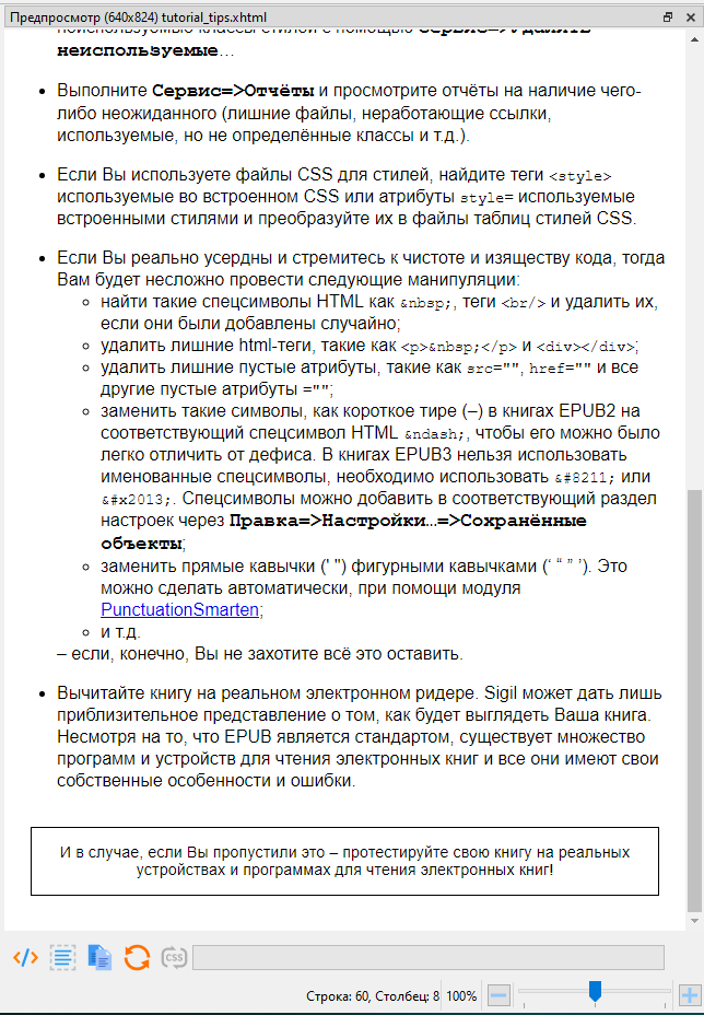

The meaning of this advice is not entirely clear:
"If you are really keen, search for and replace code like &nbsp;, <br />, empty paragraphs <p>&nbsp;</p>, empty <div></div> tags, empty attributes like src="" , href="", or ="", change – to &ndash;, change ' to ', etc. – unless of course you want to keep them."
from the "Tips" section of the User's Guide.
Explain please.

Many times early epub creators used nbsp in p tags and br to physically create whitespace to force a layout when using css is the more correct way to handle this. Things like space above, line spacing, and space below an image or paragraph are better set by using css so that screen readers for visually impaired people are not confused. The rule is "Keep Layout (css) and Content (text) separate".
That paragraph in the user guide is pointing out how you could use find and replace to "fix" these epubs that look like they came from the typewriter age of layout.

It basically says when you're done with the book, you should:
  • search for &nbsp; entities and delete them, if they were accidentally added
  • delete redundant html tags such as <p>&nbsp;</p> and <div></div>
  • delete redundant empty attributes such as src="", href="" and all other empty ="" attributes
  • replace characters such as an en dash (–) in epub2 books with the corresponding &ndash; HTML entity so that you can easily tell it apart from a hyphen*
  • replace straight quotes (' ") with curly quotes (‘ “ ” ’)**
*You can't use named entities in epub3 books (you'll need to use &#8211; or &#x2013;); entities to be preserved, need be added via Preferences > Preserve Entities
**Users can automatically replace them with DiapDealer's PunctuationSmarten Sigil plugin

Doitsu,
Many thanks.
So much clearer.
In my translation, most likely, I will replace the advice from the manual with your answer.
Excellent!
It was good, practical advice.

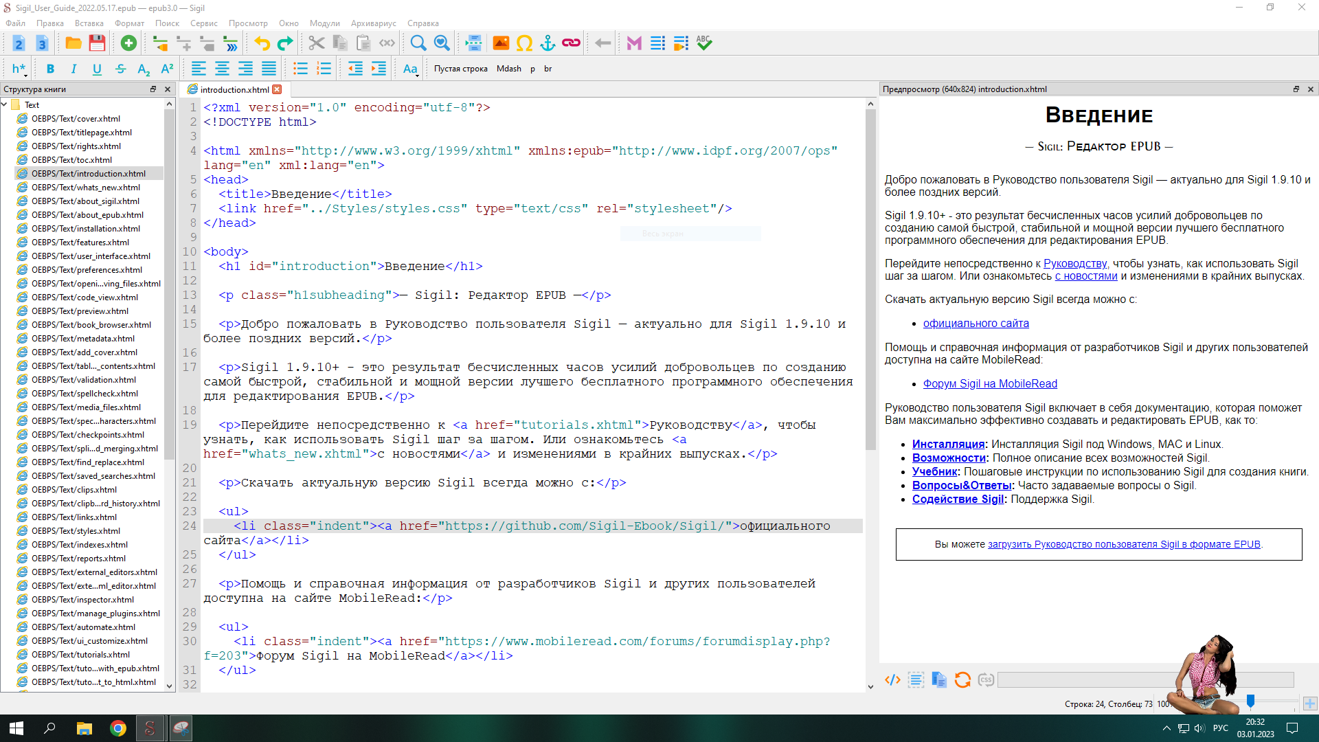

Regarding what has been said:
"...include proper names like Sigil, BookBrowser, Preview, CodeView, url, etc."
I agree that "CodeView" is a proper name and I try not to translate such appellation and names. But you yourself in the text of the manual use "CodeView" - 2 times and "Code View" - 104 times; "BookBrowser" - 1 time, "Book Browser" - 83 times. Even in the title of the program window you have "Book Browser".
Therefore, "Code View" and "Book Browser" are already other.
That said all of the user guide images would have to be redone to have the correct user interface language.
Of course. This is understandable without explanation.
Therefore, a complete translation of the Guide will take quite a lot of time and effort.
User_Z is offline   Reply With Quote
