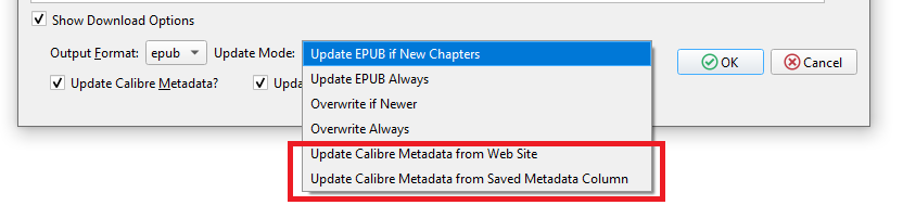

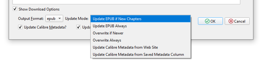

Would this be additionally to the six already existing “update modes” in “update existing list”?

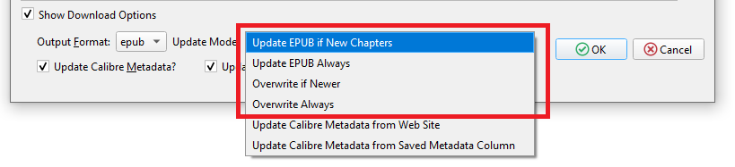

Or would you separate it in
“Update Existing FanFiction Books” with only the four following marked options in the sub-menu
and “Update Calibre Metadata for Existing FanFiction Books” with only the two remaining options?
ILB is offline   Reply With Quote

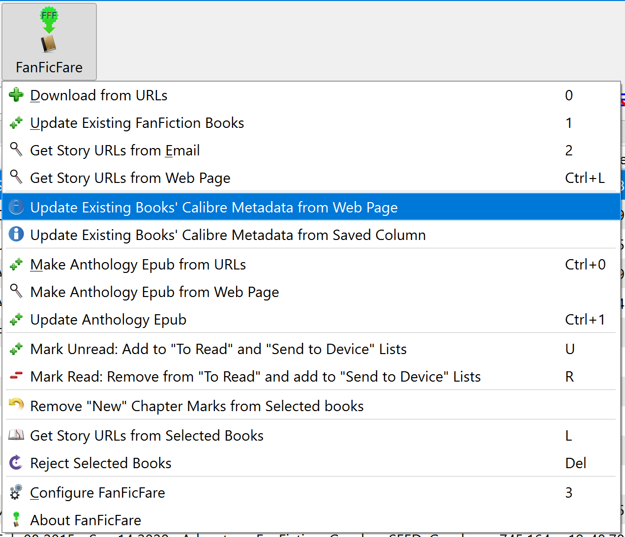

I'm thinking that the 'update modes' would be left as is for existing users who are used to them, but I could be persuaded otherwise.
I was planning new top level action(s) like so:
While I'm looking at it, I'm also considering making submenus there to declutter a little. I'm open to opinions since it would make virtually no difference to me--I use hotkeys for everything, as you can see.
