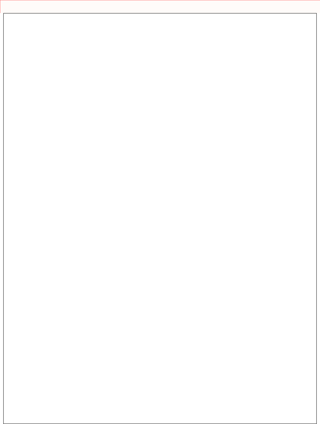

And, for reference, my actual setup, with @jcn363's footer-killing patch .
Dec 19 20:31:41 nickel: (    99.991 @ 0x553010 / ui.debug) draw widget:  46 QStackedWidget QRect(0,11 1080x1429)
Dec 19 20:31:41 nickel: (    99.991 @ 0x553010 / ui.debug) ===> parent widget:  AbstractMainWindow
Dec 19 20:31:41 nickel: (   100.036 @ 0x553010 / ui.debug) draw widget:  46 QFrame QRect(0,55 1080x1385)
Dec 19 20:31:41 nickel: (   100.036 @ 0x553010 / ui.debug) ===> parent widget:  ReadingView
(Which confirms the 44px we got back from the footer, compared to #72).
