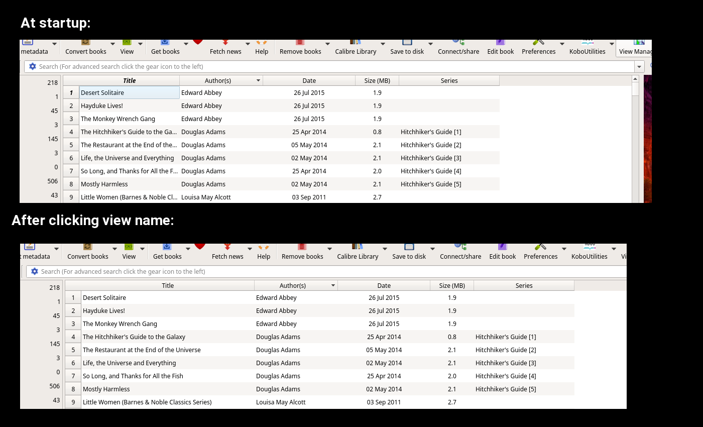

I'm using the current version of Calibre (3.14) and the View Manager plugin. I set up my new "default" view, and modified the sort, column widths, etc., then did "Save columns, widths and sorts". I set View manager to automatically apply the view at startup.
When I re-start calibre, the view is checked in ViewManager, but is only partially applied. I see my desired sorts and columns, but the column widths are wrong. If I click the view name in the ViewManager menu, THEN it's fully applied.
See the attached pic . . . .
How can I get this to (fully) apply at startup?
Thanks!
Dan

drawson1, I can reproduce your issue, but I'm not sure anything can be done about it.
VM is attempting to set the column order and sizes when the plugin's initialization_complete() is called. However, I don't think Calibre has finished setting up and displaying the library view yet and so the sizes are being ignored/replaced.
Personally, I set a keyboard shortcut for my most used view to 'spacebar'.

@JimmXinu: I dont think any library view layouting is done after initialization_complete (it is called at line 409 in gui2/ui.py which is close to the end of that method). You can insert a print there and also a print in the apply_state function in library/views.py which is where the column layout for the book list is restored, to check.

@kovidgoyal, I was just speculating as to the cause.
The same code in VM applies column size at start up (initialization_complete()) and library switch (library_changed() calls initialization_complete()). On library switch, the sizes are applied, on start up they are not. I don't see how anything the plugin does could change that.
