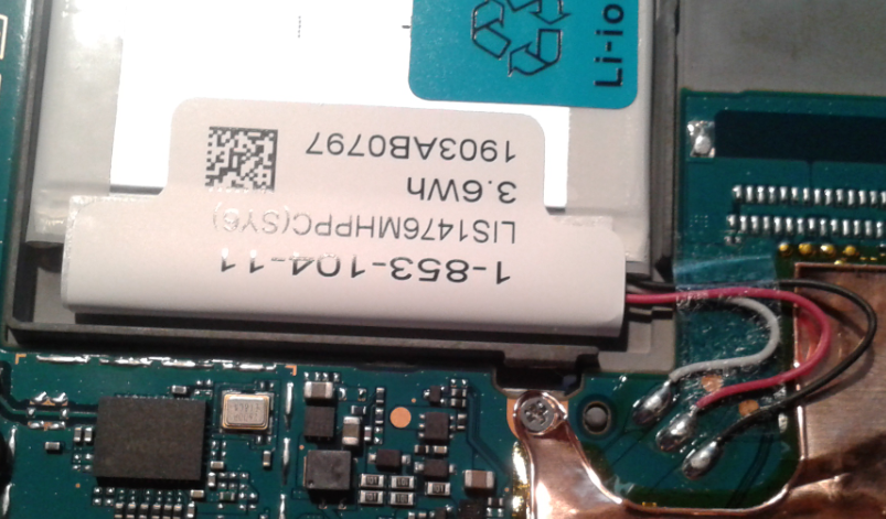

Well I'm really pleased to report that my reader is fixed and fully charged and working standalone without being plugged in.
I did replace the battery myself - it was fiddly and it took time to prise open the case and also to desolder and resolder the battery connections. However, the sense of achievement more than makes up for the effort expended!
The 2 PRS-T1s that I was watching on Ebay sold for silly money anyway. My £8 was well spent!

Soldering a circuit board is probably something I couldn't do, does it look like you could clip the wires and just solder the new battery to the old wires in that way?
DoctorM is offline   Reply With Quote
Old 06-29-2016, 03:00 AM   #15
colourqueen
colourqueen began at the beginning.
Posts: 12
Join Date: Jun 2016
Device: PRST1 & PW1
Haha I didn't think I could do it either - that's why I'm feeling smug and pleased!
Yes you could probably clip the wires and reattach a ney battery as there is enough lengh on them. The lid of the reader fits very snugly where the battery is so you need to make sure the battery is properly seated and there is nothing proud ot the battery - so the wires need to be tucked down.
I've attached an image of what the connection looks like.
