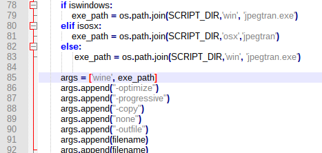

2. Change lines 83 and 85 in plugin.py as follows:
old version:
            exe_path = 'jpegtran'
        args = [exe_path]
new version:
            exe_path = os.path.join(SCRIPT_DIR,'win', 'jpegtran.exe')
        args = ['wine', exe_path]
Make sure not to mess with the indentation otherwise Python will display some cryptic error messages.

This is to report success.
The images went from
146 to 127k
334 to 244k
863 to 812k
