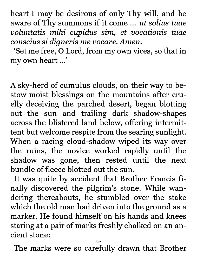

Problem 2. For some fonts, characters with a large side-bearing value (such as Georgia italic f, J, etc.) get cut off if they appear at the end of a line. This problem can also affect kepubs in normal reading mode if the margin adjustment slider is set at minimum.
For sideloaded kepubs created by recent versions of Calibre's KoboTouchExtended driver, this problem can be fixed without patching by adding div#book-columns { padding: 0.2em !important; } to the book's stylesheet.
For most kepubs synced from Kobo or created with older versions of the KoboTouchExtended driver, the `Fix kepub side bearing font cut-off bug` patch can be used to add the appropriate padding to the device's built-in stylesheet instead. (Some changes to the default patch settings will be necessary for use with books in vertical languages such as Japanese, or ones created with old versions of the KoboTouchExtended driver.)
The following screenshots (Glo, 3.16.0) show a kepub book synced from Kobo in full-screen reading mode with a large font size to demonstrate the cut-off effect. Look at the letter f at the left of the fourth line from the bottom and at the right of the line above that to see the problem.
1. Unpatched
2. Patched
ID:	139270Click image for larger version

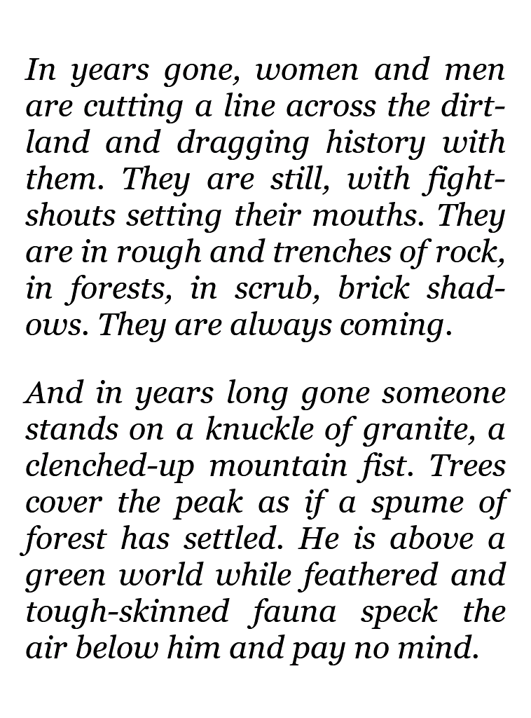

Problem 3. Images which are supposed to be displayed inline (flowing with the text) are instead displayed centred on a seperate line.
This problem is can be fixed by applying the `Disable KePub FullSceenReading block img style` patch.
These screenshots (Glo, 3.18.0) show a page from this book which uses small bitmaps to represent some Hebrew letters. Note the second-to-last line of the page:
1. Unpatched
2. Patched
ID:	144181 Click image for larger version

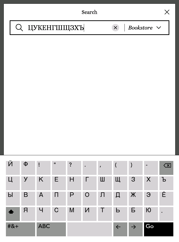

Custom keyboard patches
The keyboard in the unpatched firmware has a keypad of extended Latin letters that is accessed by tapping the ÉÀÇ key:
ID:	139272Click image for larger version
ID:	139273Click image for larger version
It is possible to change the extended Latin letters to other letters with a custom keyboard patch. There are patches for Cyrillic, Arabic, Hebrew, and Turkish, or you can make up your own keypad just by replacing the letters in one of these patches:
Cyrillic (lower and upper case) and Arabic:
ID:	139276Click image for larger version
ID:	139277Click image for larger version
Note that the glyphs for Arabic and Hebrew are not available when the device first boots, so the keyboard will just show blank squares until the first time the Aa menu inside a book is opened.
The screenshots above are from my Glo (fw 3.16.0), the keyboards on other devices are a little different.
