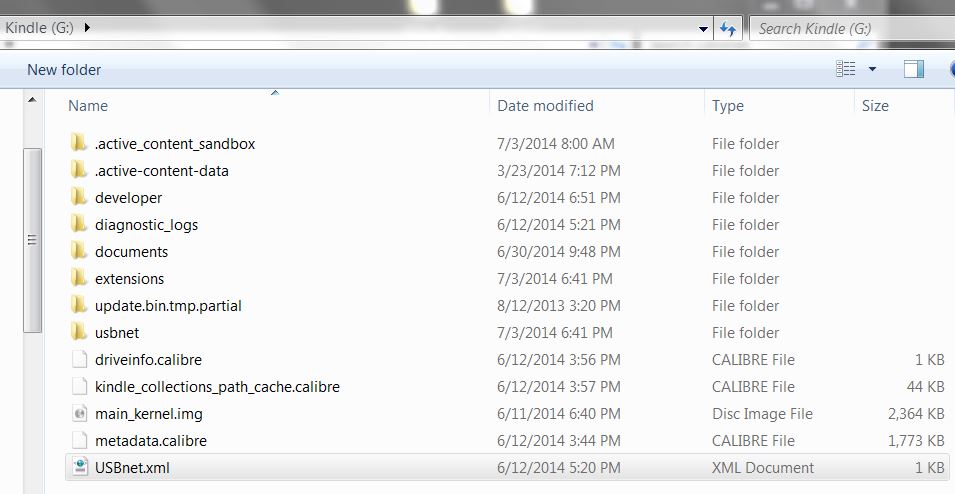

I also installed the anti-update fix, see attchment. I was confused by the expression userstore, I presume it just meant in the G:\ root? - I want to get this one right!
Yup:
Create this folder in the Kindle userstore (assuming the userstore is Drive "G:\")
Userstore is Kindle Drive.
